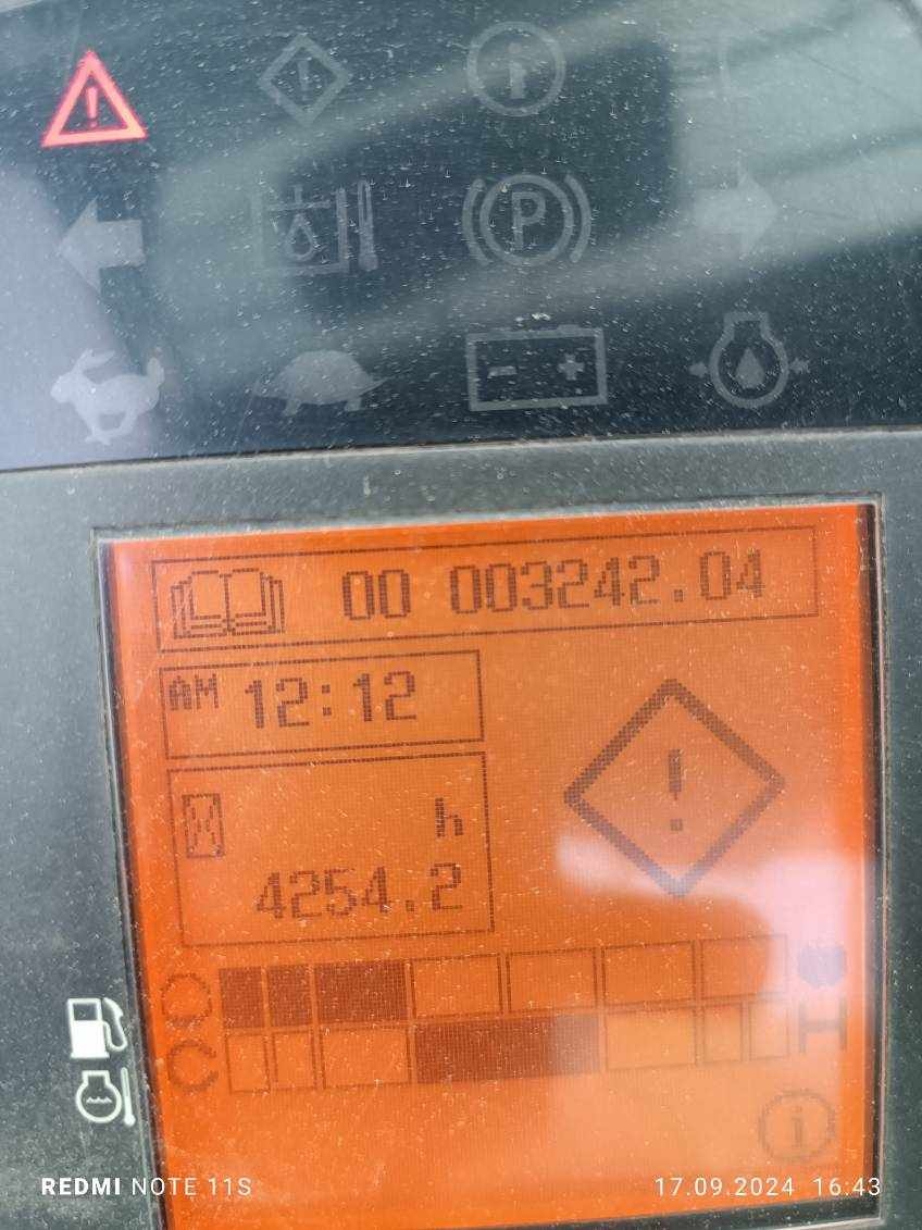

Hi, while using excavator Yanmar ViO80-1A from time to time im getting error code 00 003242.04 on the screen, i have tried searching it in manual but can't find this exact error code, anyone have any clue?

003242.04 - DPF Inlet Temperature Sensor Fault (Low Voltage)
