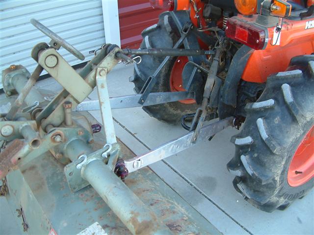

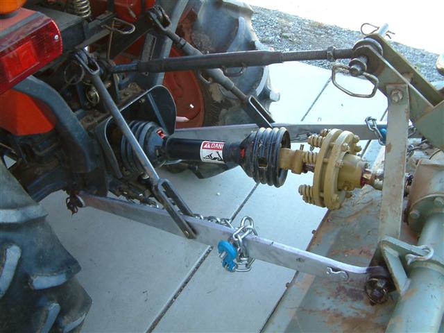

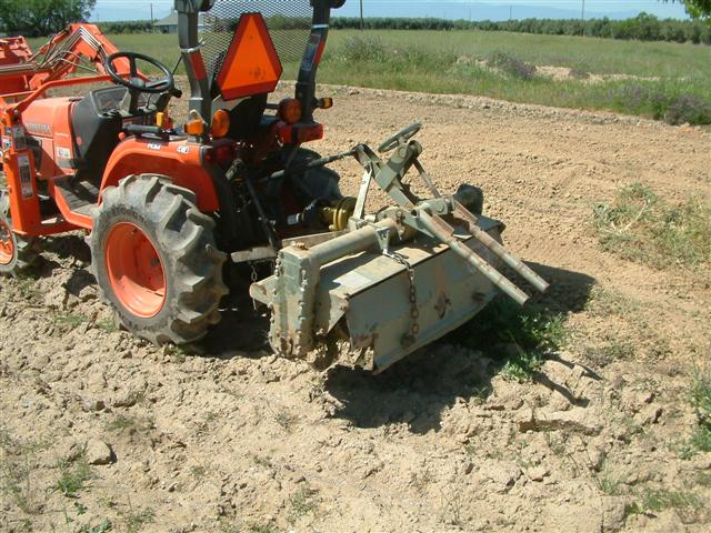

Got mine for $300 back in 2006 to use on my 2005 Kubota B7510HST. It was a struggle to get the tiller interfaced with the 7510.
Had to remove the 26" long lower lift arms on the 3pt hitch and replace them with 35" long arms from my Massey Ferguson 135. Since there's no shear pin on my RS1200, I added a slip clutch. To get the slip clutch installed, I had to use an adapter on the tiller pto shaft to move the clutch away from the tiller's sheet metal (rubbing problem). Finally, since the pto shaft that came with the tiller was crap, I had to get a new pto drive shaft from TSC and cut it to fit.
Good luck.

flusher -- You got a good price for the tiller, but it obviously turned into a project for you to get it working with your tractor. What was the reason for needing to use the longer lower lift arms, just accomodating the length needed for the slip clutch etc?
