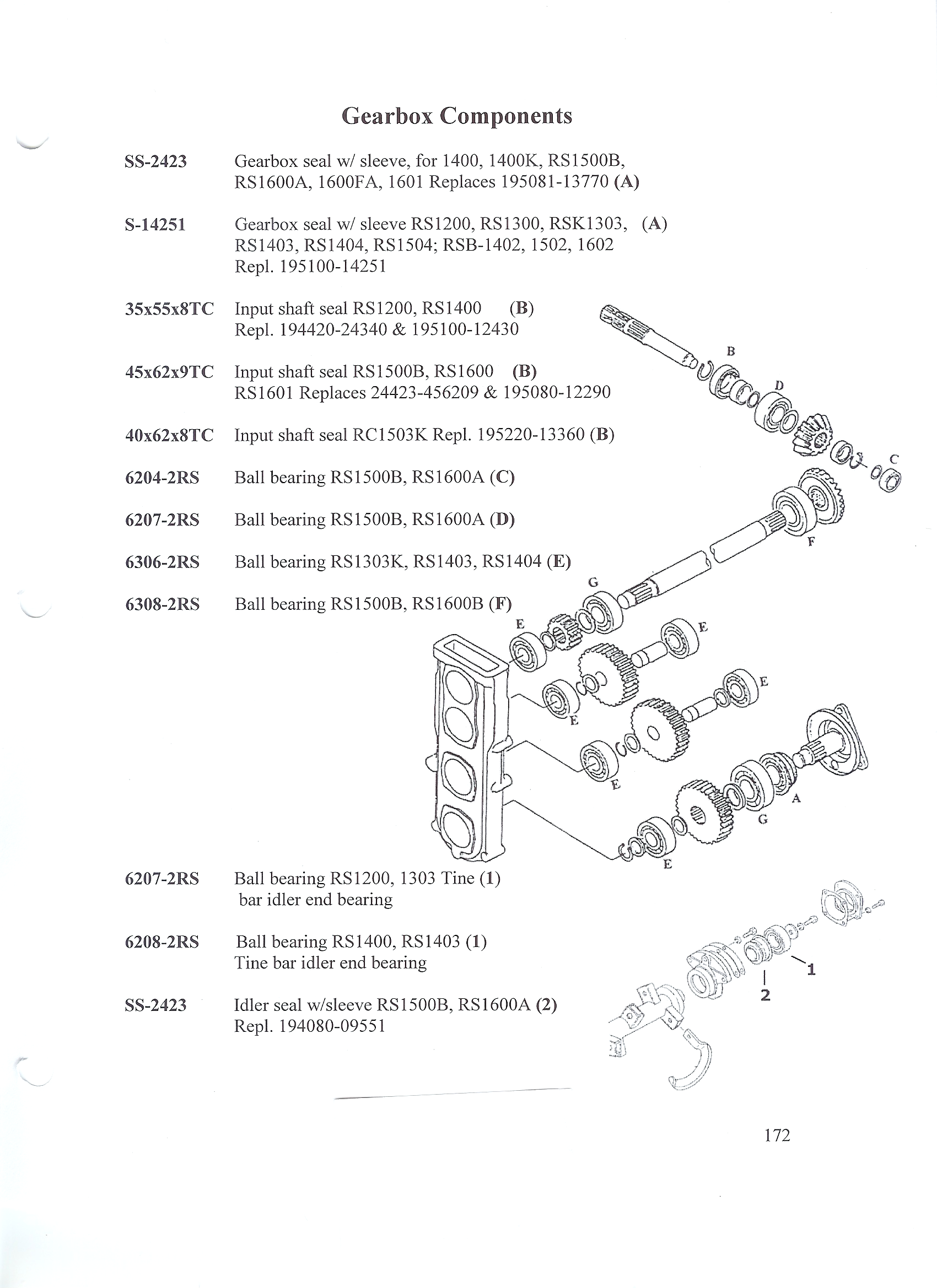

Hi i have a rs1200 tiller an the seal in the front is leaking i took it out of the tiller it has a ring on it to keep i togather we have not found a way to get it loose we used a lot o pressure an it did not move at all to get the ring out anyone know how to get it appart Thanks Earl44

Here's a parts Dia. Fredricks has on their web site. They may have the seal but any hard parts may be doubtful.

I am slow to understand. Are you talking about the input shaft seal 35x55x8tc? 35x55x8tc | eBay
If so, you may have to start taking everything off starting at the rear of the shaft.
