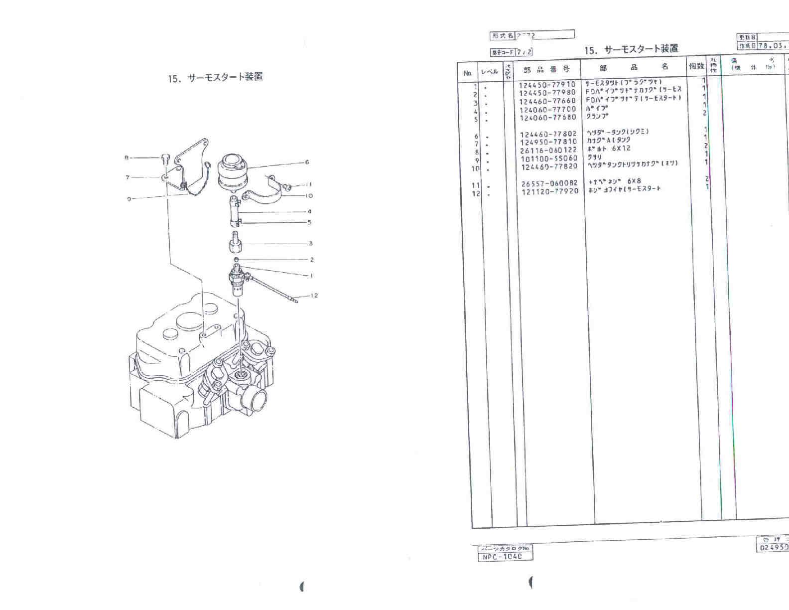

<A target="_blank" HREF=http://www.tractorbynet.com/forumfiles/49-223692-JD790AirintakeheaterMP29616________UN20AUG02.gif>Here's a picture of the thermostart system used on a JD790... so this would be Yanmar's current system...</A>
KEY PART NO. PART NAME QTY SERIAL NO. REMARKS
1 TY22472 CLAMP 2
2 HOSE 1
3 M803867 SCREW, WITH WASHER 2
4 M804346 HOSE GUARD 1
5 AM880590 HOSE 1
6 CH16778 THREADED NIPPLE 1
7 AIR CLEANER 1
8 RG25644 FILTER ELEMENT 1
9 RG60690 FILTER ELEMENT 1
10 M809535 COVER 1
11 RG60692 DRAIN VALVE 1
12 AM880591 AIR CLEANER 1
13 AT118553 AIR RESTRICTION INDICATOR 1
14 M805975 EXTENSION 1
15 19M7867 BOLT 9 M8 X 25
16 M802664 GASKET 1
17 CH19780 BOLT 1 M8 X 14
18 M810587 MUFFLER 1
19 14M7298 FLANGE NUT 1 M8
20 M802662 GASKET 1
21 M808645 STUD 1 M8 X 22
22 M808644 GASKET 1
23 CH12294 PIN 1
24 CH19092 BOLT 1 M8 X 105
25 M802596 STUD 2 M8 X 40
26 M89128 BOLT 4 M8 X 40
27 M810586 EXHAUST MANIFOLD 1
28 M808666 GASKET 1
29 M808640 INTAKE MANIFOLD 1
30 M805836 GASKET 1
31 M801118 HEATER 1
32 19M7897 BOLT 4 M8 X 35

The intake manifold looks a bit different than I remember on my YM1301D, but it might be the same. I wonder what that one for the 790 would cost.

I don't have a kit price, but the heater alone is:
Part Details
Part Number:
M801118
Part Price: 52.83 USD
Description: HEATER
