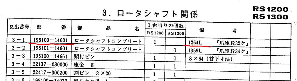

In the RS1200/RS1300 section, go to page 9. Look at item-1.
This is the parts list to the right.
1264L = 1264mm Long.
1264 / 25.4 = 49.763 inches. You measured 48 inside. That item-1 shaft goes to the outside chain case too.
Deduction, you have an RS1200 tiller. :)
The RS1300 is 1359L (1359mm Long.)
1359 / 25.4 = 53.50 inches. Thus it's a 52 inch tiller.
Glad the mystery is solved. Now it's up to you to work towards the restoration. Keep posting to this thread as you make progress. It will keep us intrigued and help others in the near future with an RS1xxx series tiller.

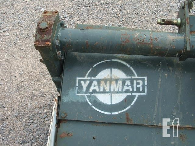

I'm still amazed at the big round Yanmar logo on the machine; Wonder how it became to be on the tiller.

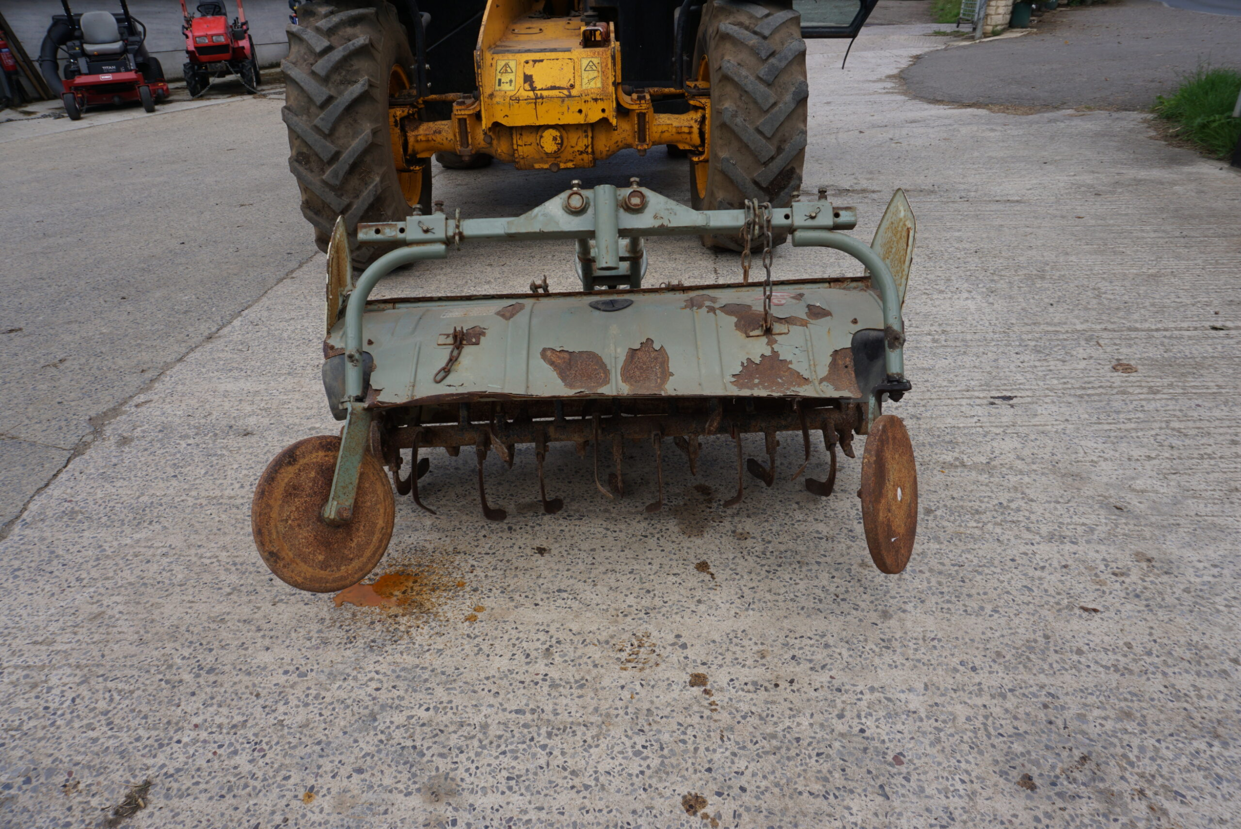

If you are talented, you could fab something up like the original to use as a hiller off the back of the tiller. This way, 1-pass to do 2 jobs. And with the price of fuel, that is a SAVINGS right there. :)
Here is an RS1303. Notice the hiller or training wheels. IF one swaps the right and left wheels via the positional brackets, then the hiller function can work.
Additionally, I came across another tiller with the round Yanmar logo. It seems this is a masked template and using a white rattle can the logo is made.
It would be neat to find out who the re-seller of these marked tiller were once they got here.

The link down to the wheel axle, like half a bicycle fork, should be on the outside of the wheel for the wheel to roll straight.
Or, set up like in the photo with the link on the inner side, the wheels will crab to maximum and have some hiller effect. Or at least, cut gouges.
1654621591496-png.749285
Here's where I learned this. I then swapped wheel assemblies left/right, no more gouges.
