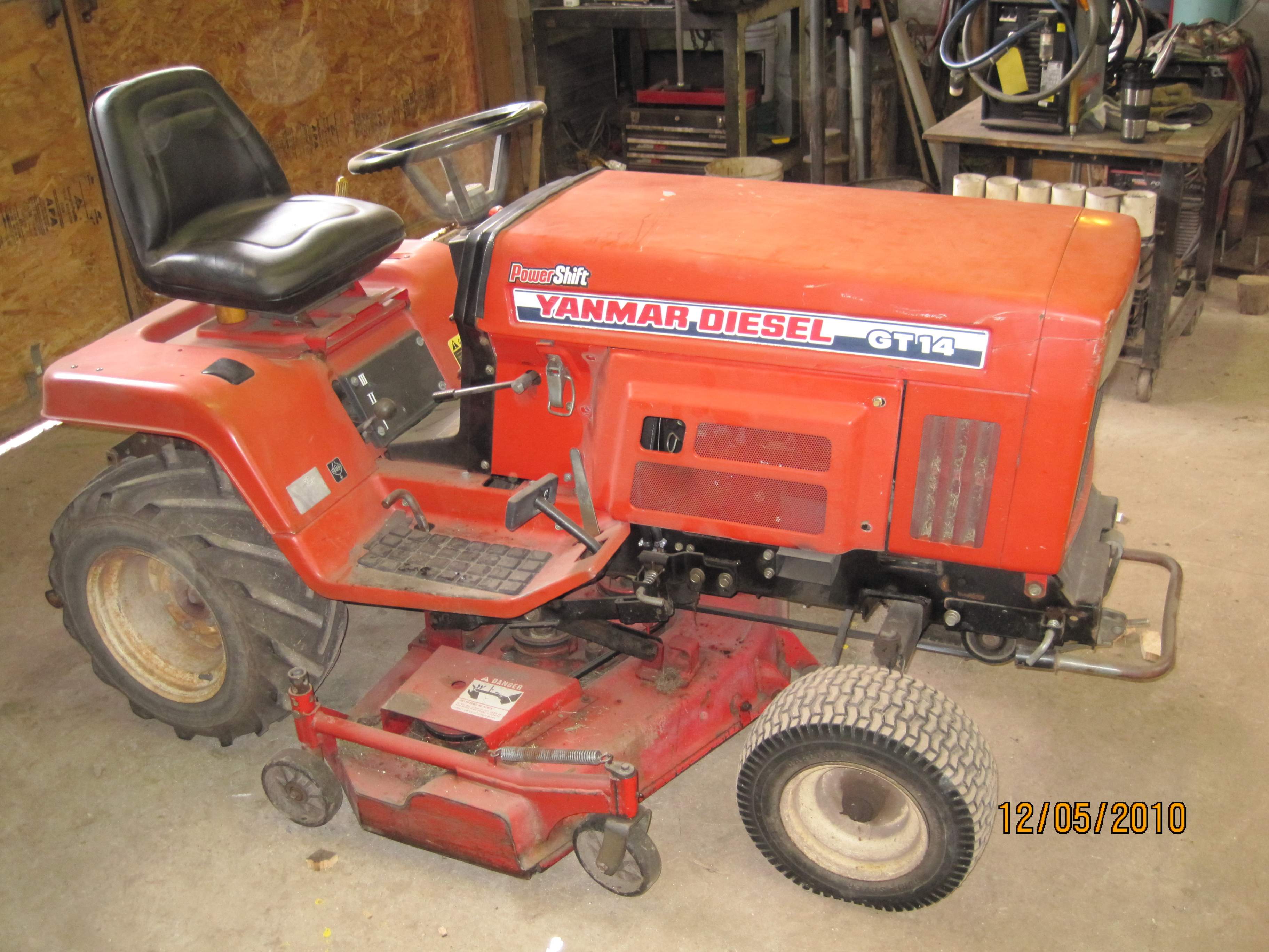

Is the GT and 146 the same mower?? Do the parts interchange??? Asking just in case I find a donor along the way......

the YM146,YM14 and GT14 are the same, the YM142 i also think is still a 2cylinder whereas the YM122 and 126 are 1 cylinders. the frames and sheet work are all the same.even all the holes are in all the panels to suit all models and country codes. i have a YM14 which is the same minus the hydraulics(dunno why they decided that,but anyway) if you need info on something i have the complete manuals including the 1cyl models.
/ Yanmar ym146 #26
Correct. All the same, but Ive never seen a 142. I know they made them, just never saw one.

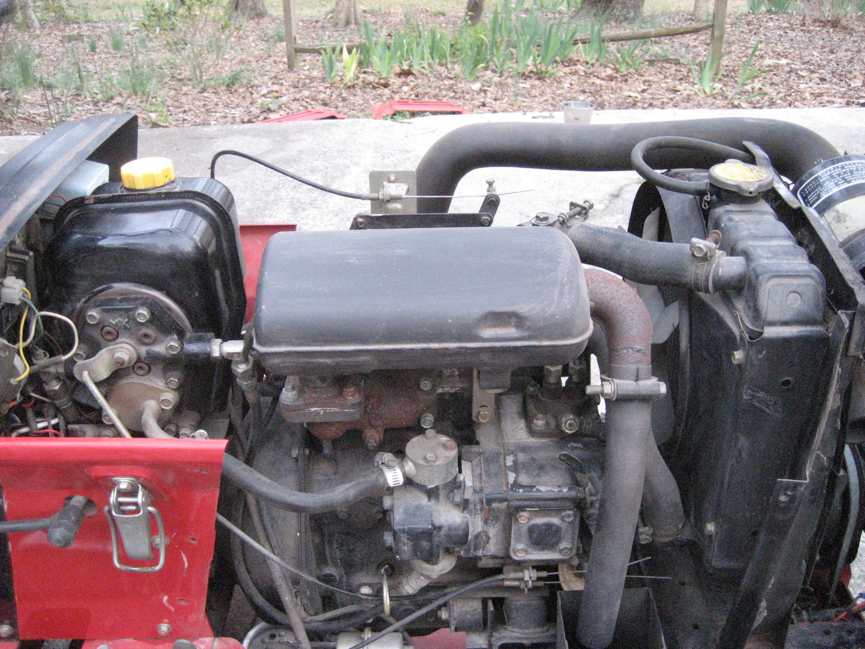

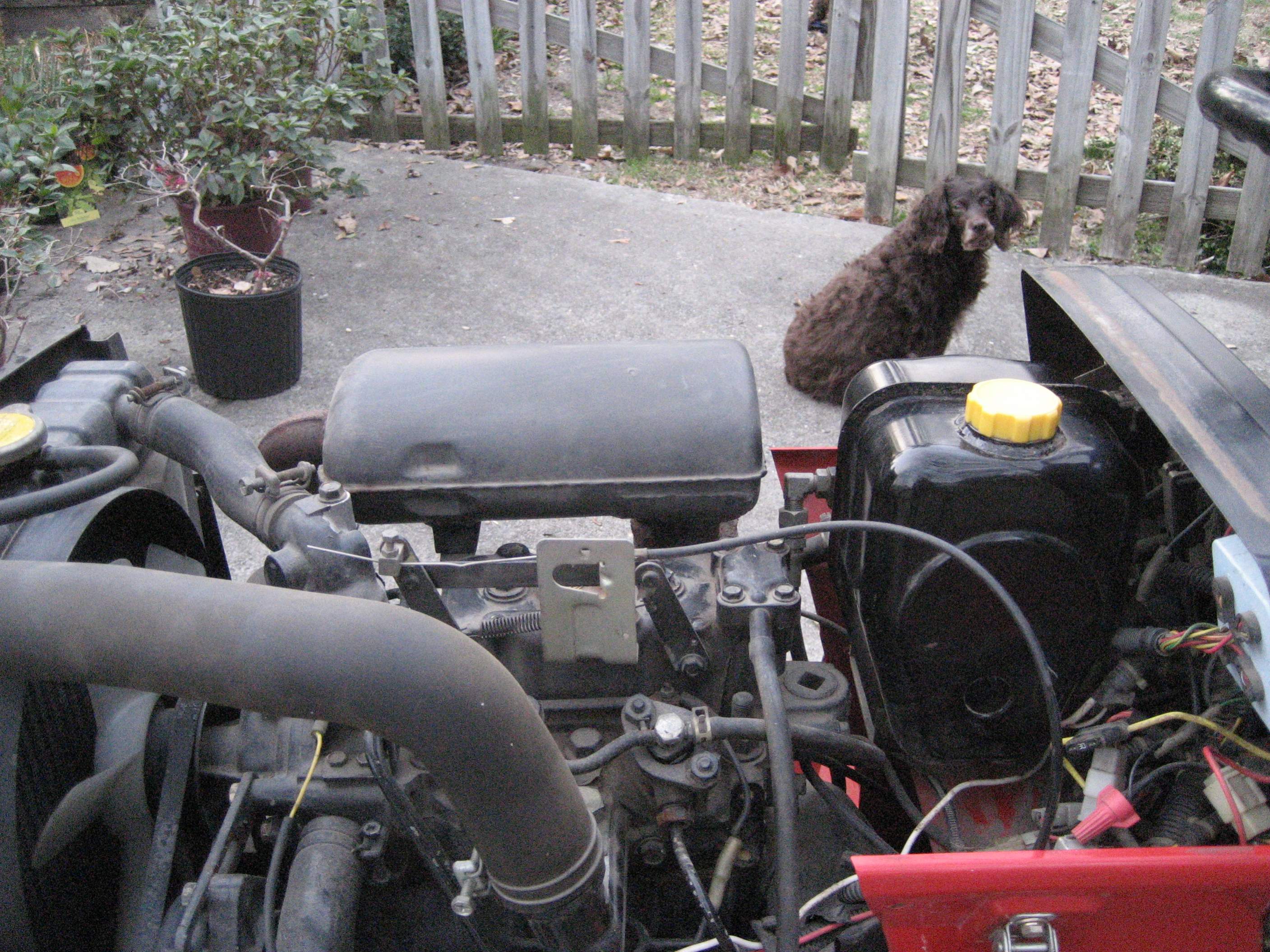

Well got the head off and took it to the machine shop....head looks good so no worry there.
I have the radiator at the shop to test and clean......
Took a few pictures of the cylinder and top of engine.....look like 280 hours??
That is supposed to be the hours on the motor.
1- saw alot of stuff on the water pump fan....hard as a rock....turns fine just has this build up....this normal?? I think it sat up for a year before I bought it.
2- Valve cover almost looks like it was not a solid piece but may out of a tube??this normal??
Thanks for any input....bought a parts manual today so will have a better idea of what goes where....

Pistons sure don't have alot of carbon on them, that's for sure..
My guess with the water pump is they probably used tap water instead of the proper stuff. Mineral deposits probably.
I'd have to look at my GT14 valve cover, it's off the engine.
/ Yanmar ym146
#38
Just looked at what I wrote on the valve cover notes..just to make myself clear ....I meant the gasket on the bottom looks more like it was made with a something out of a tube rather than a solid gasket..I can see some run off in side the value cover.......there were lips/edges on the outside.......I was scared to try and pull it off...but it maybe a solid gasket...just hard to tell....
/ Yanmar ym146 #39
Well, once you get the new gasket in, you can let us all know. ;)
