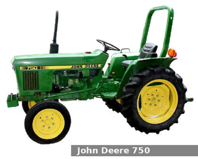

Looking for a good 3T80U-NA good engine block. any avenues in trying to locate a good one would be much appreciated.
Thanks in advance.

The 3T80U as a base engine came in several variants. It's possible some of the other variants would work as well.
Have you looked for a complete engine?
   / Yanmar YM2002D #3
Other possible engines to work would be,
The Yanmar YM1820 has the 3T80U-NB and the YM2002 has the 3T80U-NA, YMG2000 has the 3T80U-SA.
No domestic Yanmar was sold with a 3T80U engine. The U designation means, the engine has no cylinder sleeves.
Yanmar made the JD750 for Deere. It has the 3T80UJ engine. It's possible to match it to your engine.
You could just buy a complete engine of the 3T80UJ and put it in your machine.
Shop around.
Here i one example,
Another with a B+ rating

are the engines compatible? would I be able to bolt this ym2010 engine up to my ym2002 ?
   / Yanmar YM2002D #8
I think it does 2002D 82-83 2010 80-81 So not much doubt it should!
   / Yanmar YM2002D #9
Looking at the piston size
YM2010 EP-9369 (82mm)
YM2002 EP-1567(80mm)
pretty much assures me of that!
