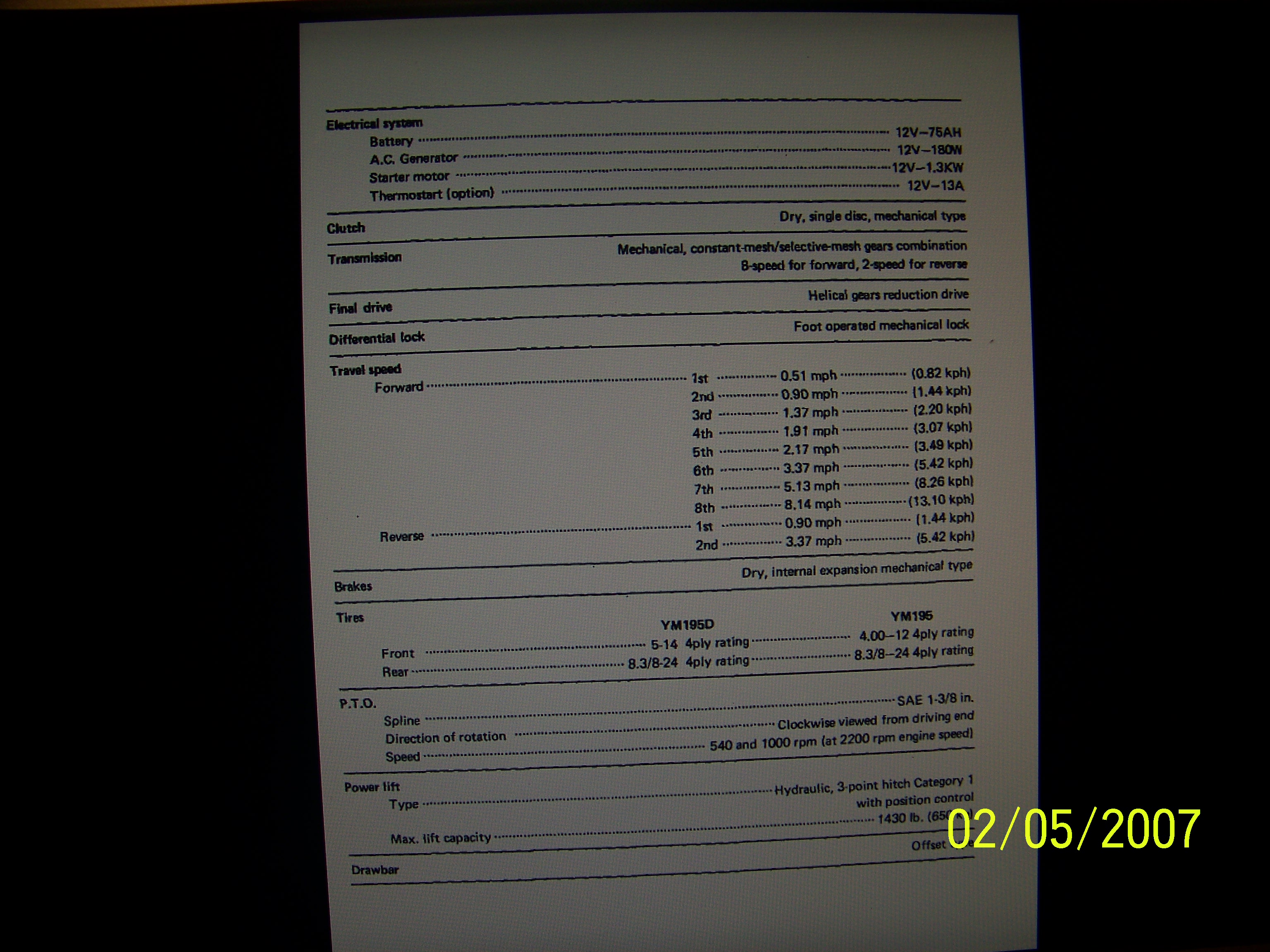

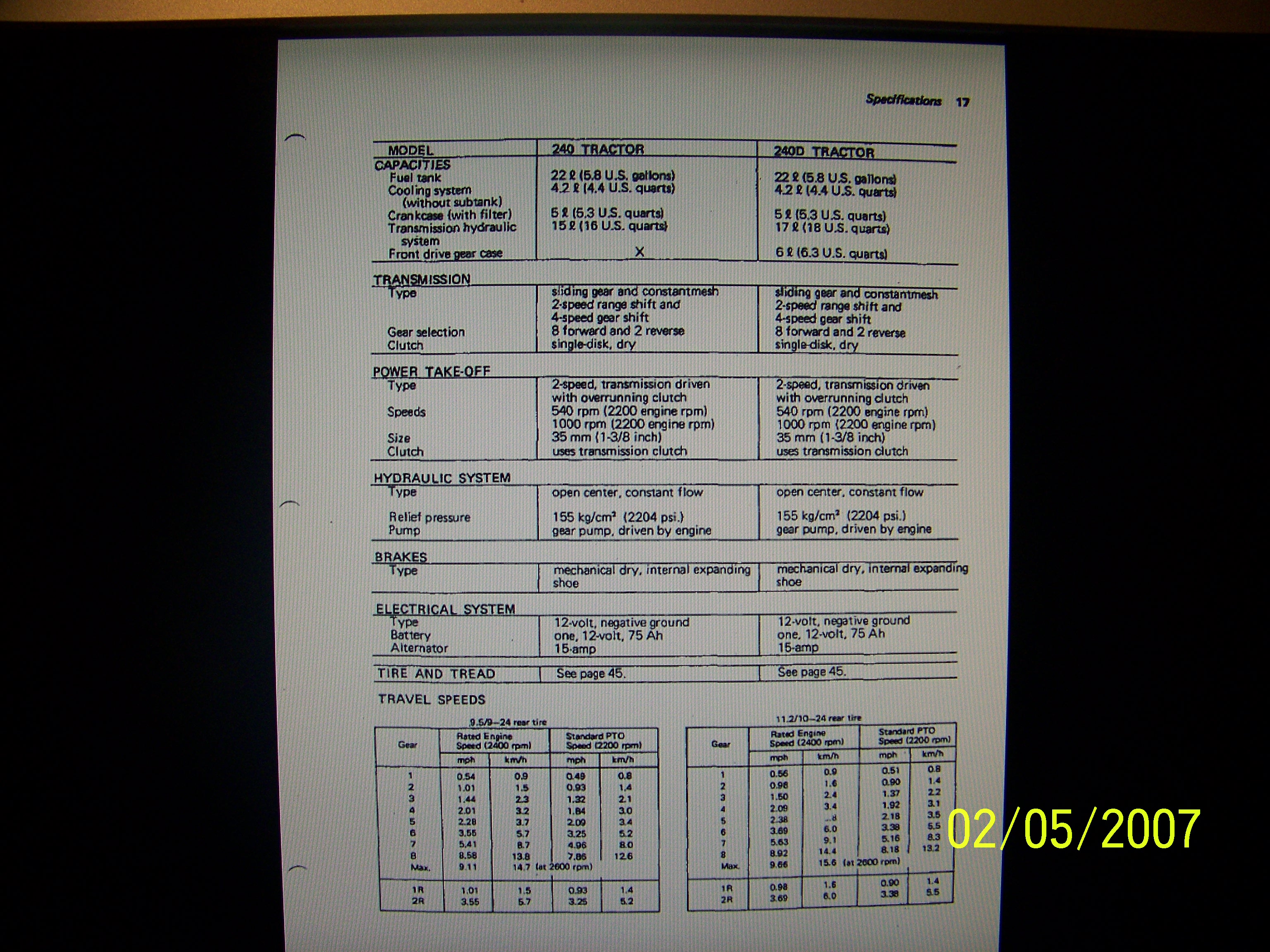

Not only have we felt that the ym240 service manual says this. It gives ground speeds in each gear . If you want I can post a picture of the page.
   / Yanmar YM2220D question to tire and lift capacity #22
Thanks. I have that manual, haven't looked at it in too long.
   / Yanmar YM2220D question to tire and lift capacity #23
From the 240 parts manual:
2nd from the 195/240 operators manual:
I have pretty much accepted the Yanmar manuals have numerous errors.

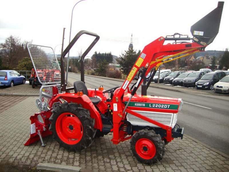

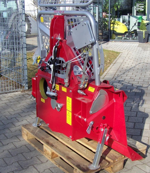

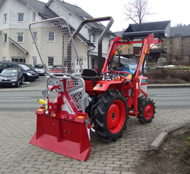

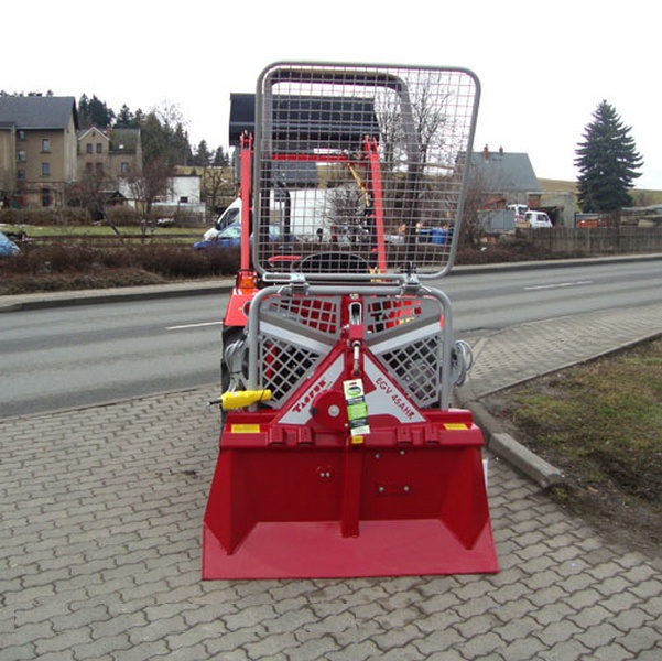

The rear capacity would then be between 1433 lbs (650 kg) and 1653 lbs (750 kg) and the cable winch weighs 800 lbs (363 kg), so it should be possible to lift and pulling with it. What do guys you think, feasible or not?
Here are some pictures of a Kobuta L2202dt with Tajfun 45A winch, the tractor has the same performance but 220 lbs (100 kg) lighter than the Yanmar ..
I don't think you need larger tires to carry more weight, if that is your concern. And each larger width of tire has proportionally larger diameter. An online tire chart will have the specific numbers. As noted above it is important that the ratio of front to rear tire diameter is kept the same. Larger rear tires but the same front tires would stress the driveline excessively.
It is 'common knowledge' that a 3-point backhoe can tear the back of the transmission off, so 3-point backhoes are never recommended. I think driving all over the woods with an 800lb winch can stress the tractor in a similar manner. I say this because my 750 lb backhoe squeals the hydraulic relief valve if I drive over uneven ground in my orchard, a clue that I am carrying the maximum weight the tractor was designed for, and going longer distances in a logging environment could be at or beyond what the tractor was designed to withstand.
That Kubota looks much smaller than the size of tractor used with a logging winch.
