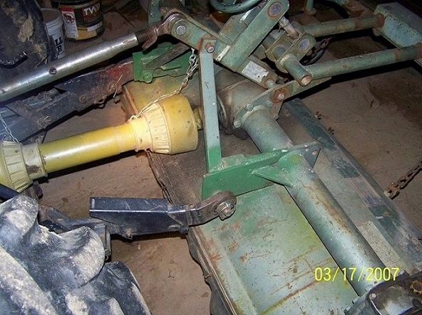

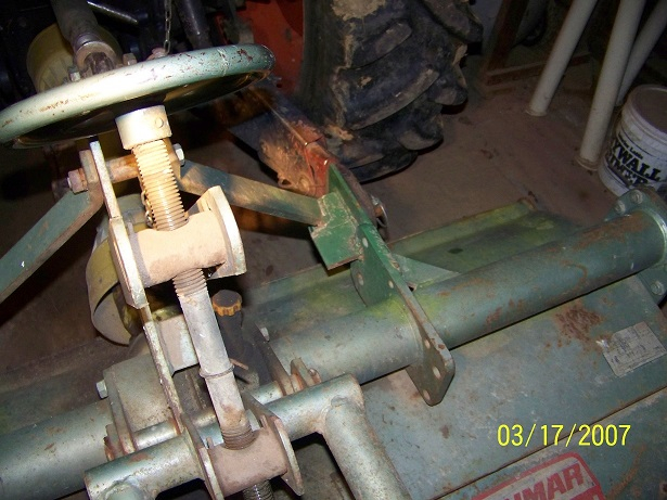

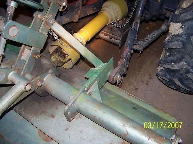

This topic appears here occasionally. You need to buy or replicate Yanmar's special top link assembly. Or modify like Winston did if you want to make it standard 3-point. Likely with a longer top link and driveshaft.
Here are some photos I've posted in the past showing Yanmar's special 'bridge' (my name) bolted to the tractor's 3-point mount point. And the special short top link, that makes the tiller lift without curling into the tires.
First, an excellent picture of someone else's tiller showing the top link details.
814358-tiller3-rs1400-jpg.115011
... and now, mine. I took this photo to show the driveline was too short. Probably because longer 3-point arms were put on my YM240 after oversize rear tires were mounted.
The VN import house where I bought the tiller gave me a PTO extender free when I showed them this photo. They were great folks! Now everything works as intended.
p-1-1060300rtillerlinkage-jpg.115012
The setup decal on my RS1400 tiller showing it was specifically intended for YM2000. (My YM240 is the US twin to YM2000).
p1060269rrs1400ym2000setupdecal-jpg.222363
And my RS1400 / YM240 set up to mach that decal. Note in the decal, and on my rig, the gear case is sloped away from the tractor with the tires and tines at the same level.

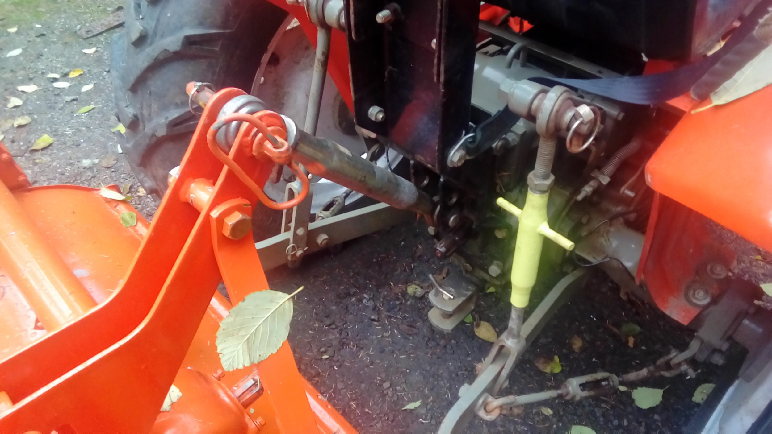

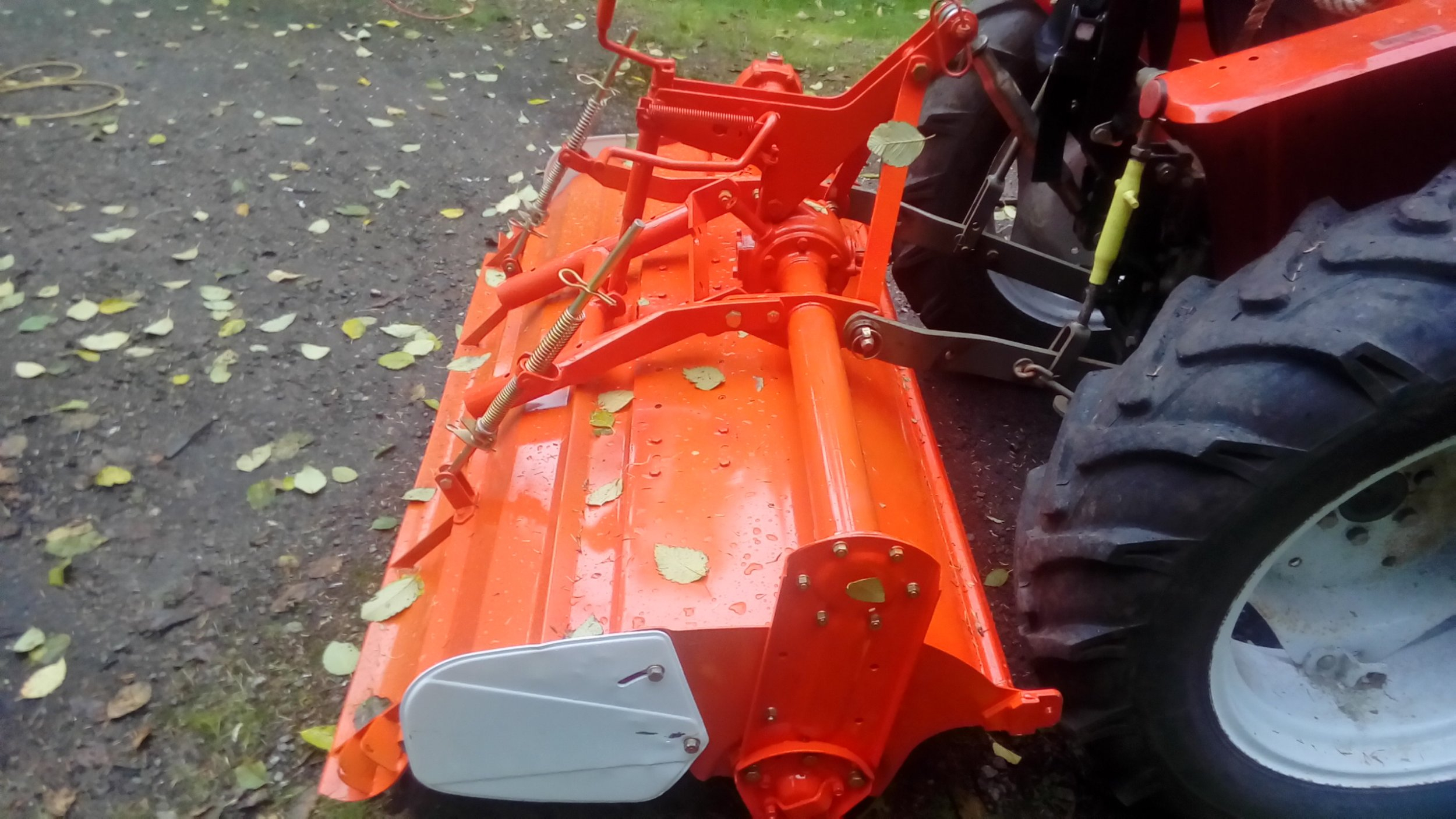

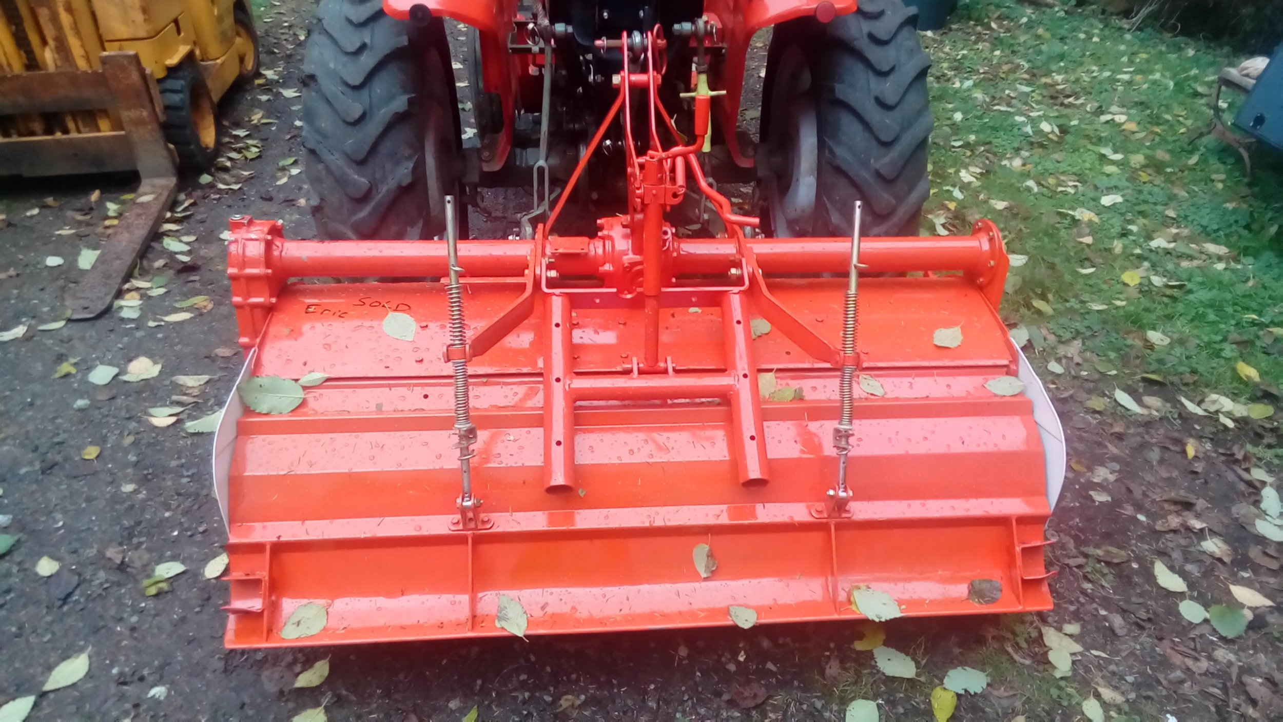

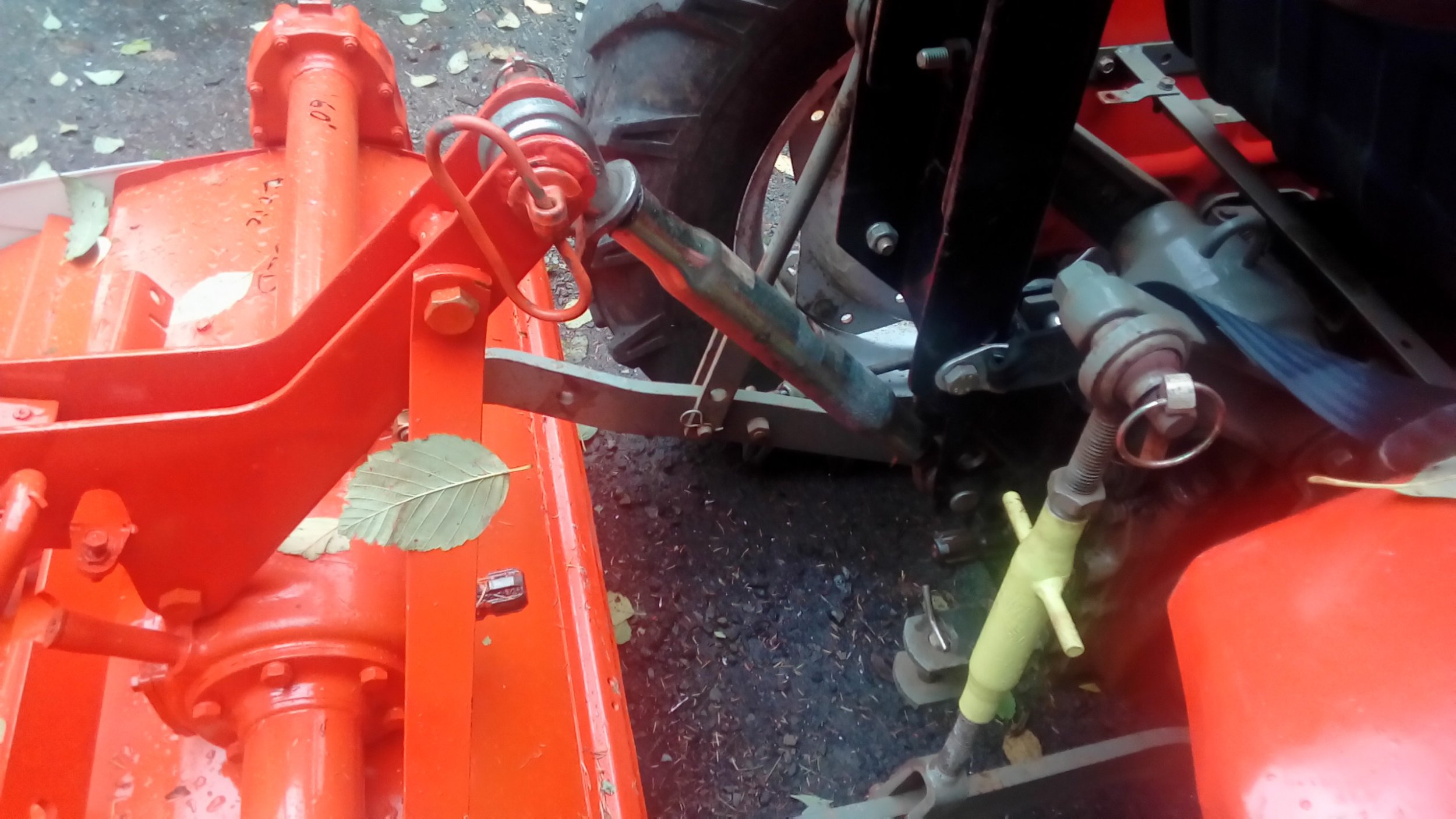

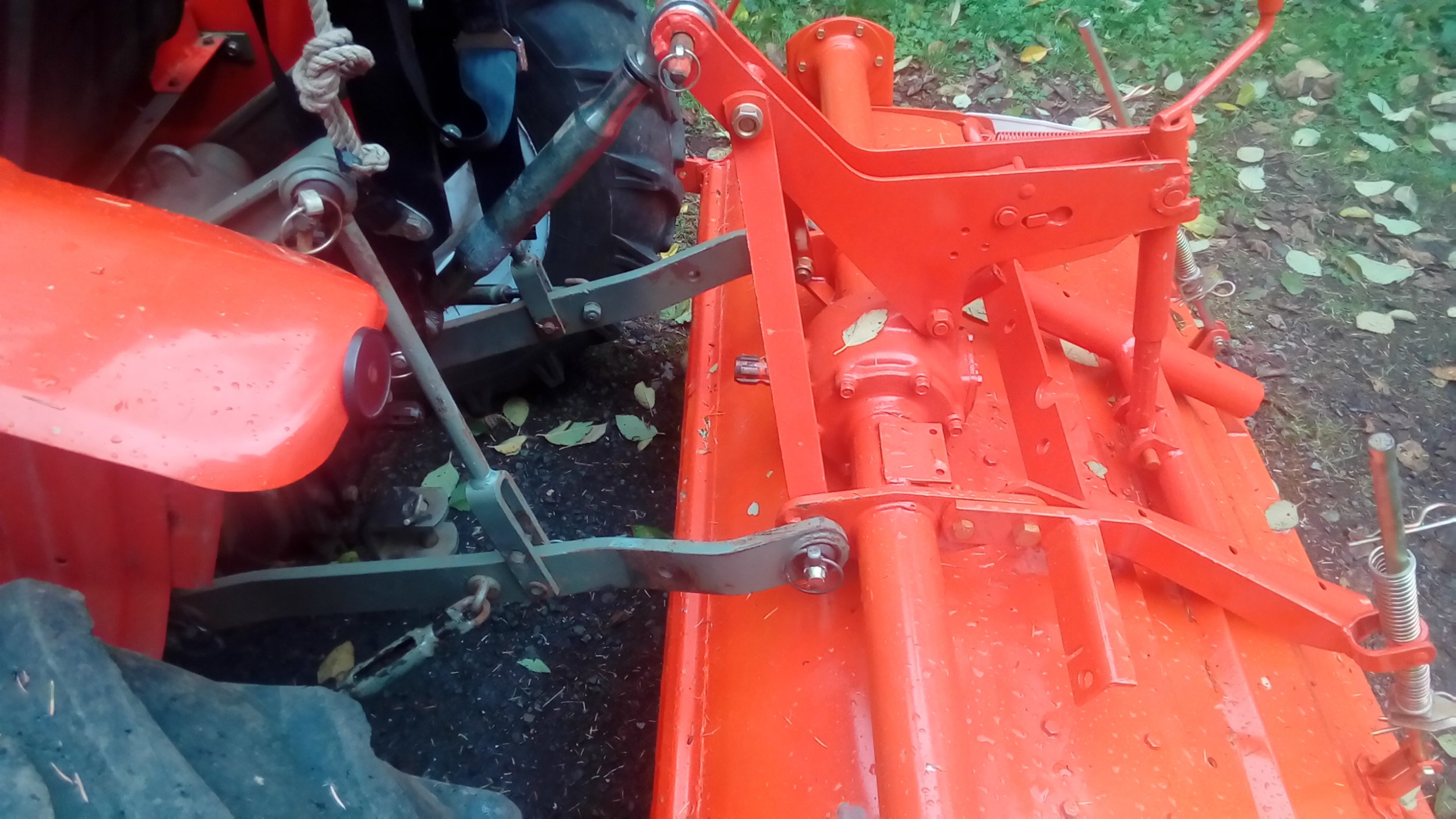

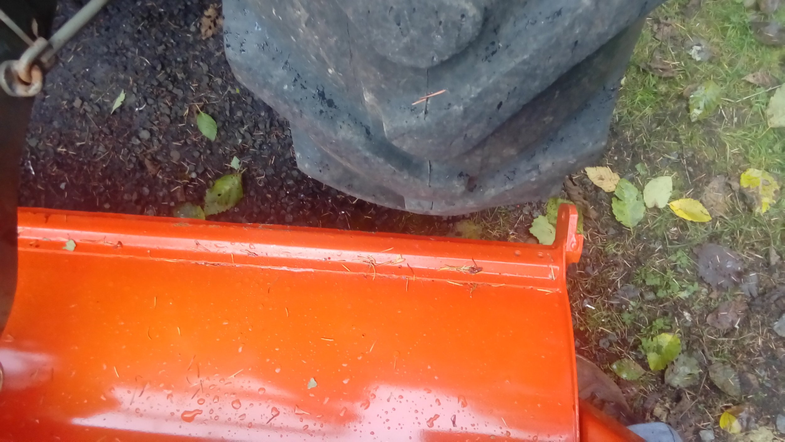

Lotsa good replies here and lots to think about. I could fab up the triangular piece but I decided to instead make up a couple extensions so that the tiller moves back and so that I can use the provided drive shaft without cutting it any shorter. Today the rain and wind lessened enough that I was able to finally take some pictures. I hope they help with identifying this particular model. When I am done with the extensions the tiller will be moved about 5 inches back. If anyone thinks this is a bad idea please chime in. This tiller mod needs to be done soon so that I can get the drainfield tilled and seeded before the winter weather gets too cold.

Five inches sounds like a lot. 'Measure twice cut once'.
And you might want to swap those rear tires side to side to improve forward traction.
That's a nice looking tiller. I can see how they are getting top dollar for them.
   / Yanmar YM2310 tiller problems #11
Nice. I created a folder on my system to start comparing. Yes, the tiller is missing some things. Were you able to see any hints of the old paint or primer on the tiller anywhere? And the side shields are white eh? Were they originally white to begin with? That would really help with knowing the side shield color. ;)

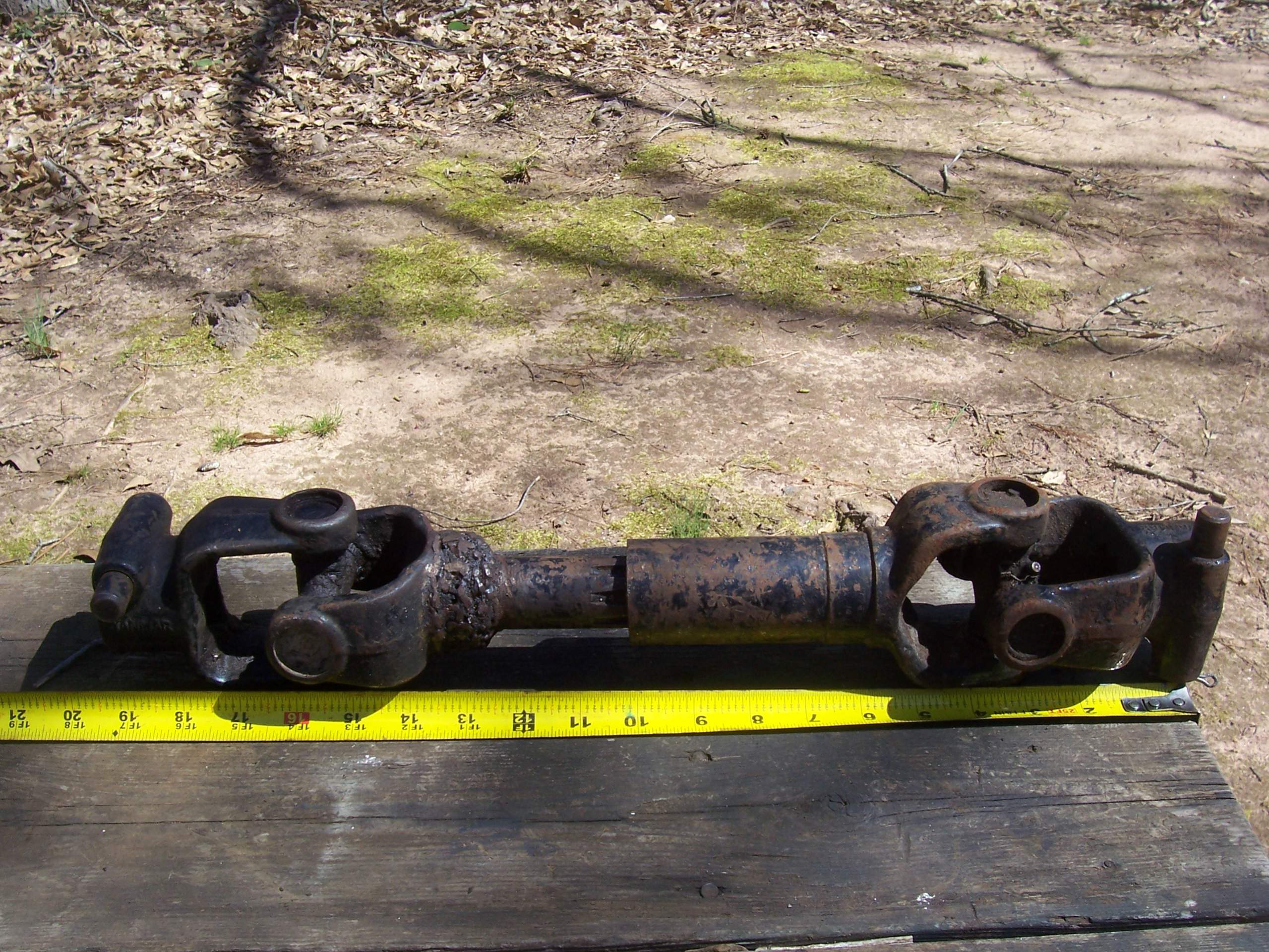

BTDT and shortened the shaft. Wasn't much to it. 3 cuts. 1 cut on the open side. Took about 2-3" off and that made a coupling. 6-8" off the shaft side. Used the coupling to attach the shaft side back together. Didn't take long or anything special. El-cheapo HF. stick welder and a hand grinder I changed to a cutting blade. Maybe 10$ in cost. Being further away from the Tractor made a big diffence to the way Yanmar set it up. Length Vibration cutting Depth Etc.. They have a good Idea how to set them up. They've done a couple over the Yrs.. Still have that shortened shaft and no Attachment has ever needed it to be that short. It's Solid and welcome to it. Used it a few times until they sent the correct one. Last Tiller they had and was told that I better go get it.
