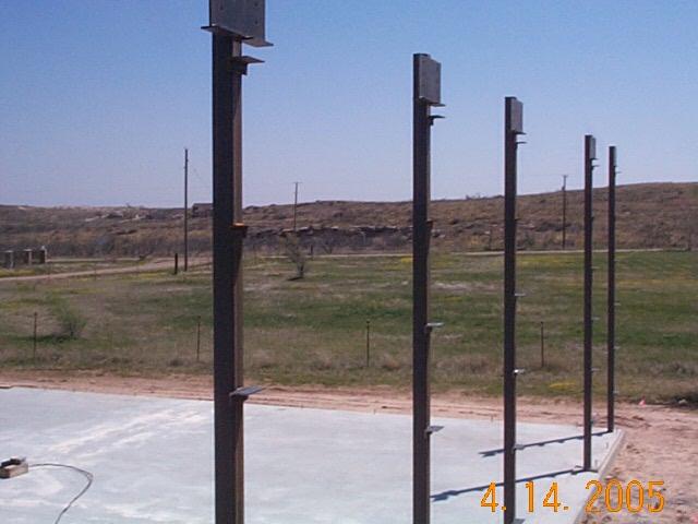

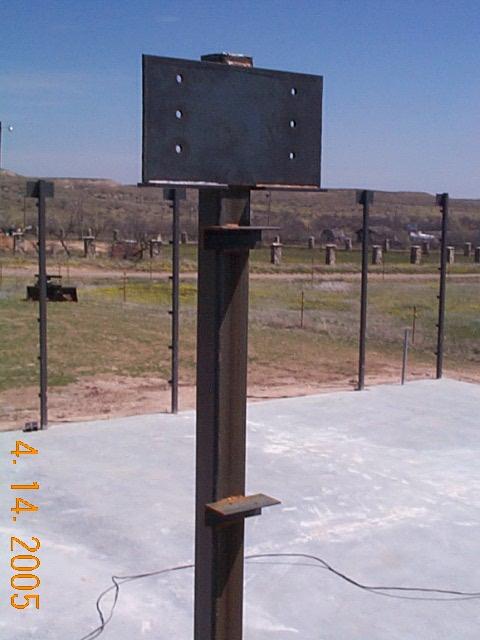

Hello. Weather and work have slowed me down lately but I'm hoping to get busy again soon.
The only progress to post is that my poles are pretty much finished. Welded the 3/8" mending plates for the 2x12 headers and the angle iron clips for the 2x4 girts to the poles, trimmed the poles to the right height and put a cap on top of the poles.
   / YAPB (yet another pole barn)
#34
...another picture...

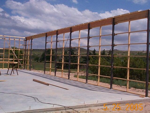

Thought I'd post a few more recent pictures as this thread is pretty stale...
After the steel poles were welded up and ready to go, I started on the wood framing. I put 2x4's horizontally on the clips and double 2x12 headers on the mending plates on top to support the roof trusses.

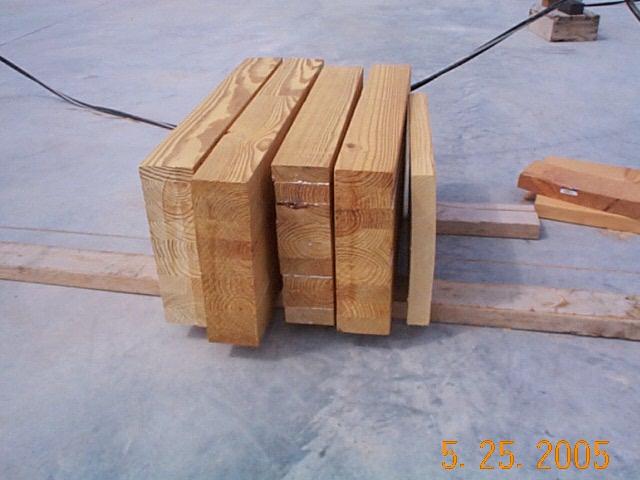

Over the garage doors I used a pair of 3.5x12 GluLam beams.

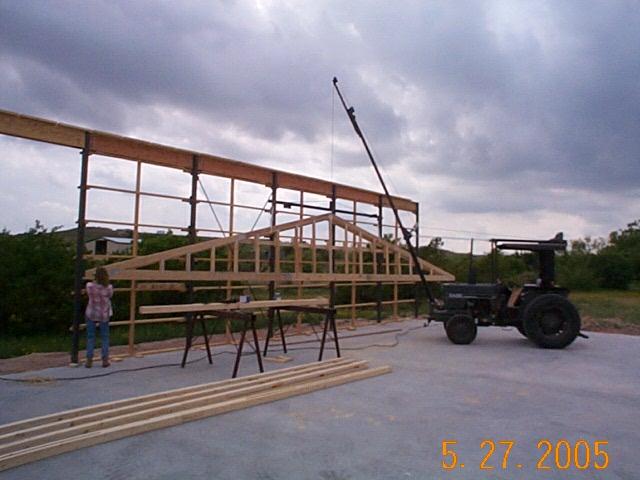

I bought thirty two 42' roof trusses. When they were delivered, the owner of the company that made the trusses said "do not attempt to put these trusses in place with fewer than four men".
He must have thought I was nuts when I told him that it was just going to be my wife and I! /forums/images/graemlins/shocked.gif
We used a home-made boom pole and a winch which I installed on top of my tractor to lift the trusses.
To keep them from flexing too much, I made a twenty foot spreader bar to secure the winch line to the rafters instead of just attaching at the peak.
In this picture, we've just lifted the first rafter off the ground and are getting ready to give it a go to install it on the rear gable wall.
