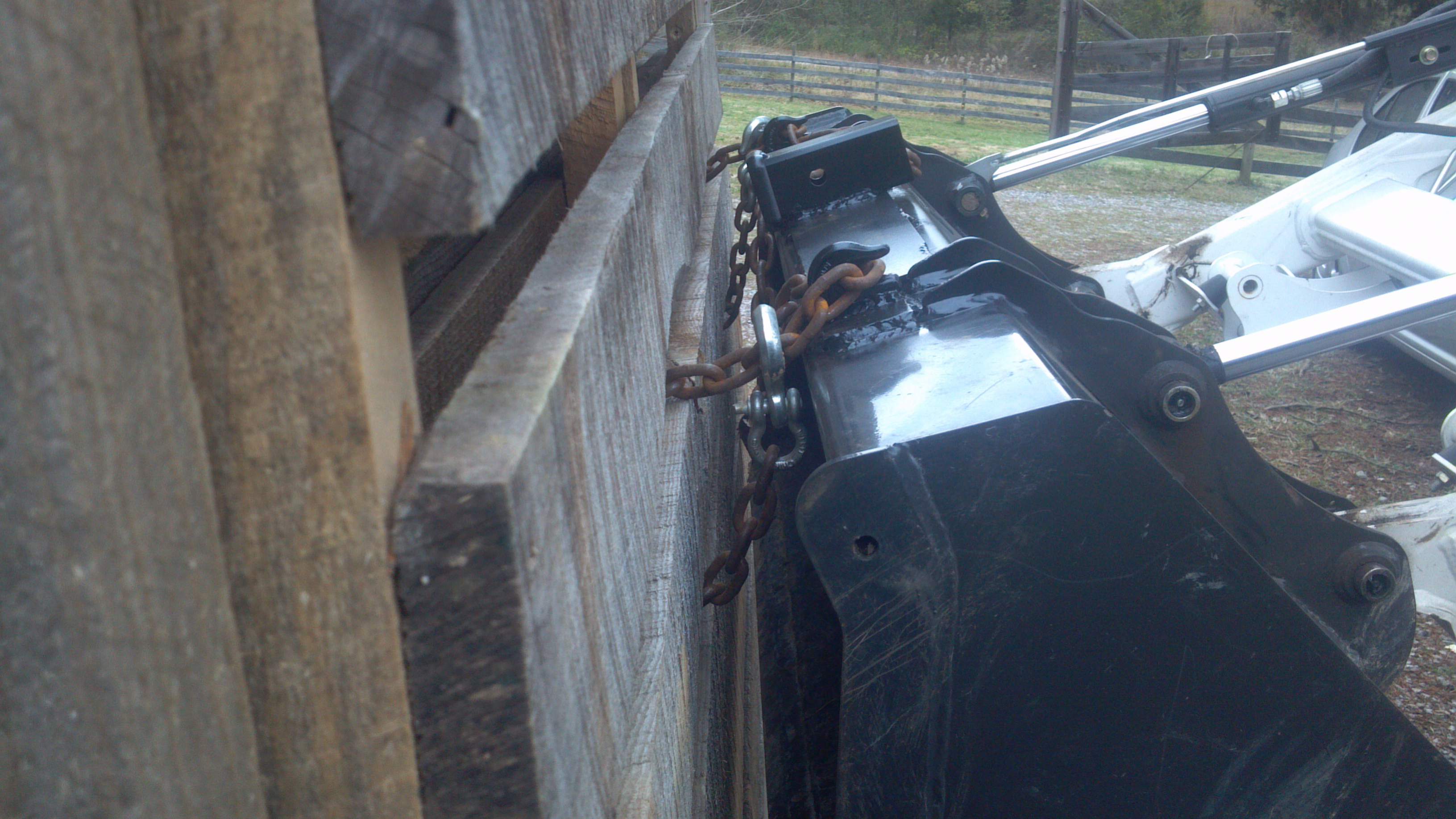

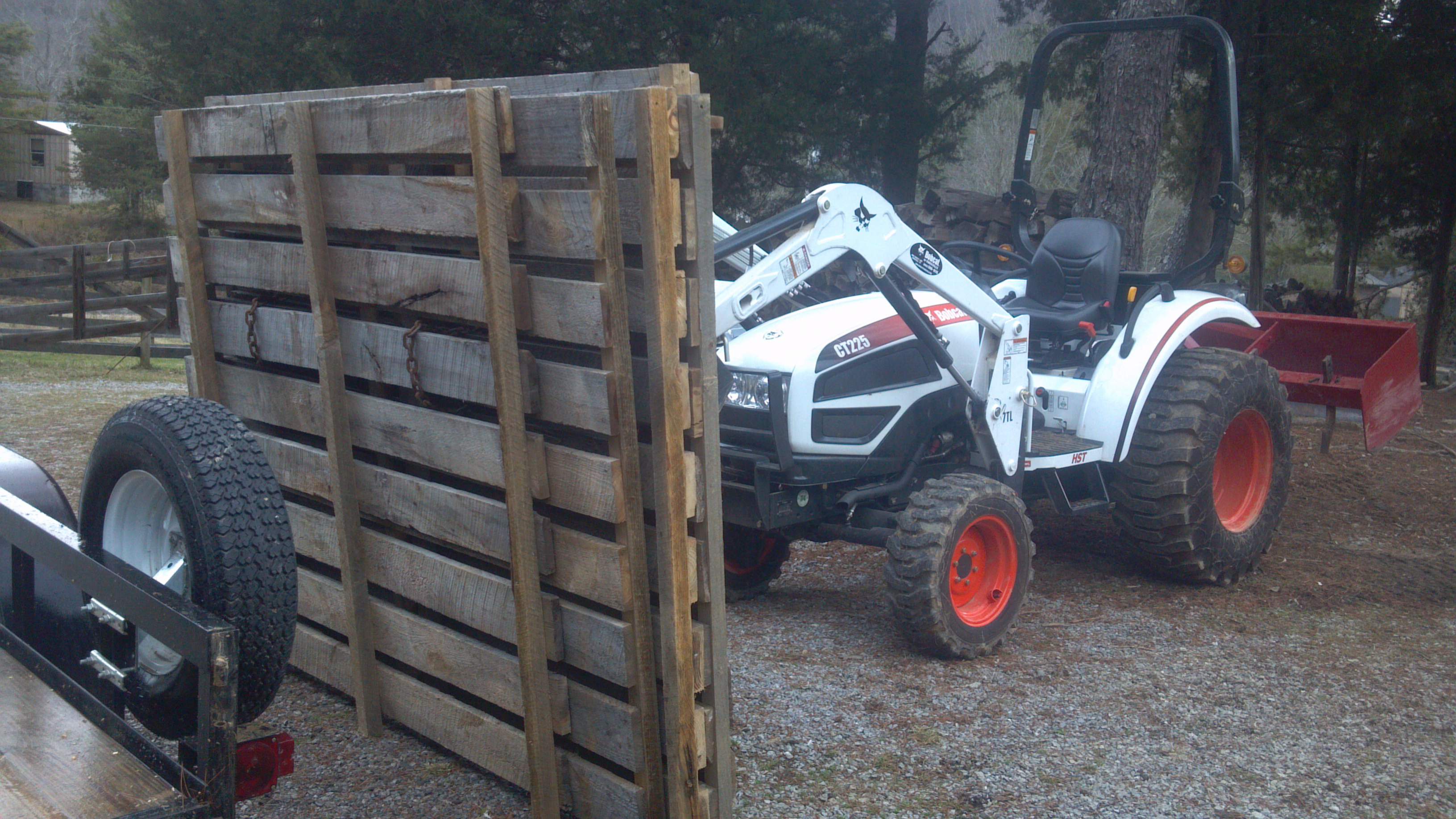

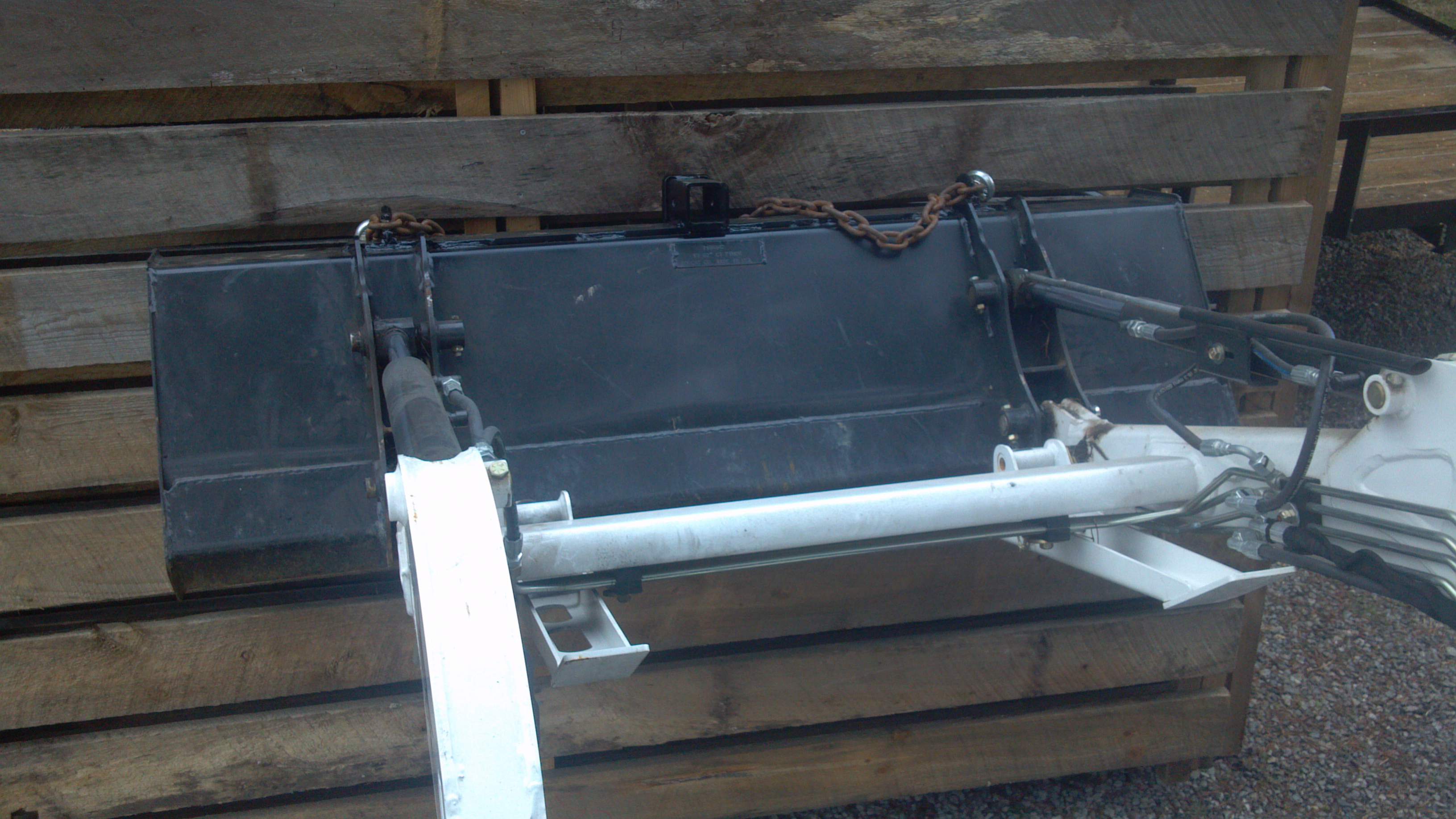

I got some use out of the hooks today. The attached photos show one of the main intended uses of the hooks: moving the walls that I use to turn my utility trailer into a makeshift livestock trailer for moving pigs to the processor.
I was easily able to pick up all the walls at the same time and drive them to their storage location.
