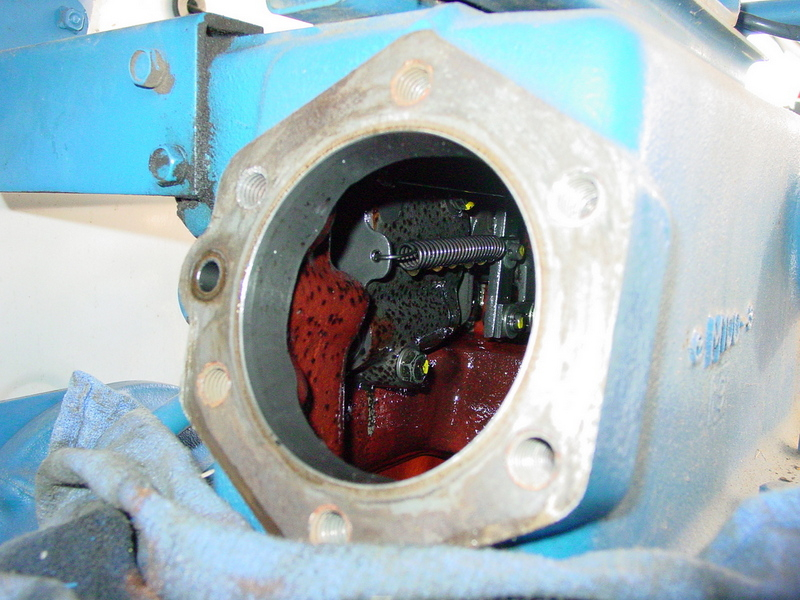

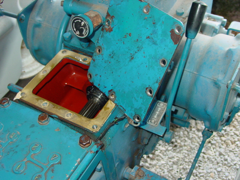

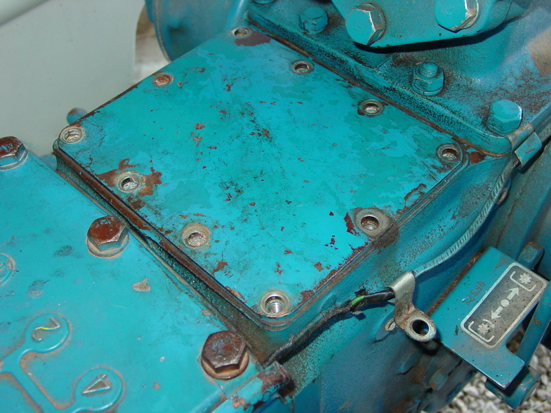

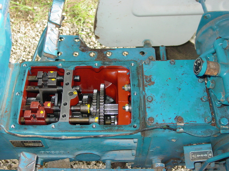

I already had the cylinder out and replaced the piston seal. I'm talking about the horizontal plate right in front of that that would be between your knees. I'm thinking that would give me a view of the strainer / filter.
Below is what you will find out. you cannot see the inside of diffy from there.
Thank you. I understand the concept of how a gear pump works but I was trying to figure out if there would be something or pressure against the shaft seal.

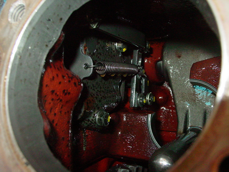

One last question, could there be something wrong with the valve that controls the 3pt? It is really the only thing I have not torn down.

Below you can see the pic of the spool valve that controls the lift. You can see there is oil splashed all over it. The reason is lift spool valve flows hyd fluid to the lift piston , once the lift height is achieved, then all the flow needs to go somewhere to avoid dead heading the pump and it does end up in the diffy by the spool valve inside the diffy. That oil discharge might add some air bubble but once it hits the floor of diffy then bubbles should collapse. I just can't see it causes the foaming. it is not easy to dismantle the spool valve. it is highly machined spool and mating parts. It will be difficult to source the inside component unless a hydraulics shop is able to mic and measure seals, o-rings and be able to put it back together. I would not dork with it at this point at all.
Good luck.
