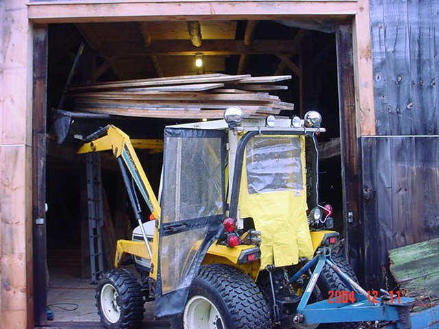

Here are my lights made up on a bed rail. I attached mine using u-bolts that I made up.

Jim.
Ah yeah - I caught that post where you were using the ROPS/canopy as a lift. I had been trying to find square u-bolts around here - seems like most of the places only carry the round ones. Then I had occassion to go down to TSC day before yesterday - went to a different one than I usually go to - found out that they had just moved into a new location which was about 10 miles closer. They had them there.
Looks good - the front facing lights look like some big honkin' units. /forums/images/graemlins/grin.gif
