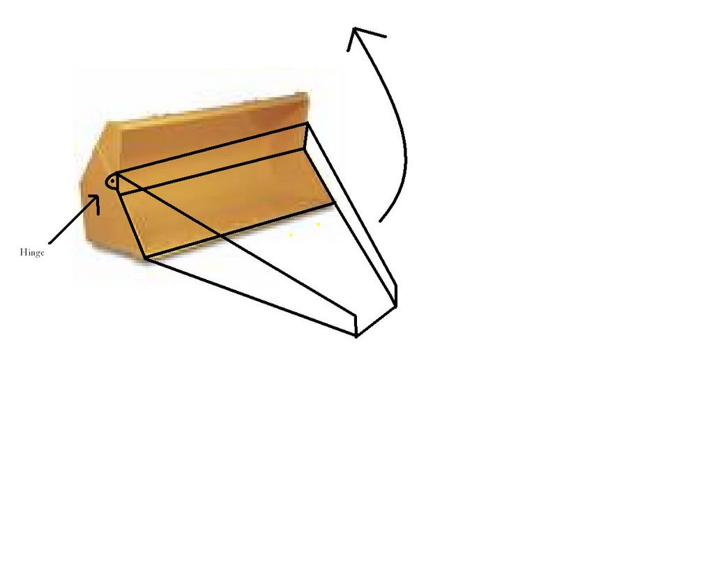

Dougster, have you thought about making a kind of spout that you could put on the front of your bucket. If necessary, you could make it removable so as you could fill it up with sand from your truck and then put the spout back on so you could guide it down the hole. Just kinda seems simpler than the whole funnel idea and having to move that funnel each time.
Heck, you could even put a hinge on it so you could flip it up for filling the bucket.
Sorry for the rubbish drawing :(

Dougster,
My bucket is approximately 1/3yd give or take that is only 30 trips to the truck. I load and dump my 3yd dump trailer 4 times in an hour = 12 yds.
If you could make that bucket extension like Grrr mention you could do this in little time without the surcharge. Are you going to compact as you go or just fill all and then compact? I would like to also suggest a concrete vibrator and generator.This will facilitate the sand flow. Also over top all the holes and clean up after the truck is gone. I don't know all the details but you are doing the right thing by asking.
Good luck I'm sure you will make it happen
Phil
Heck, you could even put a hinge on it so you could flip it up for filling the bucket. Sorry for the rubbish drawing :(
That's a great conceptual drawing Jake... and certainly one of the early concepts I tossed around... but again, we get back to cost. Can't be spending more to alter and later restore my equipment than what the job pays. Not sure about the UK, but steel and welding costs for a mod like that can get pretty high over here.
The stump bucket is different. I need one anyway... and the cost is amazingly reasonable... and less than what I'll make on this job if I get it. :)
