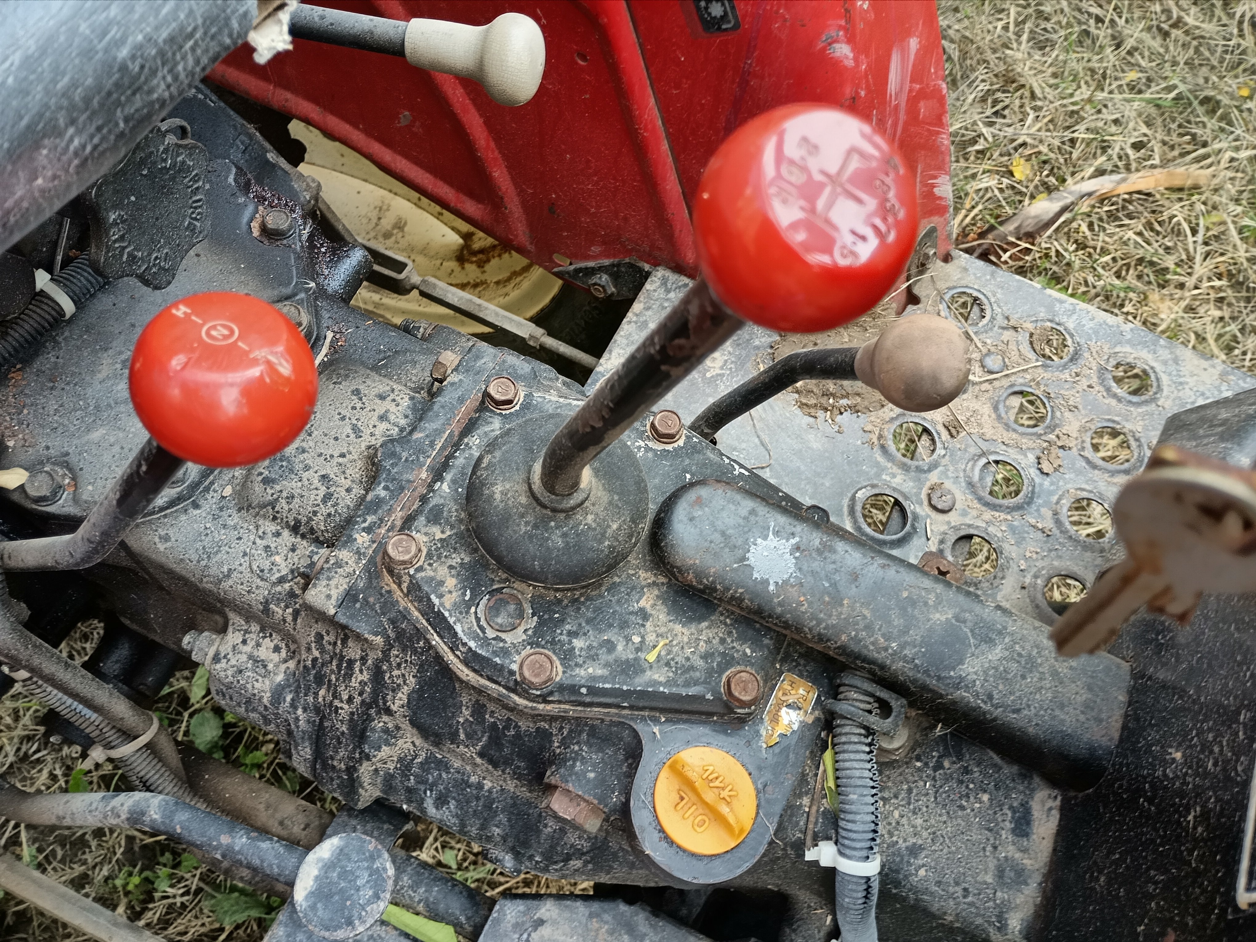

I am working on a ym180d , Can you tell me what type of oil is used in the gear box?

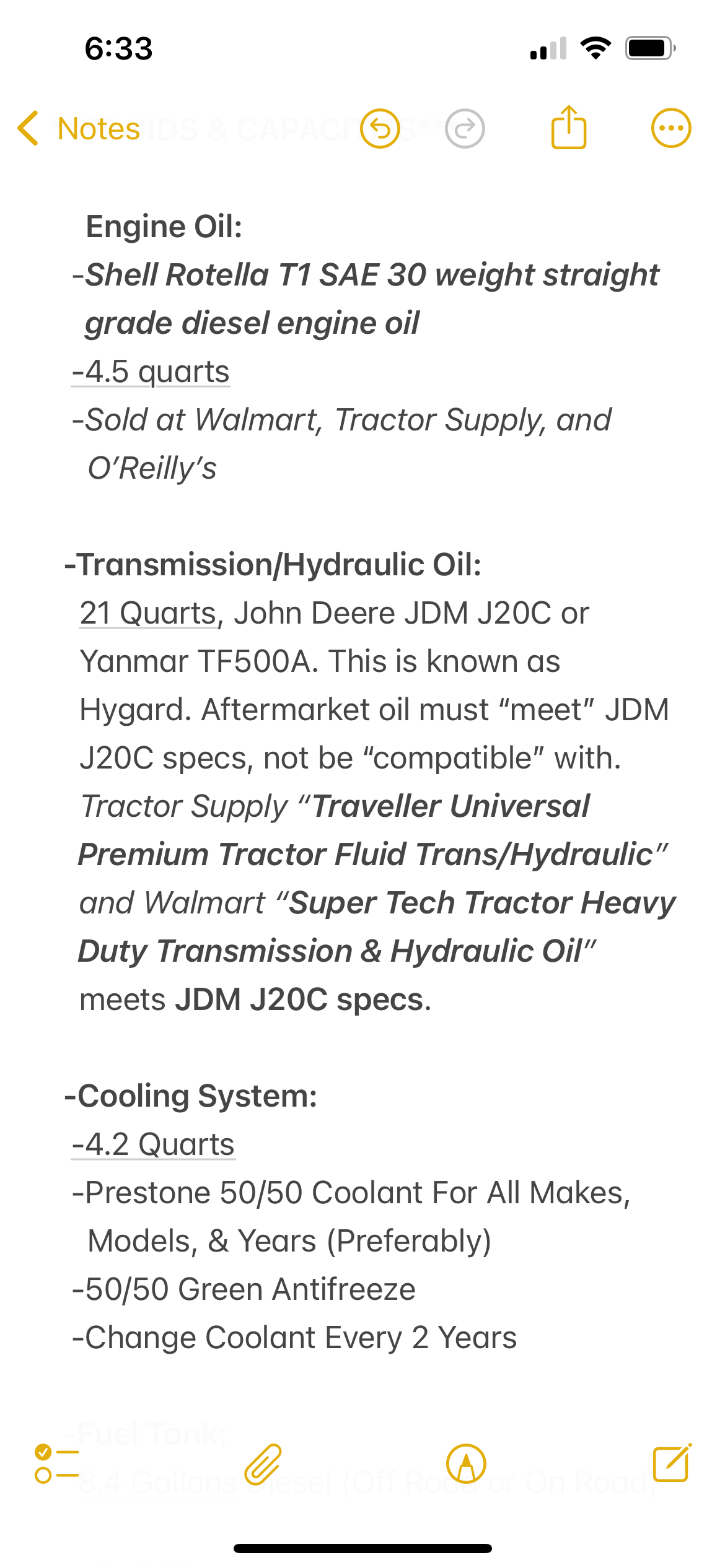

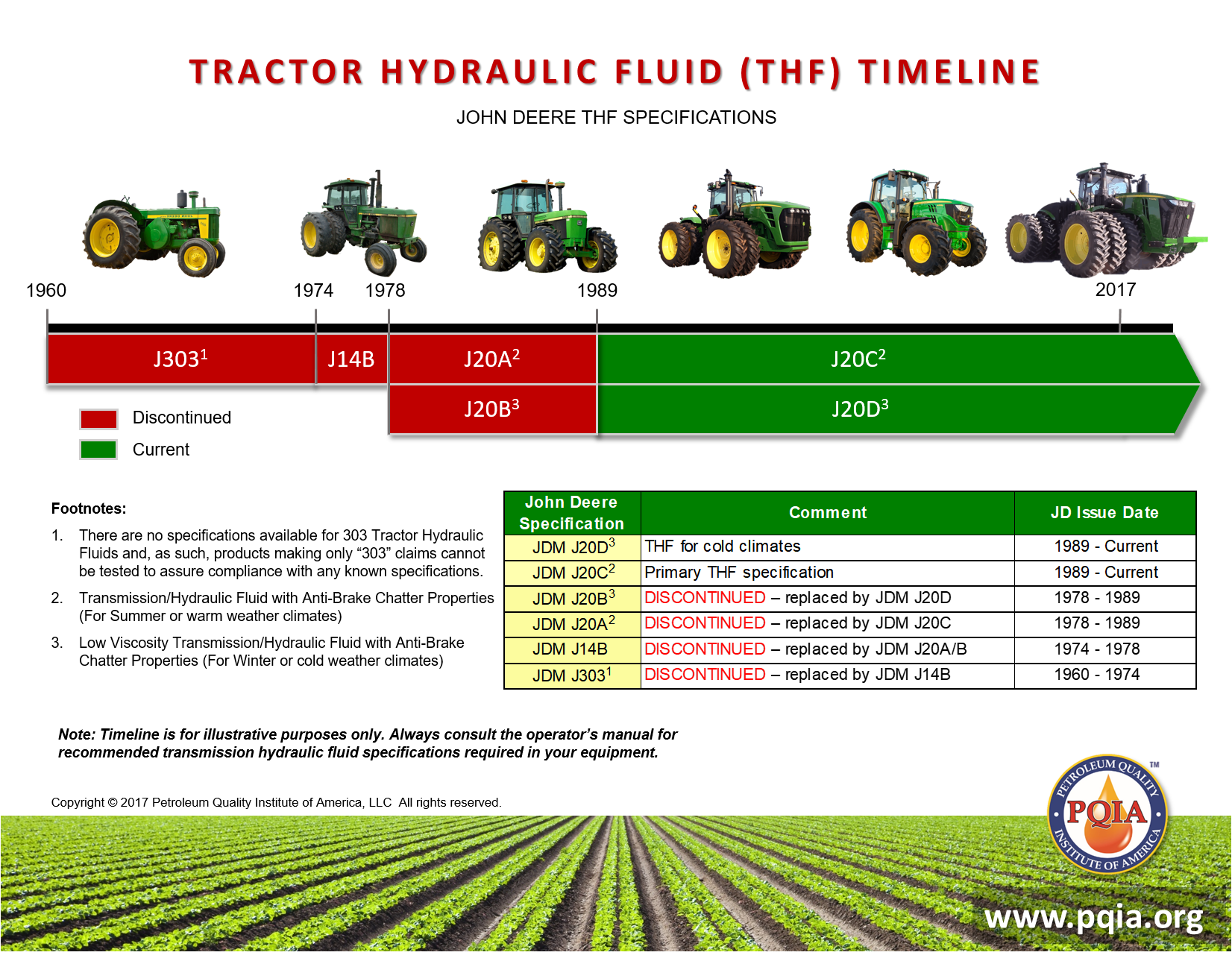

I know this is an old post but a bit of an update since i have the info right in front of me and there's a bit of confusion; The correct tranny / hydraulic oil now is J20C oil or "JD20C compatible" John Deere's trademarked Hy-Gard brand; JD20D for colder climates.
Other info you'd have to verify; Old Fluid with JD 303; (J14B). He said if I cannot get 303.....(?to use Dextron 3. Sun Oil – Altram #303?)
/ YM 180D transmission fluid #8
...Other info you'd have to verify; Old Fluid with JD 303; (J14B). He said if I cannot get 303.....(?to use Dextron 3. Sun Oil – Altram #303?)
Huh? Who was advising that?
'303' was an old spec with whale oil. Whale oil is a superior fluid resisting corrosion, but illegal to sell. For decades, now.
Anything labelled '303' today can have random ingredients, there's no such specification.

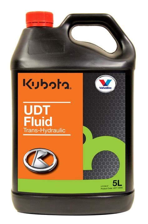

There are only 3 possible fluids to put in your YM180(D).
Hygard = JDM J20C
Yanmar TF500A = JDM J20C
Kubota UDT original = JDM J20C
Ashland-Valvoline makes JDM J20C
Only buy brands that STATE, MEETS J20C and never never never 'compatible' nor 'recommended'.

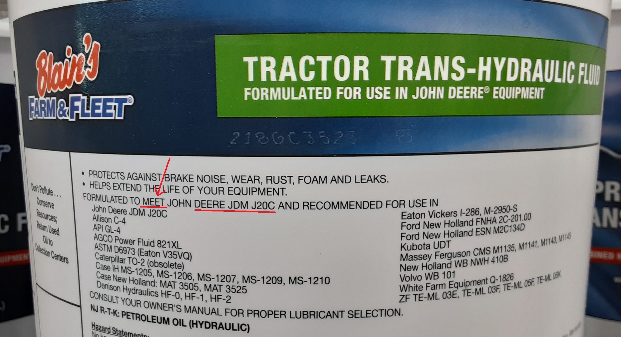

I guess there are several thousand of us that are in serious trouble that have been using other brands of J20C for the last 25yrs without problems.
/ YM 180D transmission fluid #13
I use Farm & Fleet.
