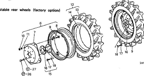

I re-read the whole thread and noticed HoyeTractor's comment on some engineer estimating doubling stress for every 1/2 in extension. THIS COMMENT BOTHERS ME. Since I don't have a tractor and don't know how a wheel is mounted, I cannot say for sure if his comment can be safely rejected.
So, please tell me someone how a wheel is mounted on the axle. I was relying on another post that mentioned 2" diameter axle, 6" distance between the outer bearing and wheel center. In other words, the outer bearing is the last support of the axle. From then on, the axle is just sticking out freely. If this is the correct description of the axle/wheel, then the other engineer was wrong. There are 2 components of stress on the axle. One is torsional stress which should remain same. Only bending stress increases in proportion to extension. Combination of the two stresses does not magically increase total stress.
Zoster,
Before taking off with the idea, can you talk to an engineer? Or, can you post some pictures for me?
HoyeTractor,
What kind of engineer was he? I am not challenging him. I just don't want to extend beyond my capability.

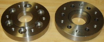

I hve been reading this post, and it peaked my interest. As a mechanical engineer by profession, I was curious about how adding a spacer to widen your track width affects the stress on the axle and the load on the bearing. Well being the nerd that I am, I plopped myself down in Excel and banged through the calculations required to determine the axle stress and deflection of the axle vs/ spacer length. I was surpirsed to see not a a huge increase as spacer length is increased ( it definitely is not 2x per 0.5in increase in spacer length as someone earlier mentioned). I have attached an Excel spreadsheet which you can download and play with for yourself. To summarize the data:
Assuming a 6 in spacer per side (worst case)
You have a safety factor of at least 3 for torsional stress, torsional deflection, bending stress, axle deflection (sag), shear stress, and radial load on the bearing.
In the engineering world, something with a safety factor creeping up on 4 is considered "tractor engineered" no pun intended. Most tractors are way overdesigned mainly b/c weight is not a negative but a positive, and you never know what someone will try to do with a tractor.
Note:
my calculations are for static loads only and do not incorporate fatigue - this is why a safety factor is used - to account for these things.
I think you will be fine with the spacer, whenever I get a tractor I will make me some.
PS - if anyone needs spacers, I can design some in Solidworks for you and provide you with prints to take to your local machine shop (free of charge of course) or machine them for you myself.

Philip,
Nicely done spreadsheet. My only comment is that the change in stress from adding a specific thickness spacer will be a strong function of the separation between the inner bearing and the outer bearing. You have shown this separation as 6", which may be a bit high for the smaller tractors.

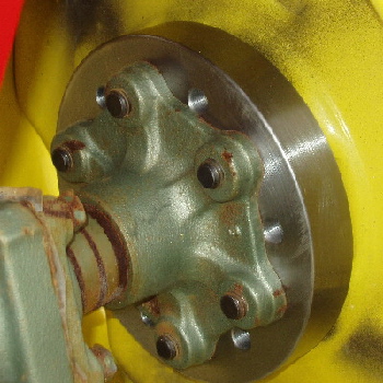

Yes, the internet is amazing. Thanks very much to the members who invested time and thought in calculations on this subject. It's good to have "country boy" guesstimates bolstered by 'rithmatic & engineerin'. I'd even be tempted to try thicker spacers, but my 2" ones have added the stability I wanted without making the wheel track wider than my tiller and give the tractor a more appealing "stance", methinks.
And they were easy to obtain. Just took a wheel to a machine shop around the corner where they measured it, found the dimensions to be unremarkably standard, and called me in a couple of days to pick up the spacers. Pretty simple way to gain stability on my hilltop.
