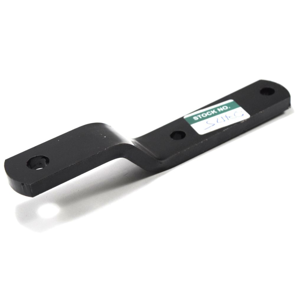

Great info CoyPatton. I was looking for one which would fit but now with your info maybe I will make one myself , thank you
Yes, I too believe the YM1510 uses a flat bar with a ball setup. This is how the John Deere CUTs are made by Yanmar.
Not sure the hole spacing to make one yourself or to order one like this.
https://www.searspartsdirect.com/product/1bfoj263ca-0071-486/id-23475
The nice thing with a bar like this, you can flip it to get lower or higher as needed for whatever trailer you need to pull.

I think - not sure - that all the gray market YM's have a round drawbar and the US models (plus Deere) are flatbar.
/ YM1510D question #13
Look at his photo. It is a recessed area into the housing with 3 threaded holes in the flat of the recess.
I believe his YM1510D would be a gray. But it is built very different from my YM2002D for the draw bar.
You build what you can not find to buy. If the mounting holes for that line up, it would have him up and pulling in no time.
