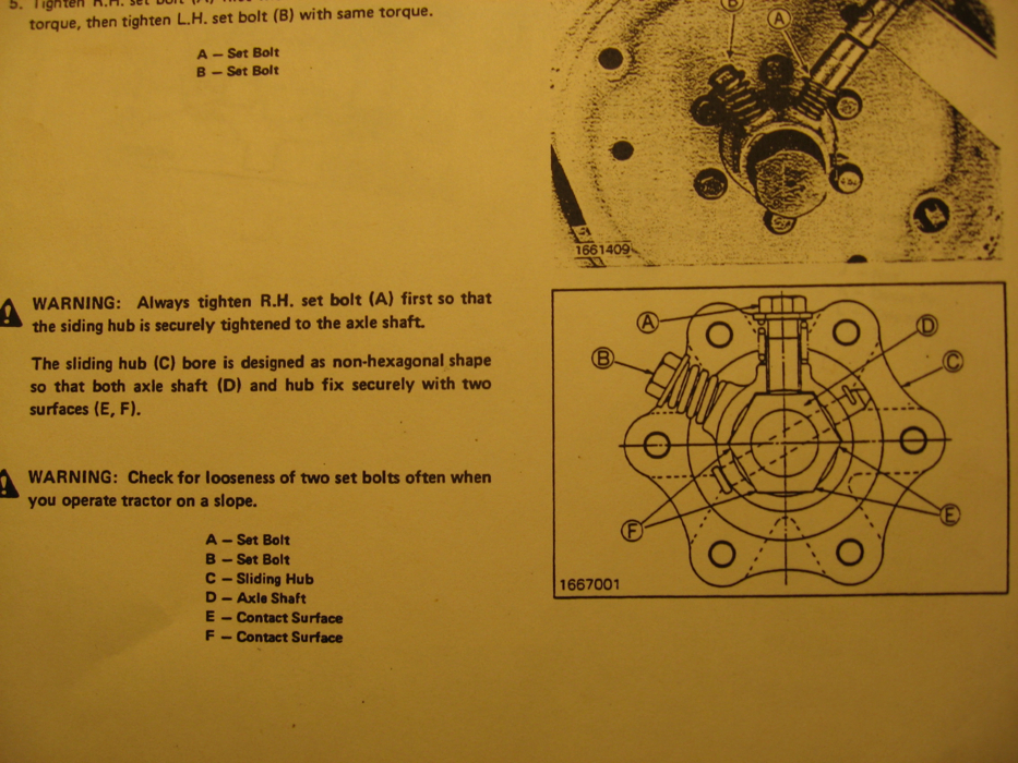

I just picked up my first tractor. It is a YM180D with a YFL165 loader. I have been looking all over for a Yanmar and just when I had about given up there it was. It is a bit of an ugly duckling but everything works great. The only thing that seems to need attention is one of the rear hubs which is loose. The axle is an octagon along with the hub similar I think to a ym186 or 187 and some of the other small no greys. My question is what is the best way of fixing it? Anyone had a similar problem?

Hubs are not an octagon. Loosen both cap screws and then tighten right cap screw first. That should do it unless it has been run loose for awhile.

That is what the hub looks like but the set screws are turned all of the way in already. I was thinking sheet metal shims but maybe I can buy a hub and slide it on a different part of the axle? Does the ym155 hub fit a 180 axle?

/ YM180D Hubs #6
The hub bore is designed as non-hexagonal that's why the right bolt gets tightened first. Tighten to 72 lb. ft or 98 Nm.

Right = the one farthest from us in the Hoye photo? Why does it make a difference?
Mine are reversed for maximum width with those cap screws on the inner side of the tire. Does that change which gets tightened first? Seems to me if the sequence makes any difference it should be expressed as 'leading bolt/trailing bolt' while driving forward, no? There has to be some reason for the recommended sequence but it escapes me.
Dave, I wonder if your set screws are what was in there originally. Do you see any evidence remaining that there were springs as shown in the photo?

California, click on the paper clip to see if I did this right. If not tell me what to do to upload it. (Never mind I stumbled to success anyway.)

IMO A,B Tightening Bolts must have come loose at one time? If they are tight and there is still Wabble then the hub is most likely Worn on the Inner/Outer Edges. If that is the case you should be able to Shim up the E,F edges to prevent it from wobbling. Once you get them in and thickness needed might want to put a tack weld on them to hold them in place. I'm doubtful the axle has worn.
Either or should be able to shim them up or replace the hubs.

My 165D is set up the same way. One hub was loose, and it looked as though the tensioning bolts had worn to where they wouldn't make good contact, even when fully tightened down against the spring. The shaft was fine, so I replaced the bolts with a couple of slightly-longer 16mm, problem solved.

California, click on the paper clip ...)
Thanks Buppie!
"The sliding hub bore is designed as non-hexagonal shape"
They say tightening the right bolt first seats the hub to the axle with maximum contact surface. So apparently if the left bolt gets tightened first, it could leave slop that becomes wear.

Not much doubt With With Misterbadger's post Shim it if it' been like that for awhile and new Longer Bolts if the springs are Bottomed out. That will keep all the tension of the bolts from the slop and wear and help keep it it from happening again.:thumbsup:

I fixed it today. The adjusting bolts were mushroomed over did not have the length to take up the slack in the hub. The hub and axle were fine. I put some new bolts in and all is well. Thank you for the explanation on how to tighten the adjusters. Thanks to all for the help I even had enough time to play with my new toy today.
