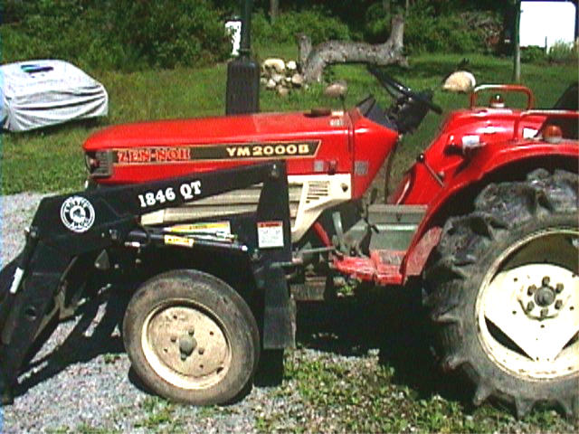

I have a YM2000b that I use Exclusively with the FEL. It's a Bush Hog 1846QT. It's rated at somewhere around 770 pounds of lift. I move a lot of gravel, dirt, boulders, and especially firewood. I built a set of forks that very quickly clamp on to the bucket, so I can move 8' logs around the yard. Even with the moment extended 4 feet in front of the bucket, I can still load several logs on and tool around the yard. I also built a rear weight from a scraper blade frame.
The blade was broken off, so I slid half of a 55 gallon drum over the end and filled it with concrete. It looks like a wheelie bar on a dragster. My wheels are turned for a wider stance, and I always travel with the bucket low to the ground. When I'm digging I employ the traction lock, and do very well with it. As long as you are smarter than your tractor, and think about what you are doing, you shouldn't need the government to protect you from yourself. E.M.

I'm interested in the FEL you have on your YM2000B. Did you install it yourself? If so, how difficult was that process and how well did it fit the YM2000? What about the connections. How do you tap into the existing hydraulics?
Do you have a picture of your installation?

The loader was already mounted when I bought it. When It stops raining I'll take a few pictures for you. Thursdays and Fridays are my days off. Hopefully by then.
It looks like a fairly easy installation. A crossmember under the belly with 4 bolts, and a "U" channel mounted to the front bumper. E.M.

I have 5 pictures that I'm going to attempt to attach.
While taking the pics I gave it a good look over.
It was definitely a bolt on installation. The mounting bosses are cast right into the frame and already tapped. There are only 2 hydraulic connections visible on the right hand side, under the throttle pedal area. As I said before this looks like a very simple installation.
You may need to save the files and play with the brightness and contrast to get a real good view. My camera was saving them dark. E.M.
