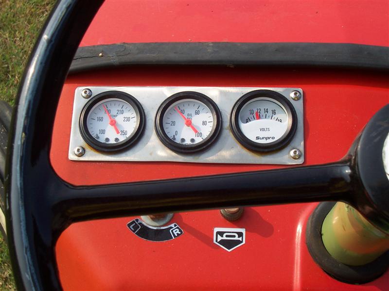

Depending on what you are doing; I am sure you will enjoy your YM2000. I have a YM1700 which is just below your model, but I love mine.
As far as gauges; I purchased the gauges and metric adapter for the oil pressure from Autozone and the temperature adapter from Advance Auto. I used the Sunpro 1-1/2 gauges and got rid of all the idiot lights. I just keep an eye on them while using the tractor. It only takes a split second to look and make sure everything is running o.k. I posted a picture of my gauge set up.
