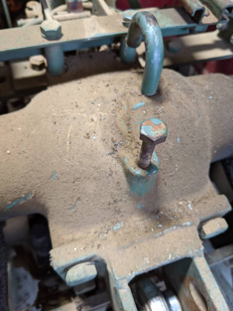

The transmission vent is an inverted J beneath the back of the seat. It unscrews if you need to clean it out. I had to replace mine on the YM240. I suppose the prior owner used it as a towing point, it was broken off.

The vent was definitely clogged. It had a mixture of oil and dirt, which I have to assume is from mud daubers.
There is a 13 mm hex bolt adjacent to the vent that I had to remove in order to unthread the vent. It appears to open directly into the housing (pic below). What is its purpose?
