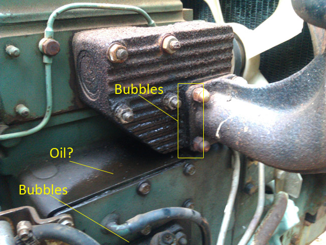

Can anyone tell me what this is, i see a few bubbles coming out of where the muffler bolts to manifiold, figured it need a new gasket, also see a few air bubbles from the side of the fuel injector where it meets the block, minimal, but there.
Notice in the picture the wet area, not sure if its oil or diesel, feels like oil, now I ran it about 1 hour discing and ran fine, it still smokes until it warms up some but nothing really bad, still see a bit of faint smoke from the crankcase vent at idle, at working rpm its not noticeable.
If the wet area is oil, would this be because of a failed gasket at the manifold/exhaust, guess Im asking would one expect to see oil in this area with failed gaskets or even if the gasket was bad no oil should be here regardless?

The only way there can be bubbles at the muffler/manifold connection is if fluid is coming out of the engine and the gasket there is bad letting exhaust out is how I see it. The lower bubbles illustration is not clear enough for me to see it but thats the pump so it is still confusing the bubbles part should be just fuel.
Ok, so regardless of the bad gasket, fluid coming up to that area is not normal or that would be common with a bad gasket at the manifold? Im not worried about the gasket more so then knowing if anything should come out. If an engine is in perfect condition and the manifold gasket fails, will a perfect engine still lose fluid/oil in that area? is there other issues here aside from the the gasket?
I put a white cup up over the exhaust for several minutes and the cup stayed clean, no oil or anything wet blew out.

Ok, so regardless of the bad gasket, fluid coming up to that area is not normal or that would be common with a bad gasket at the manifold? Im not worried about the gasket more so then knowing if anything should come out. If an engine is in perfect condition and the manifold gasket fails, will a perfect engine still lose fluid/oil in that area? is there other issues here aside from the the gasket? NO
I sure wouldn't think it would be normal, the only other fluid I can imagine at the bottom of the muffler at that area would be condensation or rain water that is not all gone at the time you are looking at it? A head gasket will certainly cause bubbles if enough coolant gets in the combustion chamber when it is sitting shut off and the exhaust gasket is bad right there. So as once its started the coolant escapes anywhere it can IE bad exhaust gasket at the bottom of the muffler where it can sit and collect.
We are looking @ 400 psi vs 10-13 psi the cooling system is not likely to be pumping coolant out while the engine is running it will be the reverse-combustion into cooling system as a rule.
Does it still bubble after running it awhile? The exhaust manifold shouldn't have any bolts into the cooling system or any other fluid on the engine that would allow fluid to be there is how I see it.
The moral to the story is wait and see is JMHO but rather than get too excited about the engine needing repair run it and get more facts if its a bad head gasket there will be more indications of it than bubbles at the muffler.

its either water or fuel in the exhaust system. Im thinking more along the lines of water in the muffler/manifold??
