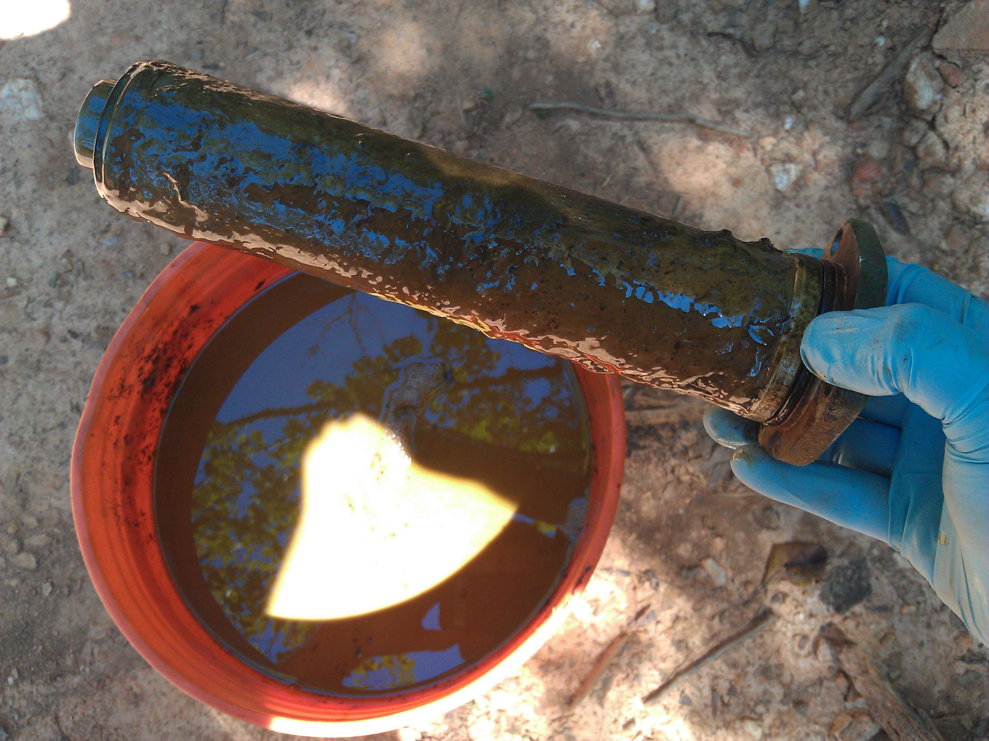

here is a pic of the the screen, I had to use carb cleaner to break this crud loose.
Sounds like you are making some headway. That hydro screen looks awful, I am sure your hydraulics are flowing much better now. As far as the 3 point, it could very well be the valve under the seat. That will let the fluid just bypass the 3 point which is fine and dandy if the tractor is pulling a cart all the time but not if you always use the 3 point hitch. On the other hand the O-ring inside the lift cylinder for your 3 point hitch could be badly damaged due to crud in the hydraulic fluid which would also let the hydro fluid pass by the piston. My bets are on the valve though. :)

Just looked at the big pic of that screen. There appears to be a good bit of rust in there, i think you may have had water in that thing. I would run that fluid for a few hours then dump and refil on the cheap fluid again!! Id run it like 5 hours or so then dump. You may have some pitting on the gears but if not terrible should not hurt anything, esp for the price you got it for.
There was definitely water in it, it was like gel on the screen.
