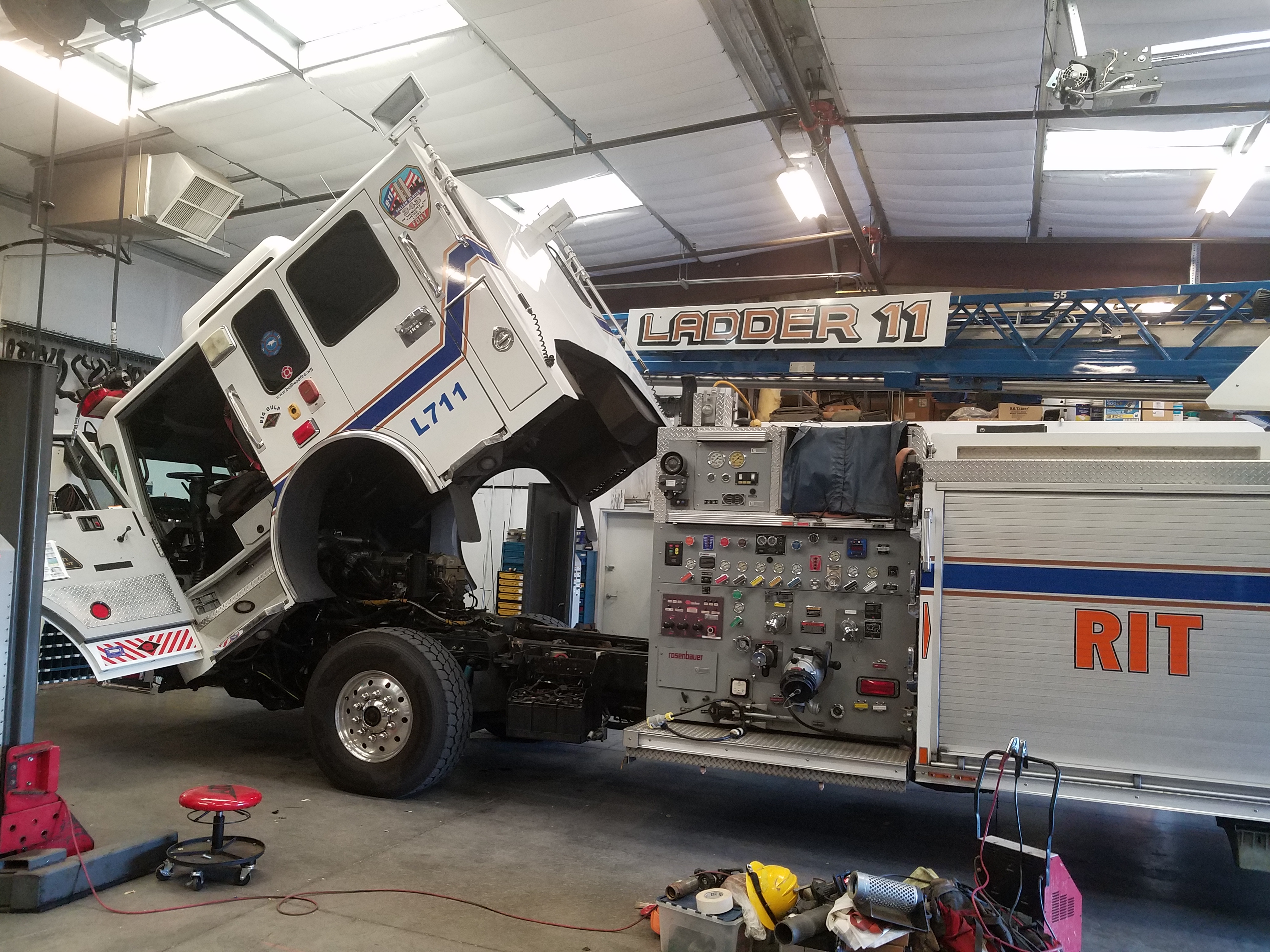

Hey sorry for the delay in my reply's, Im at work and working on this.
