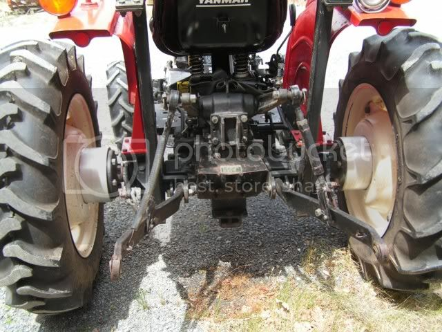

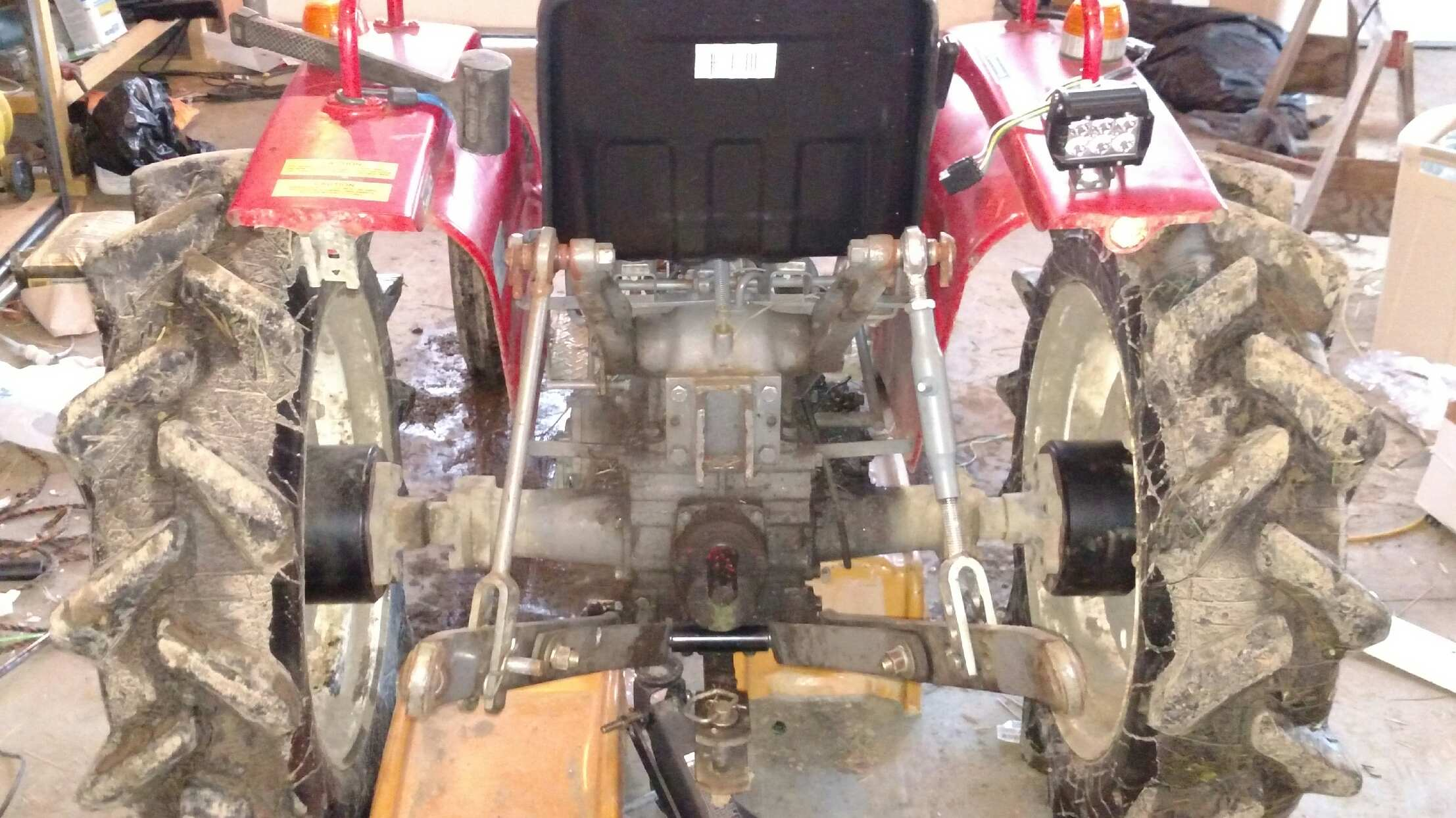

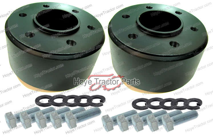

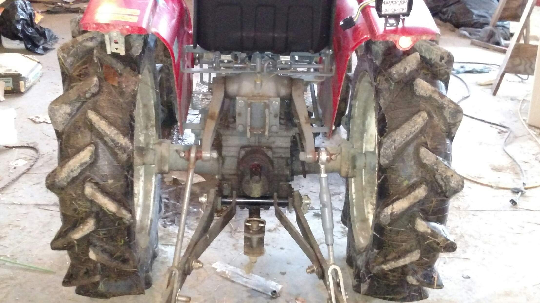

Per the Yanmar USA tech manuals, do not exceed the 4-inch [100mm] spacer thickness. The YM240 & YM276 both have this as optional equipment. The YM240 is a twin to the gray market YM2000. So it does apply to the entire YM Series machines made.
For Yanmar to specify not to exceed the thickness, they must of did some type of testing. Keep safe and keep in the 4-inch or less realm for thickness. :)
Even the aftermarket like Hoye Tractor has them. (on National back-order)
YM1510D
Before
After
YM236D
Should your machine match the Yanmar/John Deere wheel spacing, then these would work too.
John Deere JD850, JD950, JD1050, JD900HC, and a few of the 55 Series too.

OUCH. That price is double the cost of John Deere wheel spacers. And John Deere parts are pricey to begin with.
Motorsport Tech custom makes them for all types of Ag machines using one of the strongest aluminum grades 6061-T6 or in steel.
Their brand is the BOAR Wheel Spacers all around the web. And, they do have YANMAR.
