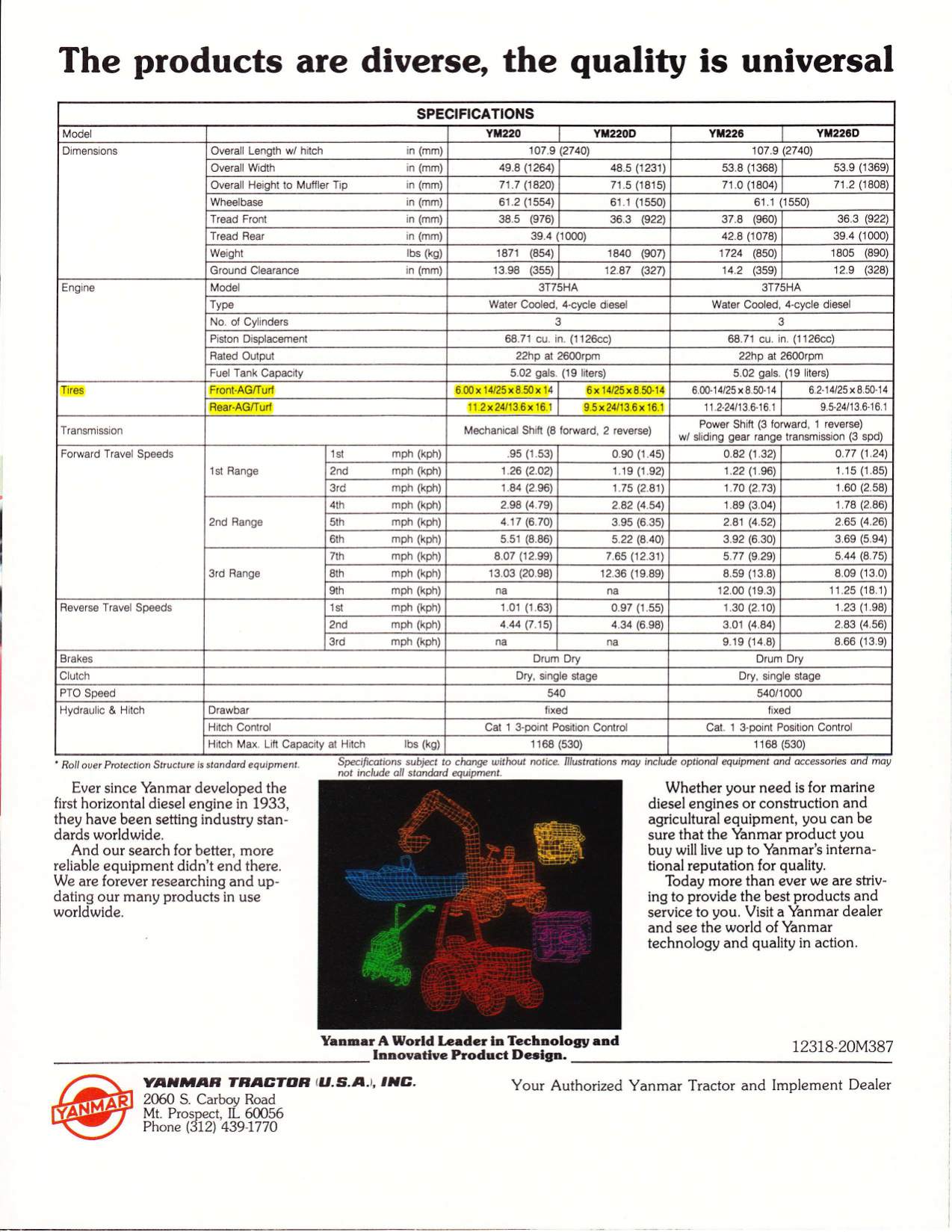

My pump is rated at 8.2 GPM. Don't hold me to it, but I suspect your 2210 is the same
/ ym226d 3 point struggle #3
Yanmar says 1168lbs "at the hitch" in their brochure for the lift capacity. I can't find any information about the pump sells for the 226; it also fits the YM2020-2420 series machines, but not anything else I can find information about. If you can post the numbers on your pump's data plate, we can help out with the volume, and it can be incorporated into Scotty Dive's terrific compilation of data here: https://docs.google.com/file/d/0B85YoHWb2pqbWkVqOUdQZXZja2c/edit

The 226 repair manual says 6gpm at 2600rpm. Pressure relief valve setting 2209 - 2356psi. Safety valve (surge relief valve) 2503 - 2798psi. Lifting capacity 1168lbs at links end and 816lbs 24" behind link end.
Hydraulic cylinder leakage (during 5 minutes): Less than 0.8 inches with 694 lbs load on 24" behind lower link end.
