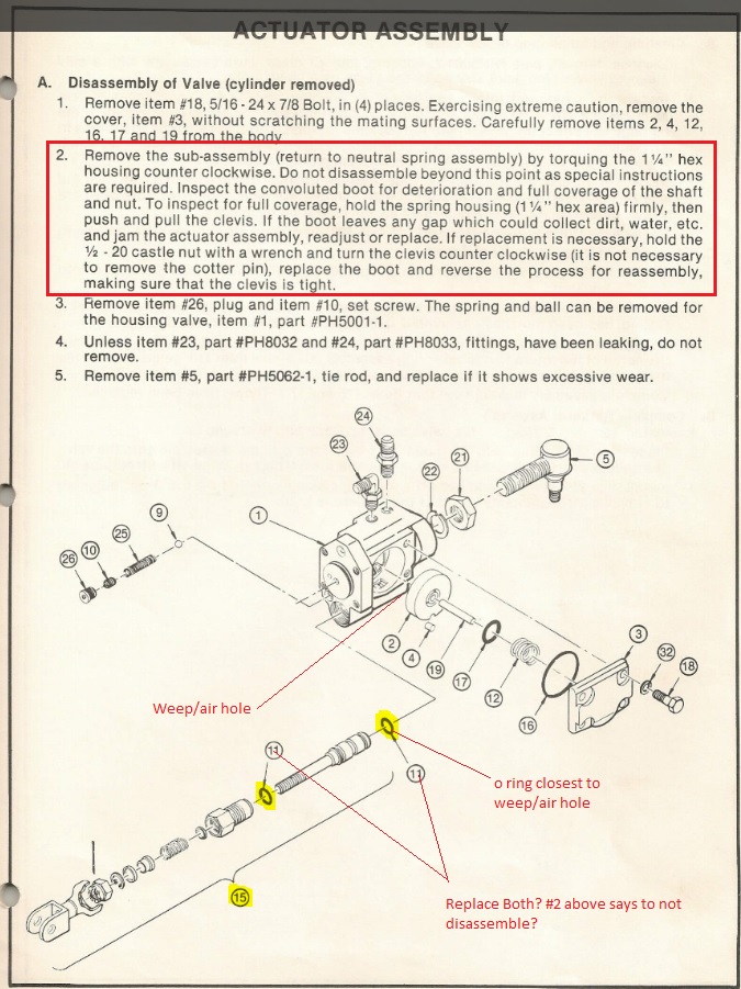

Well, I had the Hydraulic Shop look at it, the guy said he is pretty sure he could repair it, however I believe I scared him out of it telling him how rare or impossible finding those aluminum casting parts are, he will attempt it, BUT he is not responsible for it if he breaks any of it trying to remove the large cylinder, same as California has clearly shown the concern over putting the required force to break it loose. I am not sure I want to risk it.
I also was able to measure a drag/steering rod from a YM220, it is 25 1/2" long with a slight bend 5" up the rod on the axle side. I believe I can get someone to make me one of those with some steel tubing and welding a threaded coupler to each end for the tie rod/ball joint threaded stud to screw into.
I was reading over the Actuator Assembly diagram and #2 says Remove the sub assembly, Im guessing that is #15 in the diagram, but do not disassemble beyond that point, so is the #11 o ring closest to the weep/air hole the sole culprit here that needs to be replaced, what about the other o ring deeper into the sub-assembly (#15). I made some annotations on the photo.
I think that #15 assembly is factory-calibrated for neutral steering effect when you aren't turning the wheel. I definitely wouldn't disassemble it.
I would replace only the O-ring nearest the weep hole. Only in case the one deeper into the mechanism is visible, would I replace it, because I think getting to it will disturb the left/right steering balance.
In that diagram the weep hole points down. I wish mine did, it squirted upward all over the side of the tractor until I put a 'diaper' (inner tube segment) over it to change the squirt to a downward dribble. The volume that comes out isn't much, less than the volume of an aspirin tablet for every left turn, but it made a real mess over several days.
