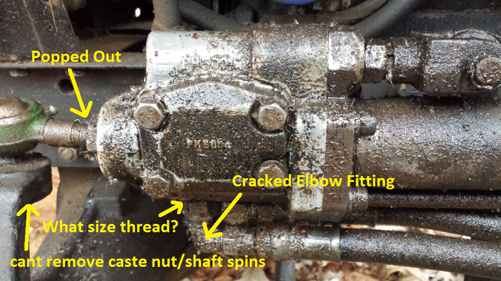

Ok, I have quite a few issues, Please see the picture and any help is much appreciated.
ok, all this happened in a bad spot, behind my house near the creek, so my tractor is sitting back there until I can find a fix. My first thought was to disconnect the hydraulic hoses for the power steering, remove the power steering cylinder, purchase a drag rod/tie rod to connect steering arm to axle, so basically make it like most yanmars without power steering. Unfortunately I am unable to find a drag rod assembly for my tractor (YM226D) I have spoke to HoyeTractor and Fredricks. Not to mention the hydraulic configuration isn't so simple, hoses going from the power steering cylinder to a plate under the seat, to another plate below the 3 point lever then leaving there and connecting at the front loader valve.
Well, to continue the saga, the threaded tie rod that screws into the power steering cylinder stripped out and fell out, resulting in the cylinder falling and cracking the hydraulic T fitting spraying hydraulic fluid everywhere.
So more questions:
1. If the threads are stripped inside the power steering cylinder where the threaded tie rod screws into it, can that be repaired? Hopefully its just the threads on the tie rod itself, I have ordered a new one from Hoye, hopefully it will screw into the cylinder allowing me to at least get the tractor back to the shop.
2. Any idea what size the threads are for the cracked T fitting?
3. I can't seem to remove the old tie rod castle nut, it spins the entire shaft going into the ball joint, whats the trick?
I attached a photo to help with my questions.
