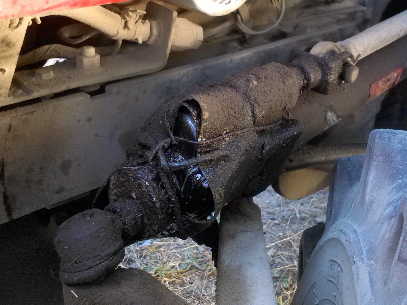

Digging up this oldie to see if Smoody was still around with an outcome. I have the same cylinder on a 330D and its been doing this 'squirting' thing for years, but I think its getting worse.

Farther up in this thread is a link to another thread
http://www.tractorbynet.com/forums/yanmar/218151-anyone-have-pics-power-assisted.html
that discusses the same thing. There are pages from the PS manual - scattered across several posts - in that thread that should be sufficient to visualize the repair.
In summary, O-rings, #11 in the diagram (two of them) are what leak. The one at the tip of assembly #15 is what lets fluid escape and go out the vent hole. Don't take apart assembly #15!!! It is factory-calibrated to not pull the steering left or right. It can be removed intact.
The difficulty I have encountered is the big nut that holds assembly #15 in place can't be turned by any reasonable force I can apply. I can't imagine how to clamp the delicate aluminum body casting in a way that would take the force needed to loosen that nut.
Also as I recall the manual and I think a prior poster said the large steering piston assembly has to be removed from the aluminum casting before removing Assembly #15. It looks to be in the way of turning the assembly #15 nut.
Gjamtrac in that other thread sounds like he has repaired these. He might have some advice. Looking at his prior posts I found this
http://www.tractorbynet.com/forums/...teering-hydraulic.html?highlight=#post3532774
where he says you remove the flat cover off the side of the PS casting and remove its internal parts, then unscrew the big nut to take out assembly #15.
Perhaps it isn't necessary to take the PS off the tractor to repair it.
Gjamtrac hello, are you out there? Help! :yell:

Thanks California. I read through the manual pages posted but wanted to hear from someone who was brave enough to have done it/or have it done. Tofay I took some zip ties and a piece of inner tube to mitigate things.
   / YM226D Power Steering Rebuild #60
Today I took some zip ties and a piece of inner tube to mitigate things.
That works for me.
I too hope someone can show us how to take it apart without distorting that irreplaceable aluminum casting.
I put this on after I got the tractor home and cleaned up. It's not elegant but it ended the upward spurt that was getting all over everything.
And kinda related: The power steering control valve is larger than the tie rod it replaced. I've seen dents in the oil filter where it was touched by the P/S in at full steering lock, and likely with extreme tilt of the front axle also.
So the little #1334 filter, 3 1/8 inches tall is the largest one suitable. There's an even shorter filter made for Subaru that would work too.
