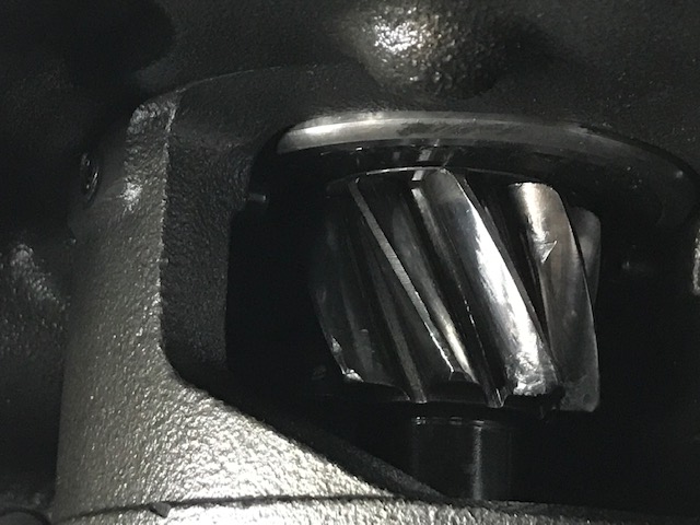

So a quick update and more questions. I have as of now, the damaged bull gear removed. It wasn't as easy as I hoped, but still easier than it could have been! I did a quickly put in the donor gear just to check the slop between the pinion & bull gear meshing. I attempted to install the bull gear completely but hit a snag. As it turns out, you have to pull the axle shaft out some to clear the splines of the bull gear as there is not enough clearance inside the rearend housing to remove the gear otherwise. In attempting to put things back together, it appeared that the gear didn't want to slide onto the splines all the way and eventually things got jammed up. I pulled it all apart again and re-installed the axle. When re-installing the axle, I then noticed that the bearing was being forced inward, into the gear housing. I'm afraid the bearing is going to be forced all the way out. I've given up for the evening, but I know I don't have a socket large enough to fit over the spines so that I can gently tap the bearing back in place and onto the splines.
So, that's where I'm at on the R&R. This brings me to a few other questions. The most important question looming over me is whether or not to replace the pinion gear or not. I already have a replacement that was sent with the bull gear. The original pinion gear t has some light scarring and a few burrs on a tooth or two. I'm going to attempt to post fotos again. I find it difficult to post fotos on this forum for some reason.
Some of my other questions are OEM paper gaskets or DIY squeeze tube stuff. The other question being hydraulic fluid filter. It is caked with very fine metal shavings. Hoye didn't seem to have a replacement for mine. Again, if I can conquer the posting of pics, there will be foto of the filter in the mix.
Thanks for posting replies and walking me through this whole ordeal this far. I don't think I could have done it without all the help, inspiration and private message help.

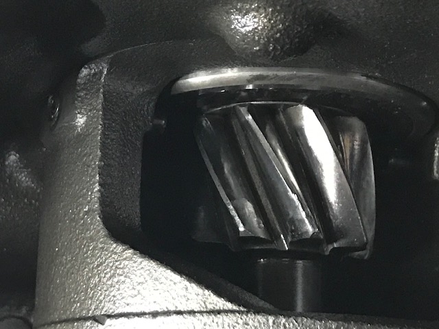

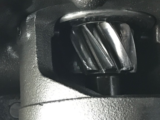

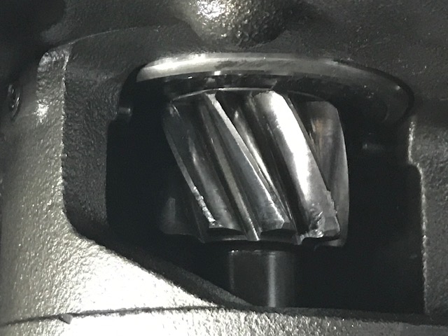

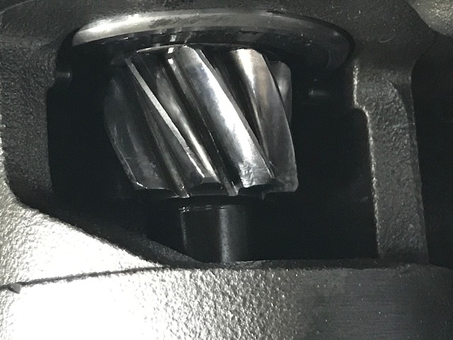

IMG_7271.jpgIMG_7270.jpgIMG_7269.jpgIMG_7268.jpgIMG_7267.jpgIMG_7266.jpgIMG_7265.jpgIMG_7273.jpg

I will start with the pinion gear. Pictures can be deceptive. I want to think I can see considerable wear down at the base of the gear teeth but not sure. Looks like a wear line that you could almost hand a finger nail on. Might be looking at a shadow.
I would use gaskets.

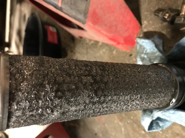

Surprised Hoye didn't have your filter screen. YM24-TRANSMISSION & PTO | YANMAR HYDRAULIC SCREEN | SOUTHERN FARM EQUIPMENT

Looking at the pinion gear I hate to say this....but I'd replace it - especially if I had a new or better one. I think that one will work, but it may not last long. Tractors take a lot of stress and I wouldn't want to always be worrying about it.
I haven't looked at the shop manual to see if there is an engagement spec. - which usually means shimming for proper ring-to-pinion engagement. But if there is, I'd be even more inclined to replace them both as a pair. And do the proper shimming. You can buy hardened shim washers by size from a machinery supply - usually McMaster Carr - although our local hardware store carries a surprisingly large stock of hard shim washers.

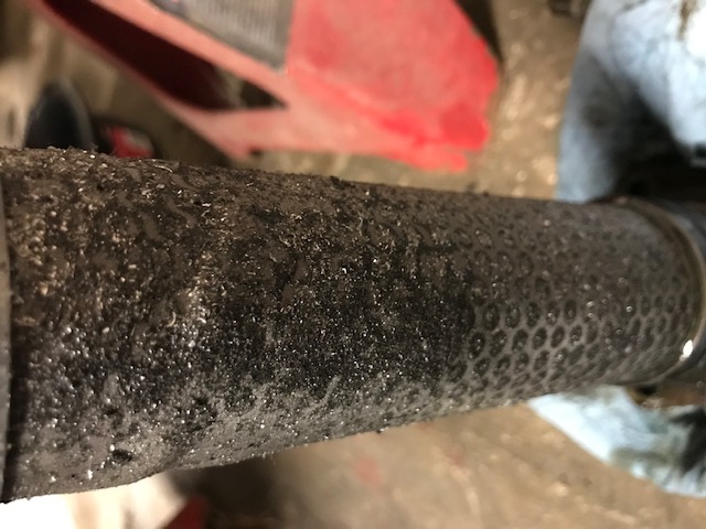

OK, nice job on figuring out TBN's arcane but effective photo posting. And I see that you found the hydraulic filter. Yep, it caught the crud and hopefully saved the system. That filter is cleanable and re-usable. BTW, so is the air filter. Yanmar's Operator Manual says to clean the hydraulic oil filter carefully in solvent with a soft brush and gently blow dry with compressed (not hot) air.
I've seen some where the filter material itself was made of wound SS filter mesh, and others that seemed to use a nylon slip on mesh cover. If I remember right, the SS mesh was #600 - this is standard filter material 0 I've posted on that before - the mest itself is available from science houses, our local hardware store, or from McMaster Carr online. if you tear the filter and need to replace the mesh just do so... don't throw that basic filter assembly away no matter how bad it looks. Clean it or repair it. Replacements are hard to find.
I'd expect that you will have to clean it again - maybe several times - in the first hours of operation after this job.
That is the only filter in the trans/hydraulic system. There isn't a replaceable screw-on filter in those older YM155/195/240 Yanmars - although the newer 3 cylinder like the YM186 & YM276 have a replaceable screw on type in addition to the cleanable one.

That small gear does look chewed at the ends, possibly even distorted? Would it probably work as is forever.. probably, it would depend on what has to be done to get it out if it we're me.
I would advise replacing since your this far though.
The filter is washable or does it have holes torn in it? Wash it with diesel.

I have a matching set of bull & pinion gear that were purchased used. I too think that even though this gear may very well last me a lifetime, I don't know that I can operate day in and day out knowing that it has potential to fail. The guy I got the used parts from confirmed for me that the pinion gear is removed from the brake housing, along with the drum and not by removing the carrier, ring gear, etc. After looking at the replacement pinion, the gear is machined into the shaft itself, not a pressed on gear like I had envisioned. I also see no evidence of it needing shimming for pinion alignment, but that will be revealed when I remove to old unit. Unfortunately, this is the side with the working brake hub, which is the passenger side. My driver side brake does not seem to be grabbing at all. Guess I'll be opening up both sides to inspect/repair. Just more work is all.

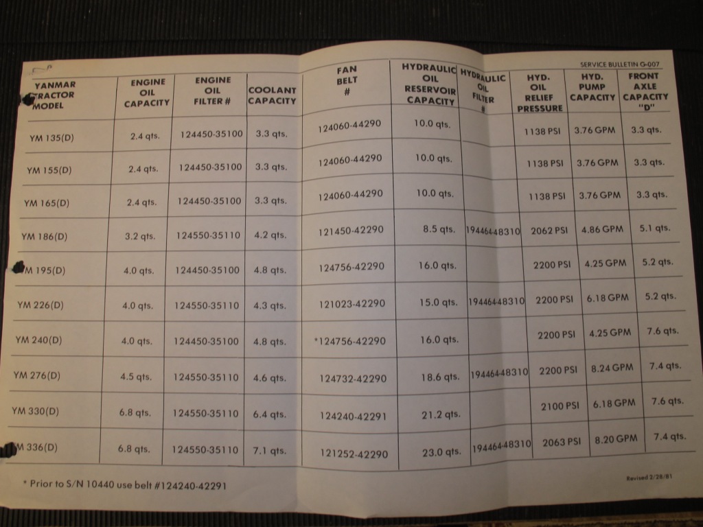

RScotty thanks for all the excellent advice in your post above and in particular thank you for posting that Yanmar capacities chart. I've never seen it before.
Everyone - download and save that chart!
I've never seen a comparison of the various hydraulic pump capacities listed anywhere before.
