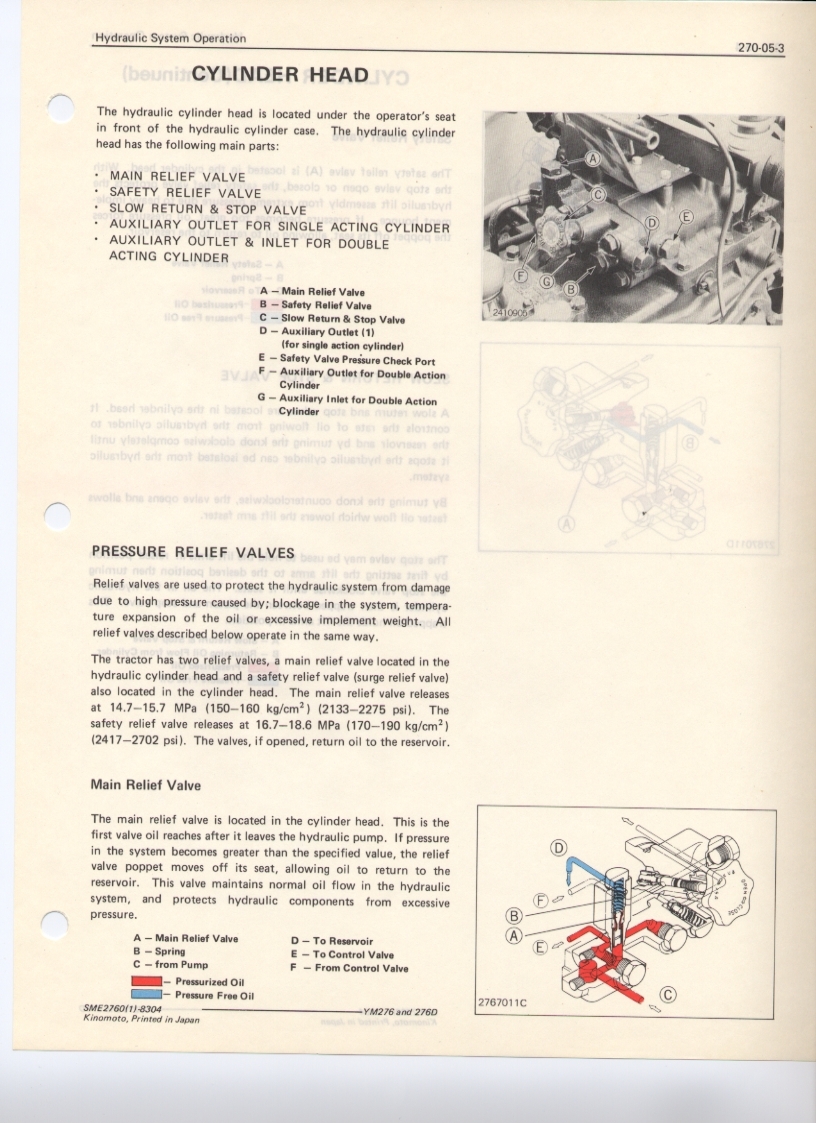

Scotty, this is what he is talking about when cutting into the high pressure line. Yanmar Front Loader Install
Yes essentially, but for the backhoe instead of loader. I would rather not use that method but if it is the only option apart from having to remove the 1/4 hex plug in the in and out port on the tractor.

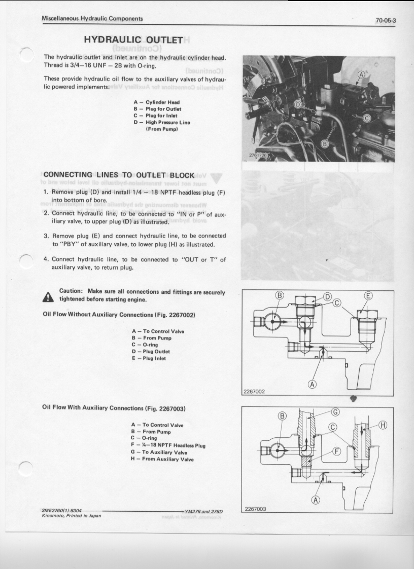

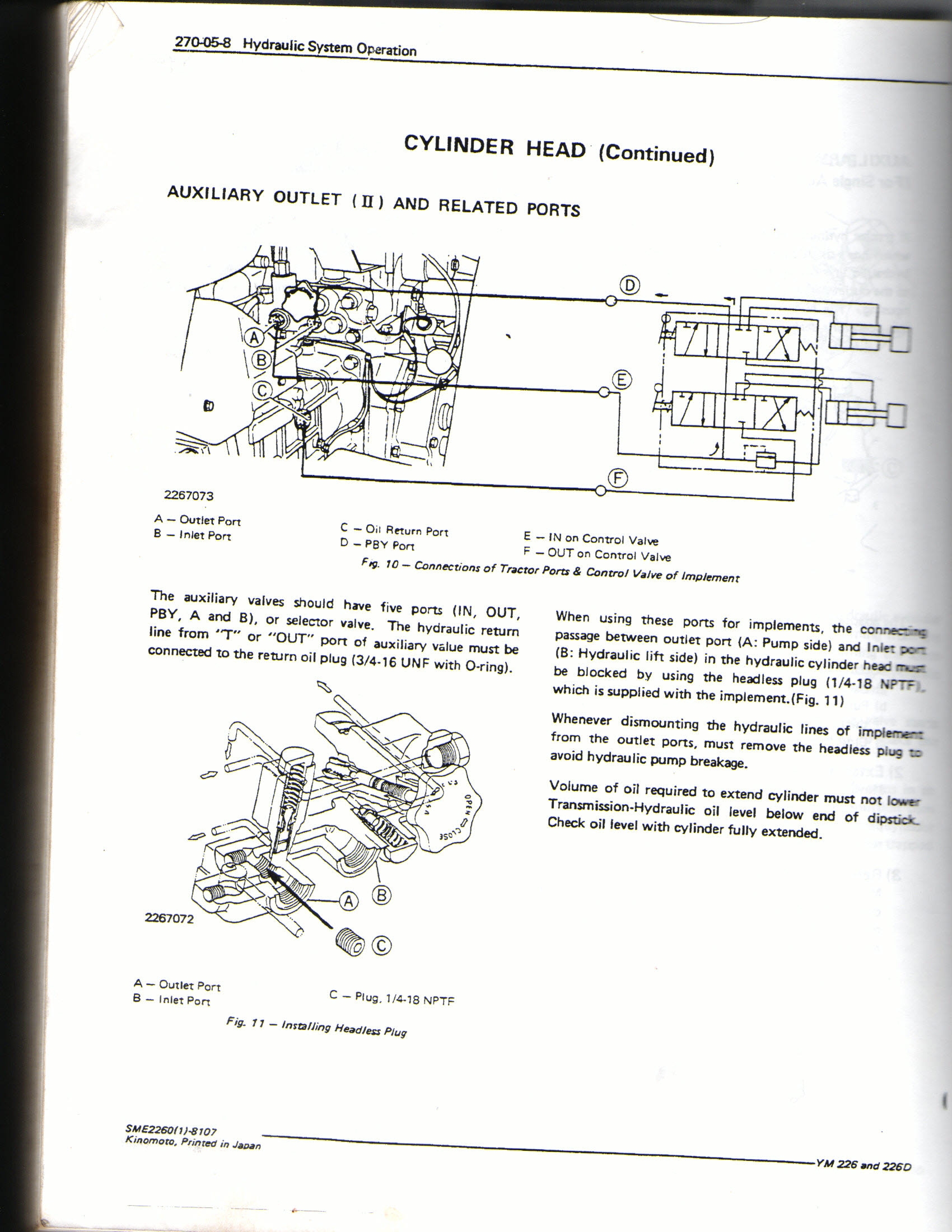

I attached some photos of the other method using the in and out port on the tractor but it states installing a 1/4 -16 tapered plug into one of them to block off a passage and if you want to go back and utilize your pto you have to remove that again. Which seems very problematic and not quick. So I was hoping someone with a bit more experience in that area would have another option. Maybe just using the out port alone with valve and then running the backhoe return line to the top of the transmission cover there is a return plug on the top of it near the shifter.

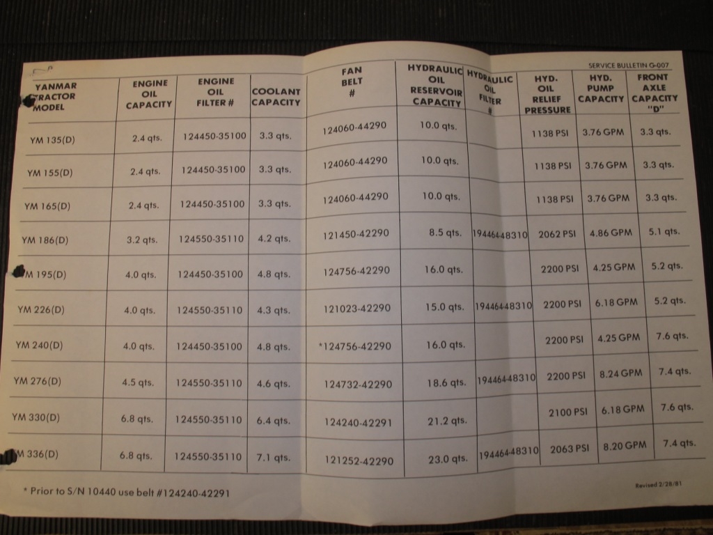

Thanks Winston. Now I see what it is, I am familiear with doing that. Yes, that method of cutting the high pressure line and putting in a selector valve is venerable. It reminds me of the way that a lot of old post WWII Ag tractors got pressure for loaders. It was real popular on Masseys, Fords, Farmalls, Deeres, & Olivers in the early 1950s. It was cheap to do - could be done by nearly anyone since those old tractors didn't run much pressure or flow anyway. A common value was 3 gpm on a farm tractor 3pt. Our old JD has the relief valve set at 1250 psi. So it is was a slow inexpensive system but sure beat the only option at the time, which was a shovel. The extra time needed to switch the selecter to go from using the loader to raising the 3pt didn't matter to farmers of that era.
The YM276D has more flow than those old tractors. It shows by my specs to have 8.24 gpm flow at 2200 psi. That should be sufficient as long as he doesn't have the optional power steering.
I've run backhoes on Yanmars in about every method. Another and nicer way to run a 3pt backhoe is to use a PTO-driven hydraulic pump and an independent reservoir mounted on the hoe. But the method you linked to will work.
Quality parts are available from several places like "surpluscenter.com". No need to use an unknown kit.
BTW, there is already a port on the YM276D for accessory flow. It does the same thing but requires a special Yanmar sleeve. I remember someone posted info on that a few years back.

Yes I posted the picture of it. But still doest really answer my question regarding the 1/4 plug it says to install in the manual and if there is another way around it. I know the pto driven pump types are easy but the backhoe I have found cheap isn't that type so that my reason into looking for options.

OK. Those pictures you posted are ones I recognize from when I used to have a full set of shop manuals. They seem very complete.
Apparently the special sleeve required on some models is not quite what is required on the YM276D, the callout says it wants a 3/? -18 NPTF headless plug (means hex key plug) to block the internal flow, and then the 1/4" that replaces the exterior plug sounds like it is simply an adapter.
So is your question that you do not know if the 3pt will still work if you tap into there for the backhoe?
I'd say it doesn't look like it will from those pictures. UNLESS, you hook it up using the IN or P plus the PB port on the backhoe control valves. That PB port is where pressure would come from for the 3pt. . Does the backhoe control valve even have a PB port? That is where you need to look. and activating most PB ports on control valves also requires that special sleeve we keep mentioning - the sleeve in the valve providing the same function as that headless plug does in the Yanmar.
And I think the backoe still needs a return line that is not shown.

Looking through the hydraulic diagrams I have a work around. So hear me out on this.... the ym276 has the auxiliary in and out port once you use the 1/4 tapered hex plug in one port to block off flow to the second port making it the return essentially and sending the fluid down to the pto. Now once you remove the attachment you typically would have to remove the 1/4 plug and cap the ports again. Since I am wanting to install quick couplers for options I am going to set it up with 3 valves and 2 T's so I don't have to remove that 1/4 plug to return flow back through the pto all I will have to do is open the cross over valve (that I will install) and close the 2 valves to the quick disconnect....I have seen those leak before. With this set up I can easily disconnect the attachment and hook up to the bushhog or tiller and only have to open one valve to use pto.... with that said after detaching the attachment you have to open that valve so that uou don't destroy your hydraulic pump.
You are referring to pto, are you really referring to 3 point lift? Not sure I am completely following you. Yes, that would work, however, I don't think you have to do anything extra. The 3 point would lift as normal at all times unless you stop flow completely and you don't want to do that.

Like Winston says, you need to re-write your "hear me out" message. I also am mystified why you keep saying "PTO" (power take off - typically 540 rpm) instead of 3pt lift and wonder if we are missing someting.
Your backhoe control valve rack will have one outlet for return flow from cylinders on the unpressurized side. It might also have a PB (power beyond) port. If it does, you can use that in coming into H so you have pressure at "a" to the next valve. Otherwise, the fluid coming into H would seem to be your return flow - which is unpressurized.

BTW, Winston...didn't you and I work on accessory hydraulics on a 276 at least once before? I've got an old file with this jpg in it - and also some other shots plus a portion of a workshop manual.
