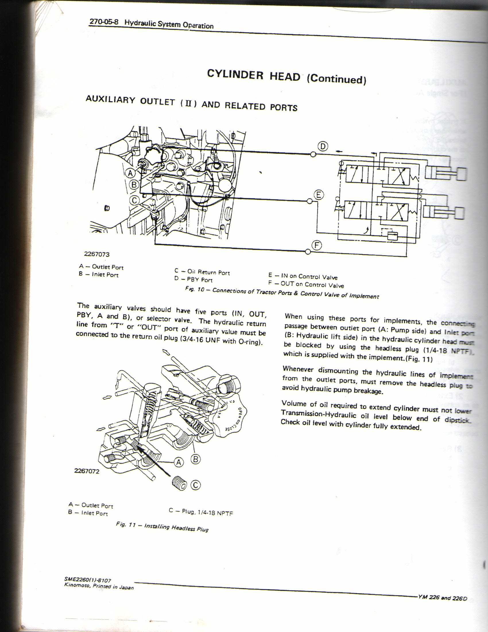

I have 3 John Deere 850,s. 2 or 3 yrs back I took the loader off one tractor and installed it on another one. When I transfered everything the loader would not work. I had forgot to transfer the headless plug. Once I did that everything worked perfectly.I am probably not making myself clear. I still maintain if you hook things up with the headless plug and bypass you have suggested then everything will work for you. It will not be necessary to remove the plug in order for your 3 point to work.
I think I agree with Winston here. At any rate, it would be simple to test and find out. Simply install the headless plug, and then install a hose loop from the primary A to B ports as shown. Then see if the 3pt will work.I am probably not making myself clear. I still maintain if you hook things up with the headless plug and bypass you have suggested then everything will work for you. It will not be necessary to remove the plug in order for your 3 point to work.
