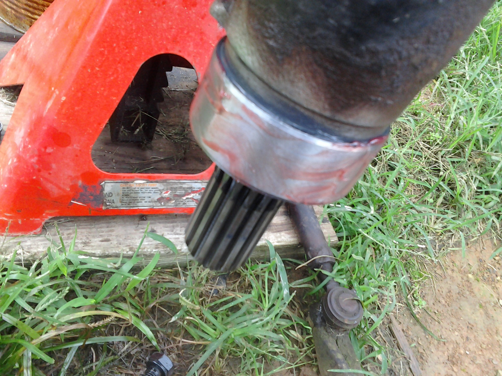

Anyone have any experence with using a repair collar to renew the seal suface on the front wheel spindle. I have ordered some from Hoye. Anything special I need to know.

watch the outside diameter on the spindle, not sure what your ser # is but I had a difficult time with the sleeve fitting over the spindle, got leaks on both sides ? If you end up w the same problem, there are tighter fitting seals that work well, also check the tower that the spindle goes up into to make sure it will accommodate the sleeve....

Received the seal collars today and they look to be a perfect fit. Should I put RTV on the spindle before I put them on. The collar has rubber seal material inside of them.
   / YM336D spindle collar repair

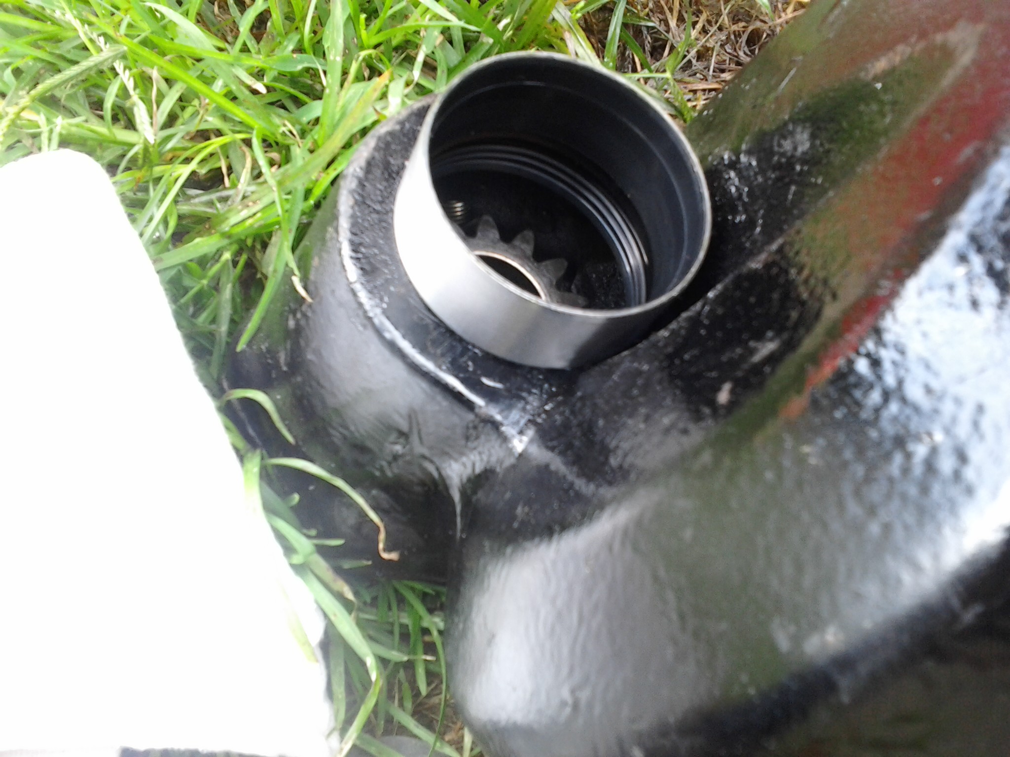

Started the repair today and everthing was going good till I discovered the new repair collar is a larger diameter than the opening in the drive housing. The bad part is I had allready installed the seals. I think I was able to get the seals out with out damaging them. yanmar 010.jpgyanmar 010.jpgyanmar 010.jpgyanmar 011.jpg

The seal collar has rubber seal material iside it. Had to clean up the old seal area with brass wheel and 320 crankshaft cloth seem to fit very well. After you installing the collar the opening in the drive gear housing is to small to go over it. Going to take it to a machine shop and have it drilled large enough to pass over the seal collar. The seal collar is 64mm and I dont have any way to bore something that large.
   / YM336D spindle collar repair #10
Well, If I have to have the front gear case housing bored so that the bushing will fit. I'll just put up with the weep. You will most likely have to take all the gears out of the gear case housing to have the hole bored out
