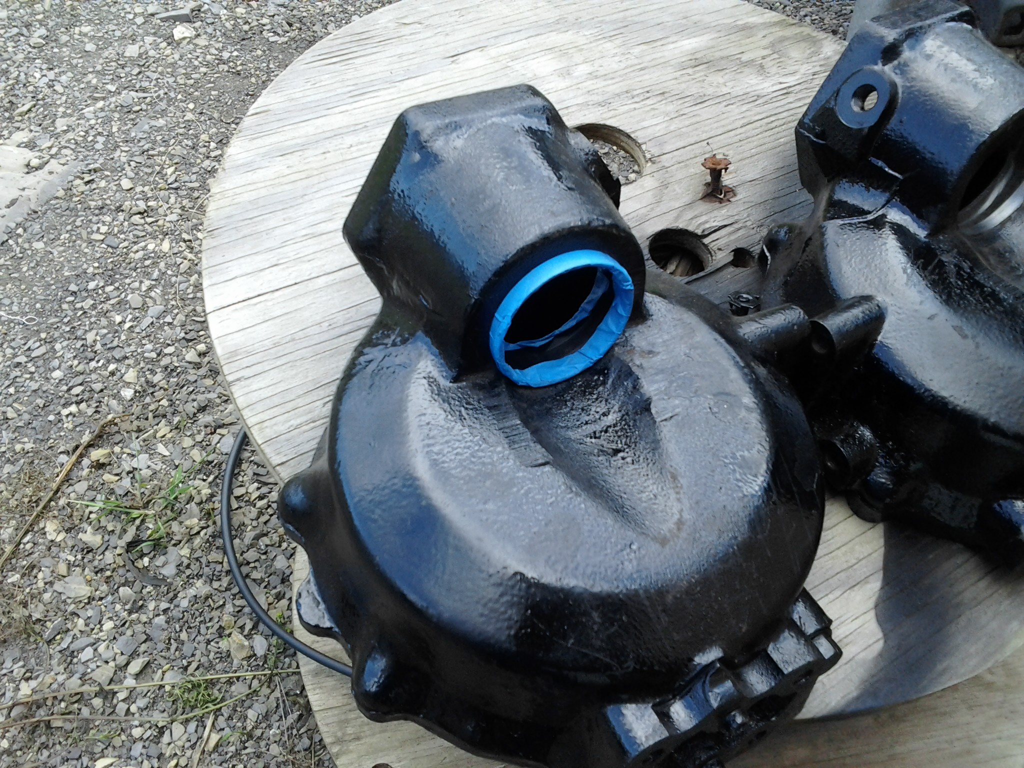

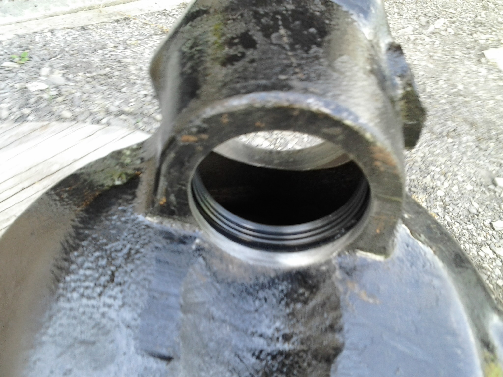

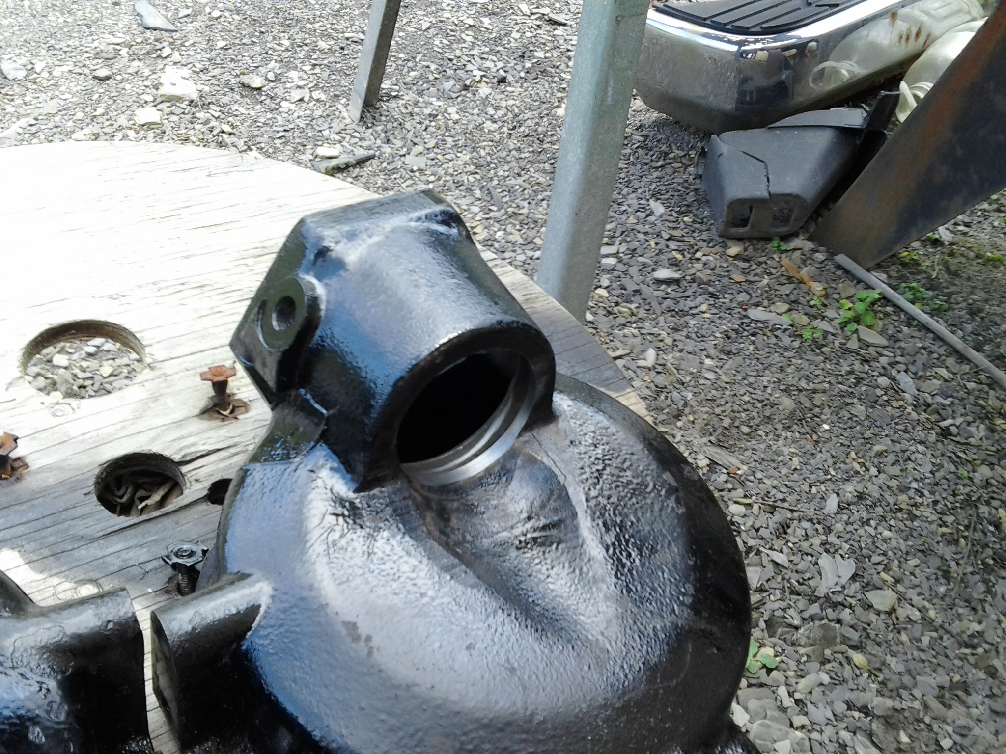

007.jpg007.jpg008.jpgGot the housings back today.Got it put back together right as it got dark so I thought I would let it sit over night before I finish filling it with 90w. I took some pictures. One is of the housing showing the boring job.One is showing the housing with the sleeve inserted showing how it fits and the other is the housing with the seal installed.Everything seemed to go together good. I'll check it out better tomorrow.009.jpg009.jpg009.jpg

I hope that solves the problem.... When I replaced my seals. It took a couple months of operating B-4 they started weeping again.... I hope this fixes yours.....Mine isn't really that bad
   / YM336D spindle collar repair #37
Hey RB-
Repair and machine work look awesome, nice repair and that's the only way to go - Keep us posted when she is all together on how its working-
From CT
#38
I haven't had time to work the tractor yet but did run it around for about an hour and everythink seems fine. No leaks so far.Going to mow some pasture this weekend. If it ever has the problem again it will be an easy repair the next time.
