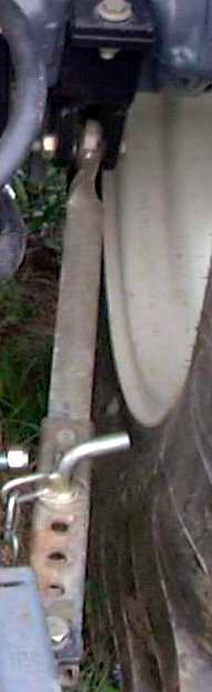

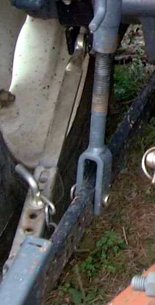

Here's a couple of photos of both my stabilizers. They are the slickest stabilizers I've ever had on a tractor. After fighting and destroying several of the old style fixed stabilizers and the turnbuckle type over many years, these are easily my favorite.
Are they cast iron? No, not at all. Can they be damaged? Yes! Are they stronger than a similar sized Massey Ferguson? Don't know...maybe not. Do I love this design? You betcha'!:)

Cowboy, the stabilizers are designed to keep implements centered, not to take high stresses. Any ground engaging equipment should be disengaged before turning the tractor, or it will stress the stabilizers (and the entire 3PH). Rubbing hard against trees while bush hogging can also stress the stabilizers.
I hear you on the low strength metal. Having spent a career dealing with metallurgy, I am often disappointed by the misapplication of metals. However, as someone mentioned, we wouldn't want this part to be made from 100K yield strength steel. We certainly wouldn't want the rear casting brackets to fail instead of the $54 part. Maybe the part was made from dead soft steel like 1018 CRS when it should have been made from a slightly stronger grade. I wouldn't be surprised, because I've been victimized by the inappropriate use of dead soft metal in a loader bucket.

i have a box scraper on the back of my tc33d with the same stablizers and i beat the death out of it backing up and destumping and pushing stuff backwards and pulling stumps out and huge rocks and beat it to death and my stabilizers look like new. A person would have to do way more then tractor was designed for to break one UNLESS it was a defective part which may have happend to LC since he has such bad luck. I think they are plenty stong and i have yet to bend or break one and i am hard on equipment.
