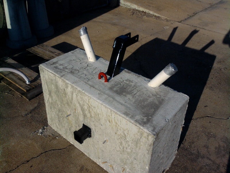

Do you find that shovel handles or rakes or whatever stick too far out the bottom? Could catch the ground, or brush in the woods and break a
handle? If I was doing a design like that, I'd probably but some expanded metal or something in the bottom so none of the handle sticks out
Since I don't have this creation, I am just guessing. I think they just put a small hole in the bottom of the capped plastic pipe to let water out. :confused3:
   / You need balast or you will trash your front axle!!!! really? #343
Yes, when I installed the PVC in the form, I just let the cap touch the bottom of the form, the tubes where tied to the rebar inside the forms to keep them from slipping. After I removed the forms and let the block set up , I laid it on its back found where the tubes where under the surface and drilled a 3/8 hole. The tubes are still just above the bottom of the block.

Here is a pic of the back side, i also added a receiver tube just in case.
I screwed a 5/8" lag bolt through the bottom of my form and into a PVC cap for the pipe. The lag bolt held the cap off the bottom be 3-4" and held the pipe in place during pouring. After the concrete cured l just unscrewed the bolt out of the bottom.
I didn't want the cap resting directly on the bottom because I thought I'd eventually bust through by dropping tool handles in there.
Just another way to skin the cat.
