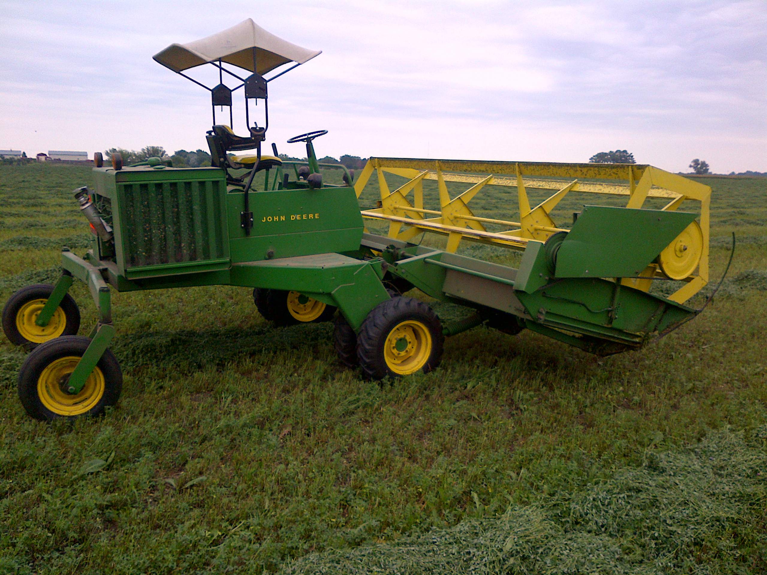

1972 Deere 800 windrower (bought it restored!)

OK, help me out here. Is the JD 800 basically a small combine?
I've never seen anything like that down here.
   / Your Hayin' Rigs: Let's see 'em and let's hear about 'em! #43
They are known by a few different names: Swather or Windrower. They are basically a self propelled sickle mower. There is a 14' or 16' sickle up front, canvas on each side feeding to the middle to create the windrow. The Wheel on the front brings the plant your cutting across the sickle as you are moving to assist in the cutting. Some have crimpers that are attached to the head, mine doesn't have that. They were used heavily in the small grain days (Oats, Barley as well as Alfalfa, etc.)
They are still in production (not the JD 800, but the self propelled units). Today, they have disc's on the front instead of sickles in many cases.
Here is a modern version with cab and disc for the header:
http://www.tractorhouse.com/listingsdetail/detail.aspx?OHID=8221789
The 60's and 70's models usually get abandoned in favor of disc mowers, MoCo's, etc. I picked mine up for $2000 all restored and will use it until it starts costing me money. Then I'll move to a MoCo or something disc related.
Hope that helps.

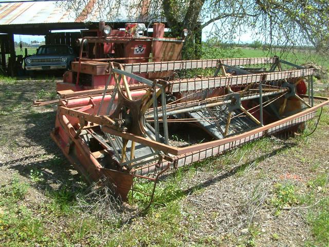

My neighbor has an old Massey Ferguson swather that is very similar to that JD800. He's been trying to give it to me for 4 or 5 years. It needs an engine rebuild as well as maintenance on the sicklebar, the reel and the curtains (also called drapes). I've been holding him off since I have 5 old tractors that need to be worked on first.
Here's a photo of that swather. You can see the big reel, the sicklebar cutter and the two drapes (the black things behind the reel).

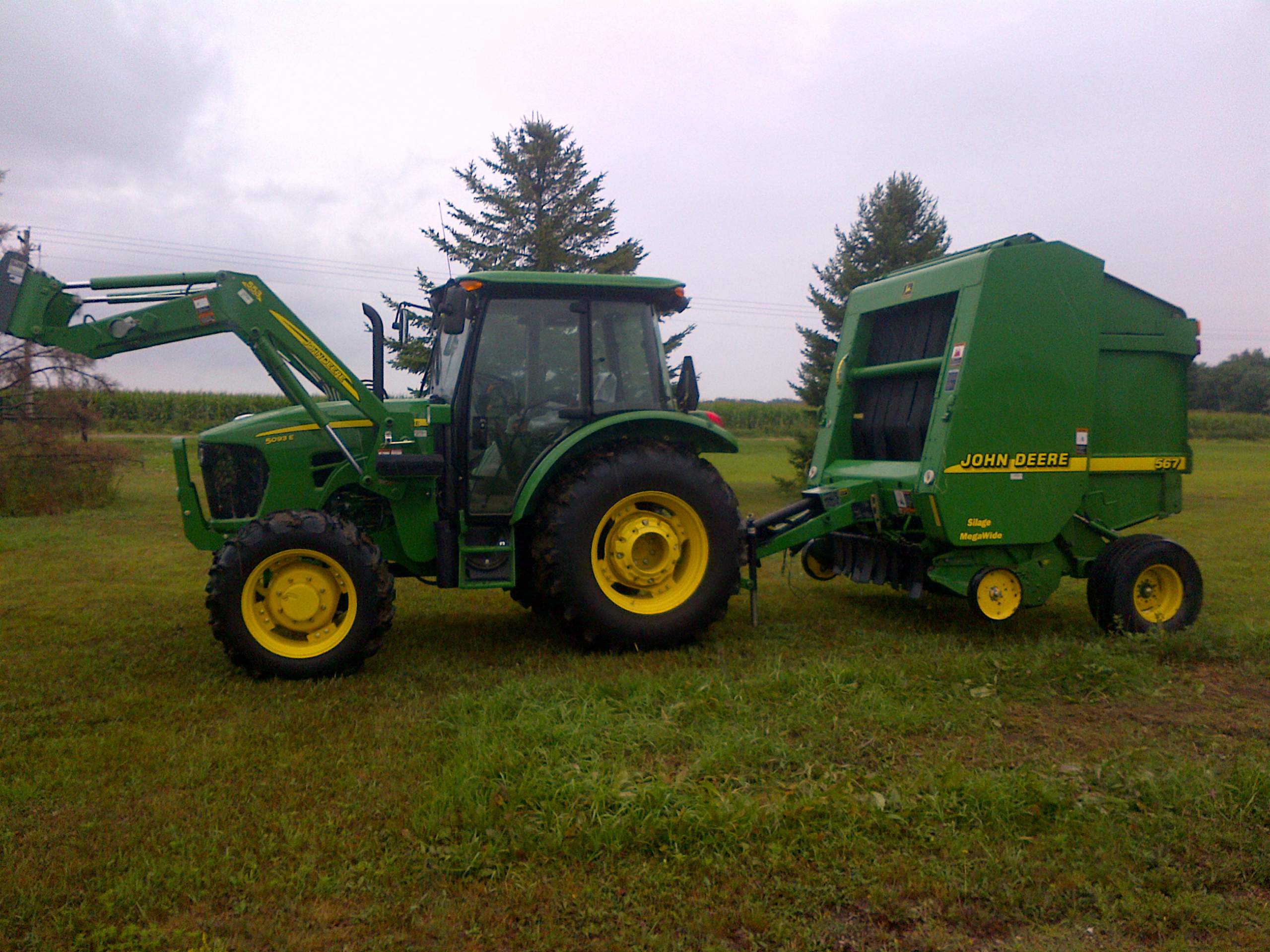

Birds Eye View from the wagon. New to me in the last year, JD 5520 pulling a NH 565. This is a definite upgrade from my original rig which was a JD 990 pulling a NH 68 Hayliner.
Life is a lot better in a cab with AC!

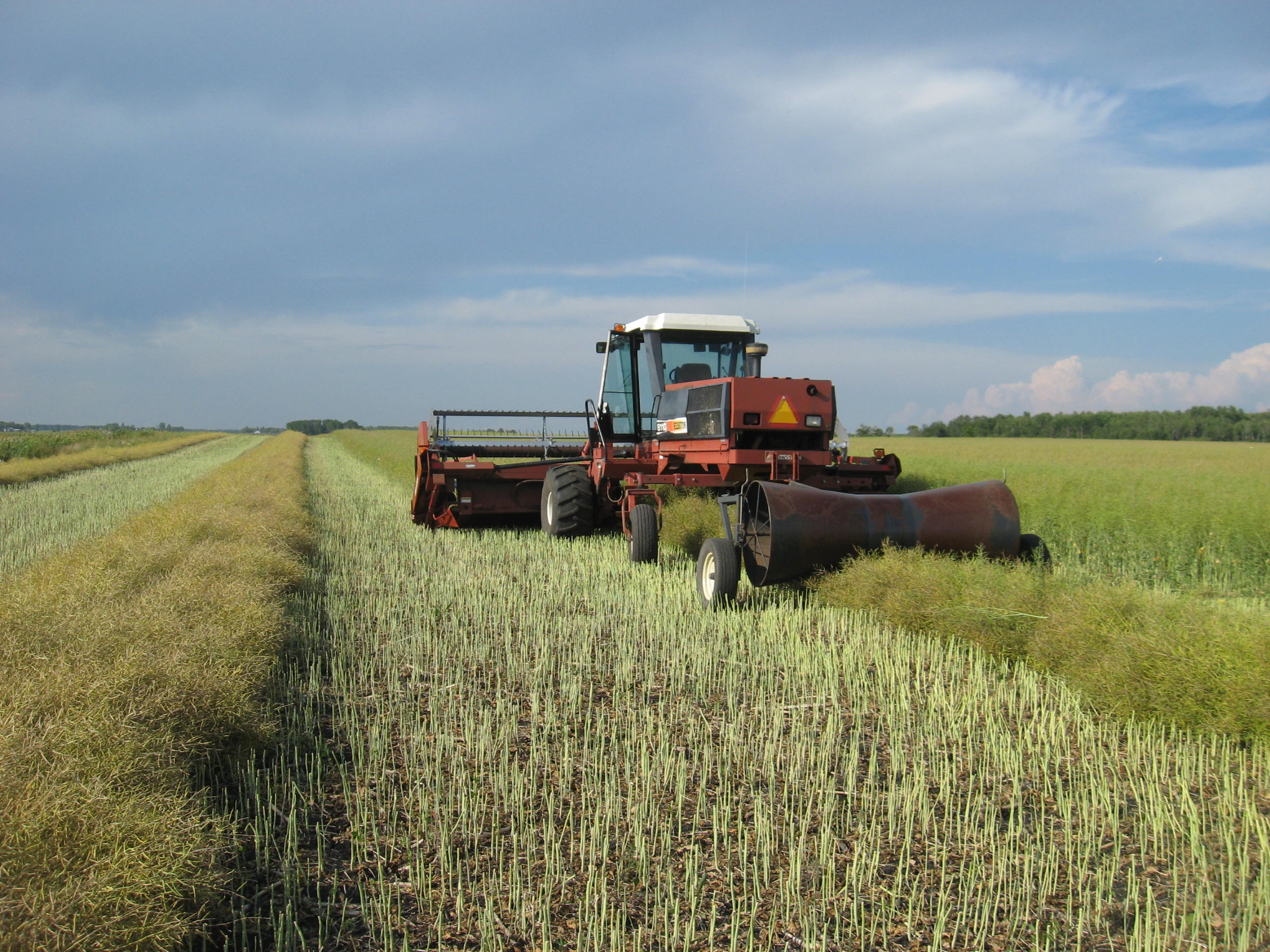

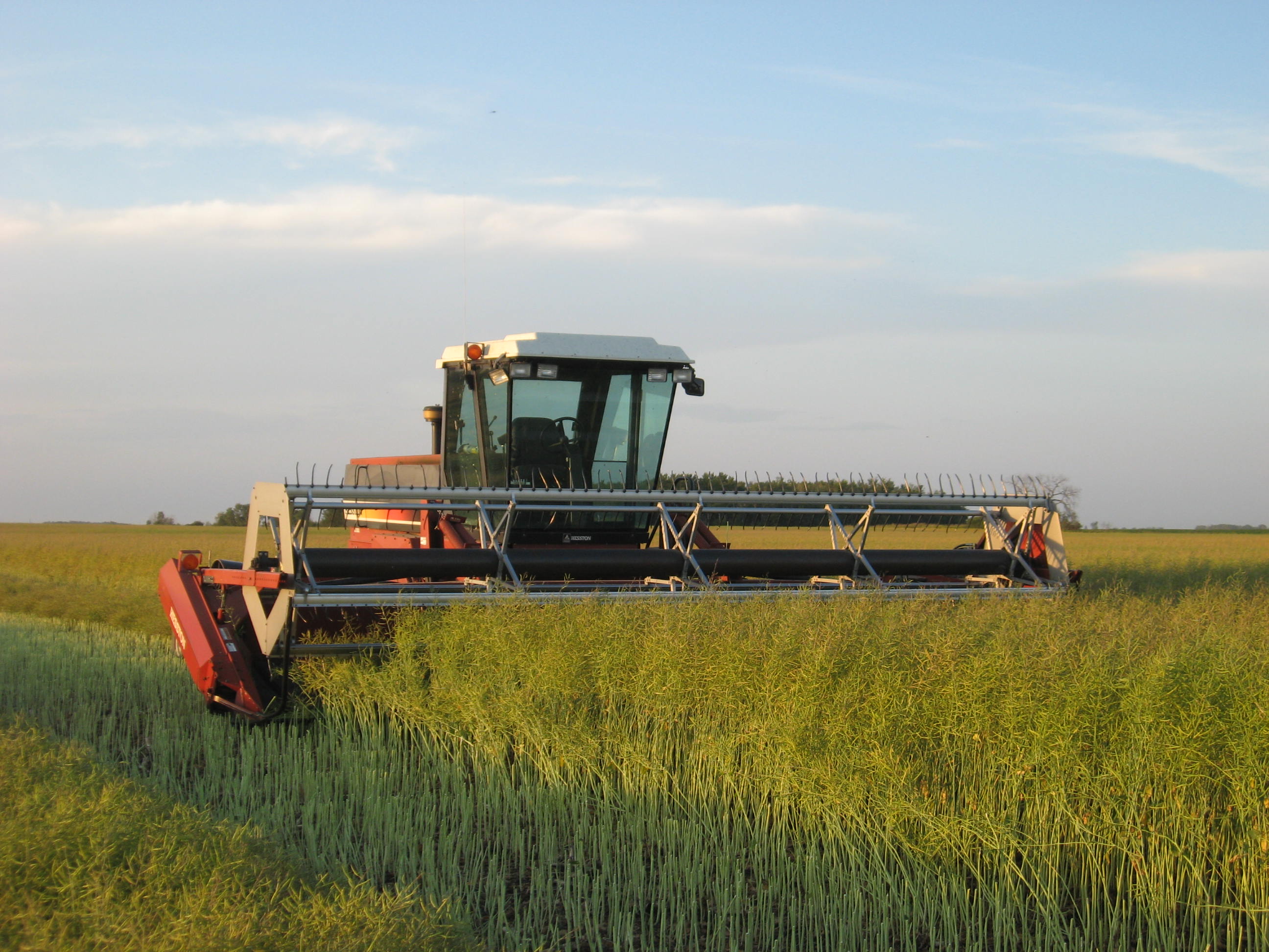

Untill 10 years ago all crops were swathed but spraying with roundup then straight cutting has become more popular for most cereals . Swathing is still necessary for canola and I prefer it fo oats too as grain is often lost waiting for it to dry enough to straight cut .
