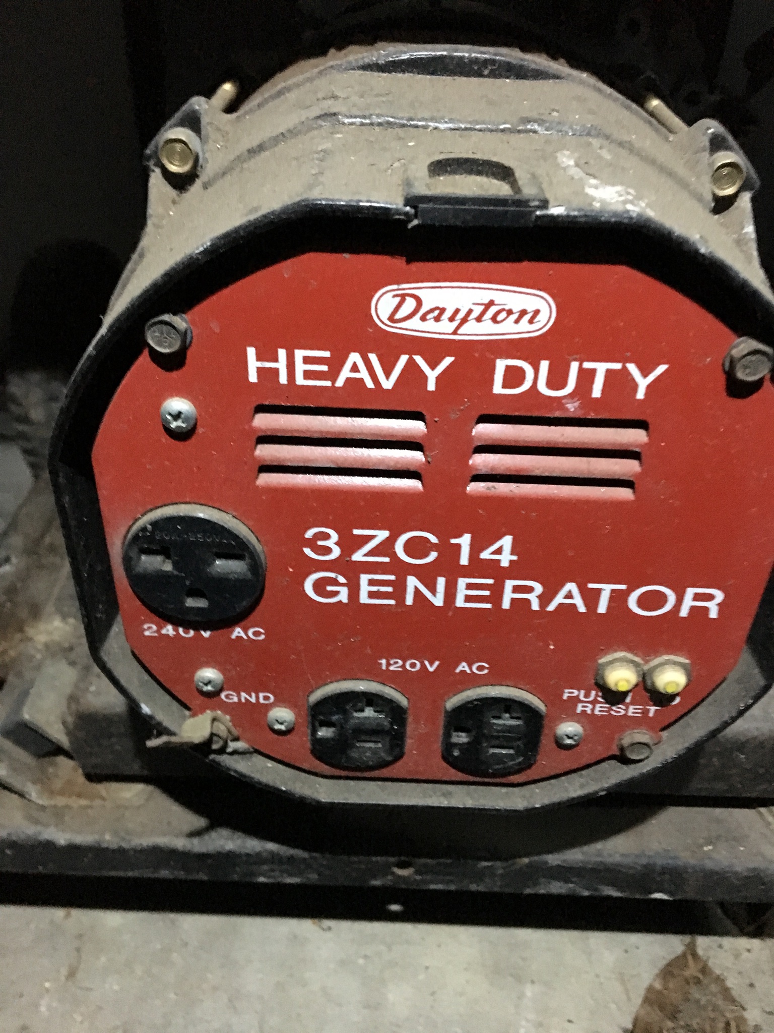

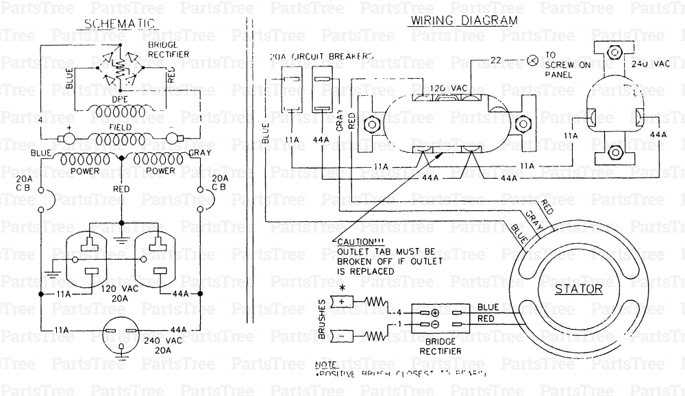

Update on my situation, after much research, it seems my generator has TWO capacitors. Both test good at rest, replacing them both anyway as cheap insurance.
As mentioned previously, this generator is bonded neutral, and they did it in a very annoying way. Rather than bonding at one point, EACH RECEPTACLE is bonded! That makes it more difficult to change, but easier overall since I’ll never use the 14-50 outlet for anything besides powering my home. So I’ll just rewire that outlet to remove the bonded neutral and leave the rest as they are.
That's a big negative there & not in the voltage sense. If neutral & ground are bonded anywhere on the generator, they are connected everywhere on the generator.
Unless each outlet is somehow isolated, bonding on your little 15@ outlet will also be shorting neutral to ground for your 50@ outlet. Only with wire rated at 15@, not 50@. Also that neutral or ground wouldnt be protected by a breaker (not that you ever should have a fuse or breaker on ground).
You would need to remove every neutral to ground connection on the generator. I'm not completely certain of the implications on doing that though.
You could just make a plug to connect the ground pin to neutral for your 50@ socket & plug that in to bond for stand alone operation.

Safety ground should never be used except in case of system failure. It provides a means to return power to earth & trip a breaker or fuse.
Neutral & ground should be connected (bonded is the electricians term) only a the main breaker pannel. That way power flows through properly sized neutral wiring. If you connect neutral to ground in multiple spots you can get ground loops & power flowing in ways & directions you do not expect.
Both neutral & ground are connected to the ground rod hammered into the ground. But only in one spot.
