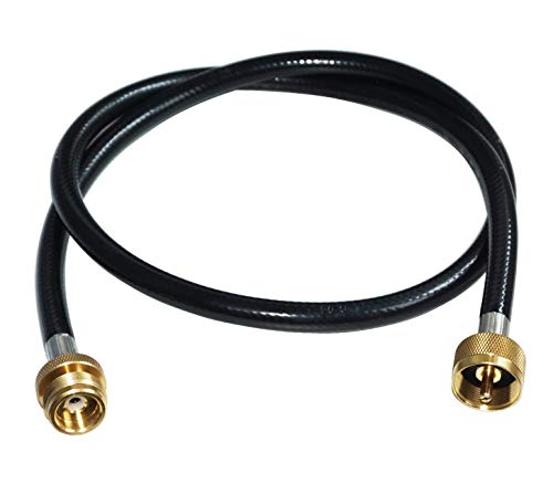

I should make up a propane torch head with a three foot hose and some kind of clip at the end. It is always a two person operation to hold a torch into the intake and the other pulls on the starter.
Here is a $10 4' extension hose for a disposable 1# cylinder: https://www.amazon.com/DOZYANT-Distribution-Extension-Assembly-Throwaway/dp/B06Y678C2P/
attachment.php
And a $20 12' adapter to connect a torch that would normally connect to a disposable cylinder to a 20# tank: https://www.amazon.com/DOZYANT-Converter-Replacement-Certified-Appliances/dp/B01N1H6LVD/
attachment.php
