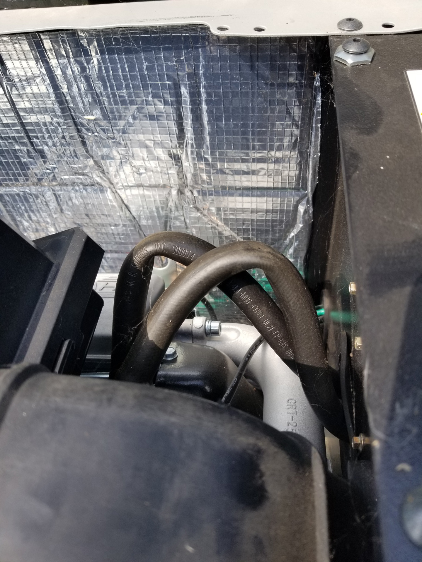

I had a funny call the other day. a guys generator wouldnt start. I went to look at it, and sure enough i could not get it to start. it was only 1 year old. I started to check gas pressure and noticed that both internal fuel lines inside generator coming from the fuel regulator were kinked. They weren't like this when i installed the unit. i started to move the hoses and noticed that as i pushed them back towards regulator they rounded out again. It appeared as if they were too long and had moved as the weather got hot and the hose softened up. I was going to remove and trim hoses, but instead i found i could push them back in and zip tie them internally to a solid intake shroud by motor. now they are nice and round and cant move anymore. The unit fired right up. Im hoping that this was a fluke. I looked at another unit i have in stock and the lines had no movement to them. now i have to add this to my check list during service calls in the future. hose.jpg

Great point grs..... while the pressure rating may be relatively low on that hose, still, surprising that they would kink that easily....

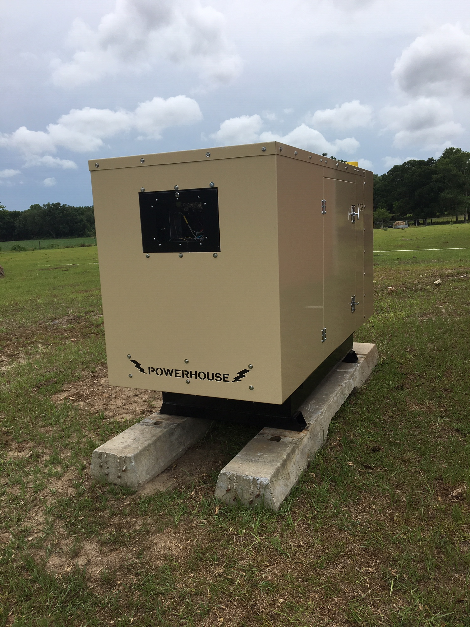

I programmed my first deep sea controller model 7320 MKII you plug your laptop via USB port build the profile then upload it. I printed the file 58 pages of different parameters alarms etc. It can do anything you've ever dreamed about doing. Also did some rewiring on the genset the builder didn't keep ground points under control, and I moved the glow plug relay closer to the batteries and glow plug rail. Also replaced a lot crimped joint with soldered and heat shrink.
Well played. That's evolving into a very solid build. It's great when you can get something set up exactly the way you want......
Interesting controller. Most everything has a lifespan to it, but I'd like to think (barring insolvency, corporate buyout....) that a generic controller for wide application has a long replacement availability. Nothing worse than being shutout of the replacement market, Just Because... they'd rather sell you a new complete machine.....
