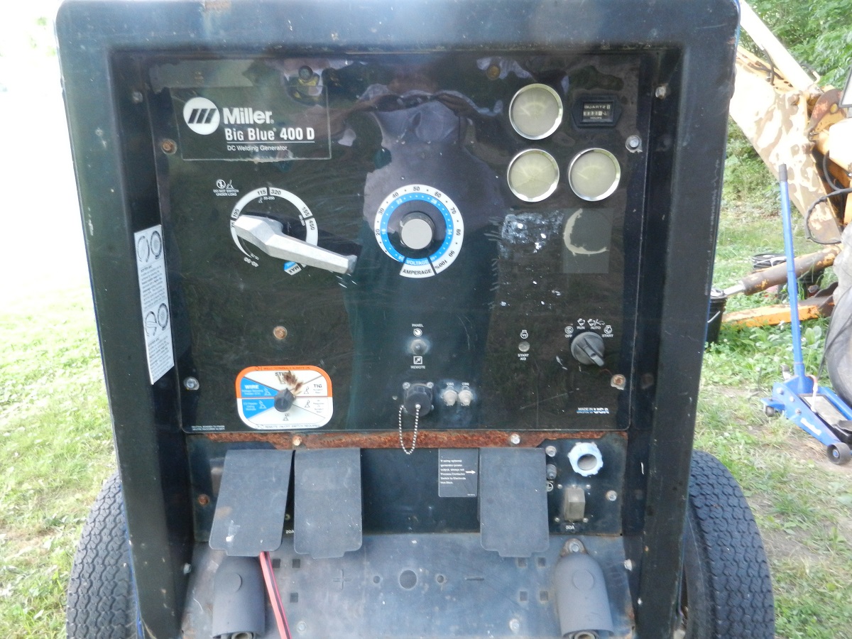

Speaking of generators.... my brother in law currently has a Miller 400 welder (diesel engine) and it's on a trailer. I understand it can also duplicate as a generator.
He's asking $2,500 and if I recall, It has 5,733 hours on it.
Runs smooth as a watch, starts "right now" and welds like a champ (been using it on my backhoe)
What I'm wondering is..... would that be a worthy purchase for someone who:
a: Would like to possibly get a welder for himself (but has NEVER done any welding and would need some training/education)
b: Would like to get a generator (but currently has NO provisions in the house to easily plug this in)
He bought it at an auction, it was originally owned by...SunBelt if I have the correct name.... it was originally painted green and someone painted over the green to make it Miller Blue.
Edited to correct hours to what's on machine and add picture. (it's GREEN under the blue pain)
It's a Miller Big Blue 400-D, BIL is asking $2,800
Thoughts? (should I buy it, have my generator and figure out how to weld later?)

I'd say it depends how badly you want to learn to weld, and need that capacity.....
considerations....
What is the rated hour lifespan on that engine, it's getting up there......
What are your intended uses for the generator....... do you need something more portable or quieter ?
That kind of money can buy you a really nice brand new generator, and if you don't need to regularly weld very thick steel, new welders (OK, non-Miller) aren't big $ today.
Just one example..... if you don't need/want ultra-quiet, this Generac has decent household capacity, and is EFI.
Generac Power Systems - Best Portable and Inverter Generators
Rgds, D.

That Miller is an excellent welder and a decent generator,
depending on the age they have used several different engines.
I believe that they only turn 1800 rpm to make 120/240 volt power.
If needed you can have power while welding.
They can be equipped to perform most types of welding including TIG and wire feed as well as stick.
As far as portability its trailer mounted so it can go most any where it's needed.
It is not a real noisy welder/generator

Current Miller spec sheet shows that as a 10kw (continuous) generator.
https://www.millerwelds.com/-/media/miller-electric/imported-mam-assets/spec-sheets/1/9/0/ed57-big-blue-400-pro--english.pdf
Also listed as 1800 rpm. db specs out (different engine options) under 70db, so just spinning up a hand held grinder, it would pretty much have just been idling. (note that light duty gens often spec sound in dba, not db, so it's not quite apples/apples when comparing - "a" is weighted to follow the human hearing curve). General FYI - most light-duty gens run at 3600 rpm, so dropping to 1800 buys you quieter right there.....
Interesting specs...... you can weld @ 300A and still also pull 4500 watts out of it. No idea if/how specs have changed since yours was built though.
If you are sold on going diesel (I can guess some of the motivations...... here I can still access EFree gasoline), then consider doing a load test in at least the 8-9 kw range, and also draw an oil sample for testing. Guys in this thread and others have done amazing rebuilds, but it would suck to drop that kind of money into something to find out later it's got a cracked head.....
You may already be far enough down this road to know, but modern diesels and ULSD are often way more finicky than the squeeze-bangers of olde......... (maintenance and prompt attention to any fault light are critical).
The unit you are considering may be old enough to be pre-emission, and therefore simpler.....
