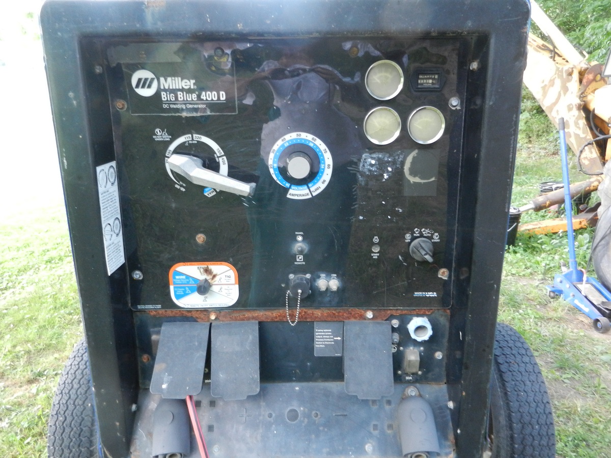

Speaking of generators.... my brother in law currently has a Miller 400 welder (diesel engine) and it's on a trailer. I understand it can also duplicate as a generator.
He's asking $2,500 and if I recall, It has 5,733 hours on it.
Runs smooth as a watch, starts "right now" and welds like a champ (been using it on my backhoe)
What I'm wondering is..... would that be a worthy purchase for someone who:
a: Would like to possibly get a welder for himself (but has NEVER done any welding and would need some training/education)
b: Would like to get a generator (but currently has NO provisions in the house to easily plug this in)
He bought it at an auction, it was originally owned by...SunBelt if I have the correct name.... it was originally painted green and someone painted over the green to make it Miller Blue.
Edited to correct hours to what's on machine and add picture. (it's GREEN under the blue pain)
It's a Miller Big Blue 400-D, BIL is asking $2,800
Thoughts? (should I buy it, have my generator and figure out how to weld later?)
I didn't look at the specs but if it will do a continuous 10k that should be a decent value.
If you buy it you will want to build a load bank to give it a good load every now and then to prevent wet stacking. Diesels don't like to be under worked.
I have a military surplus that is diesel and rated at 10k continuous. I run it for an hour every month with a 10,800 watt load. I built a load bank with a 120v fan and 240v 5400 watt dryer elements.
