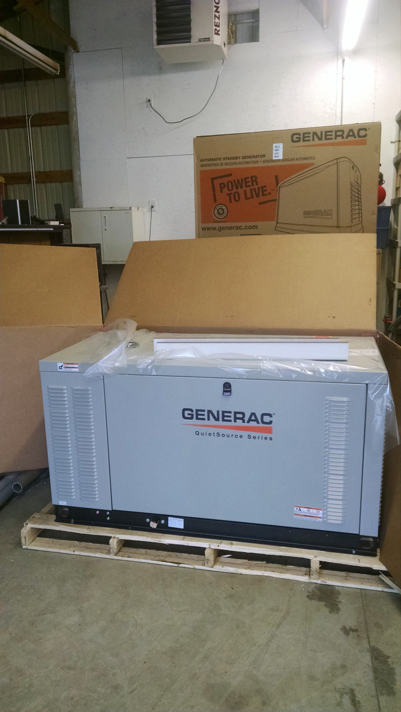

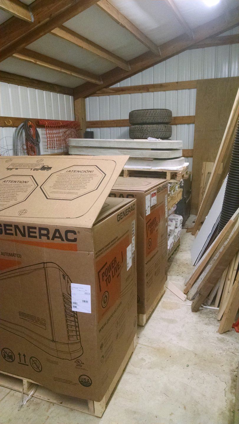

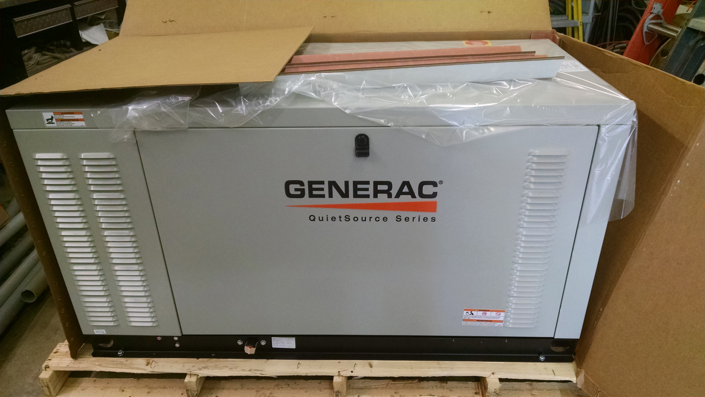

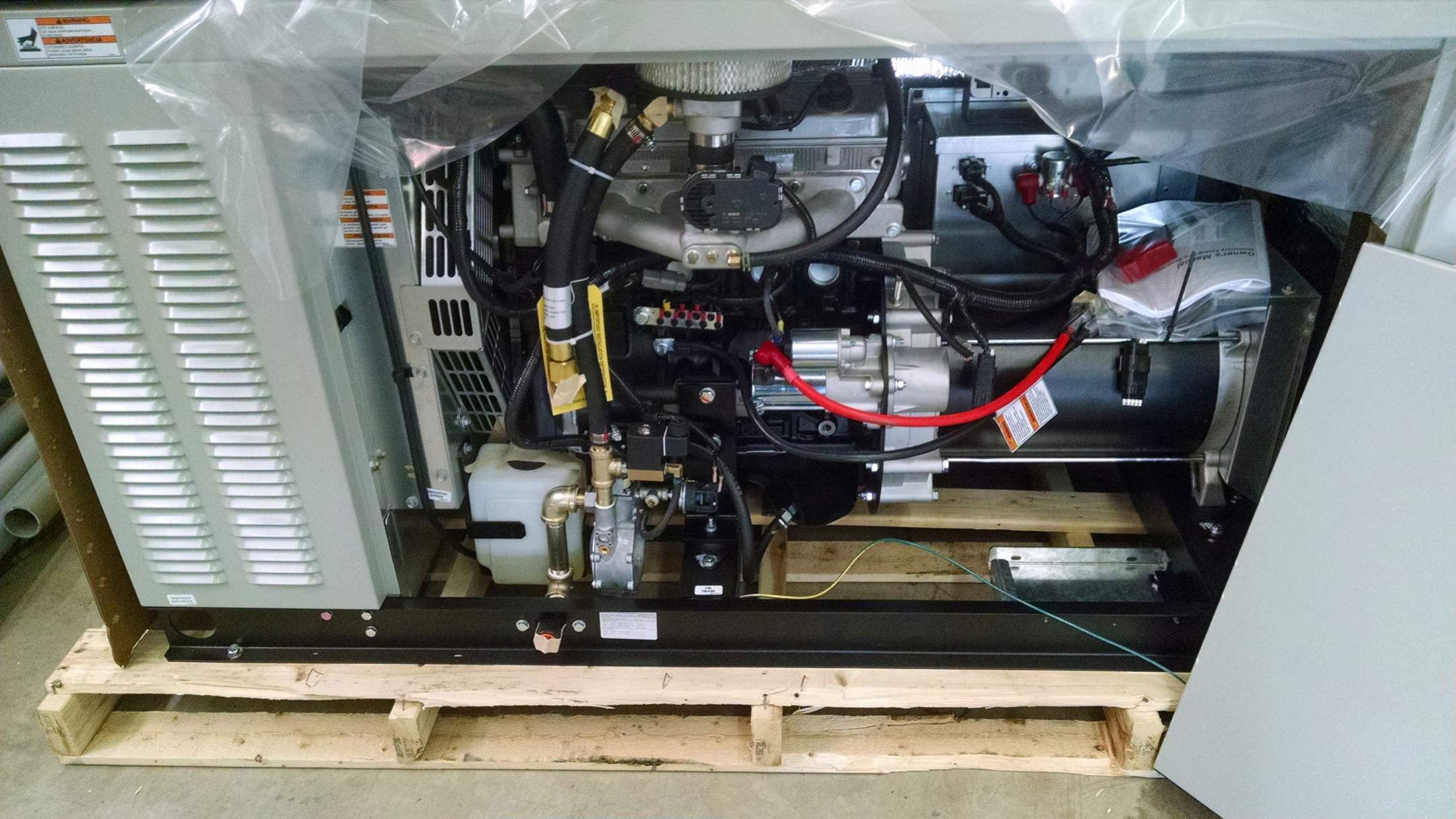

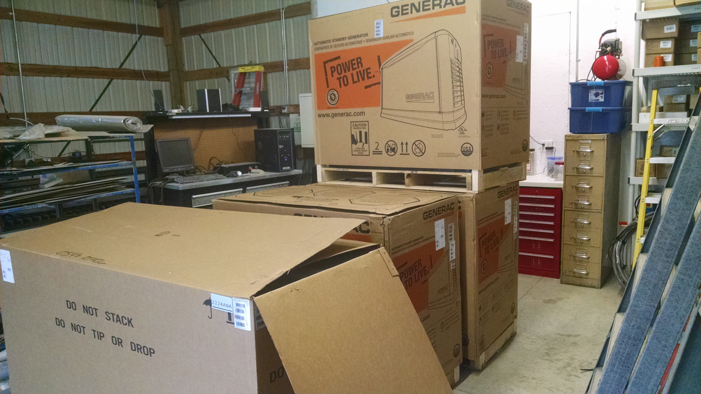

not much to do with generator maint, but the weird weather has caused an increase in people hiring me to install generators. i just got 6 units in yesterday, including a new 22 KW quietsource liquid cooled unit. This is the first 1800 RPM quietsource unit ive had to install, and looking forward to hearing it run.
Ive heard the 36 KW quietsource operate and it was amazingly quiet.
I want to replace my current unit with this exact similar unit next year. I do like the fact its an automotive style engine and liquid cooled. plus 1/2 the RPM.
heres a few pics.

I look to you for my real life in field generator reviews...
Always prefered 1800 rpm units which just about disappeared here in California... many of the best units I was sourcing a few years back could not be sold or serviced in California...
Very interested to get your perspective after it is up and running... quiet is becoming very important in residential zoned areas.

calif is a hard market. Generac does offer CA/MA approved units. the quietsource units qualify. Some also come with Catalyst and SCAQMD rated.
Luckily here in Idaho...we dont have to worry.
I also like that the liquid cooled units have hydraulic lifters.
Generac has been upgrading their liquid cooled units from the older nexus controllers (which have operated very nicely i might say) to the more current Evolution controller. The evolution controller has been used in air cooled units for several years, and is nearly bulletproof as far as service reports go.
The new controllers allow more service tech adjustments and also allow for firmware updates.
Im waiting till the 22KW units are upgraded to evolution controllers, then im switching my house unit. Ill take my current house unit and move it to control the shop which currently is operated with small manual gen system.
Im a service rep for generac, and i dont get called out to any of the newer units (after 2010). except for occasional valve adjustment and annual maint request. The older units (prior to 2010) have had some issues, but most of the problems i find are due to non existent owner maint. I got called out awhile back on 2 whole house units at a Bed & Breakfast outside of town. power to units were out due to heavy storm damage to powerlines. They were upset cause neither generator fired up. I opened up both units...and batteries had exploded in both units. both units also showed no oil on dipstick. I was able to manually rotate engines so they wernt frozen. i did total service on both of them. These units hold 1.8 qts of oil. i got maybe a cup of oil out of each. this was after using compressed air to empty unit. Replaced everything, set valves, replaced batteries...they fired right up.
Units were 5 years old...and never looked at by anyone. Owner couldnt even find the keys. these kinds of people shouldnt even be allowed to own anything with an engine. i can imagine what their cars look like.
