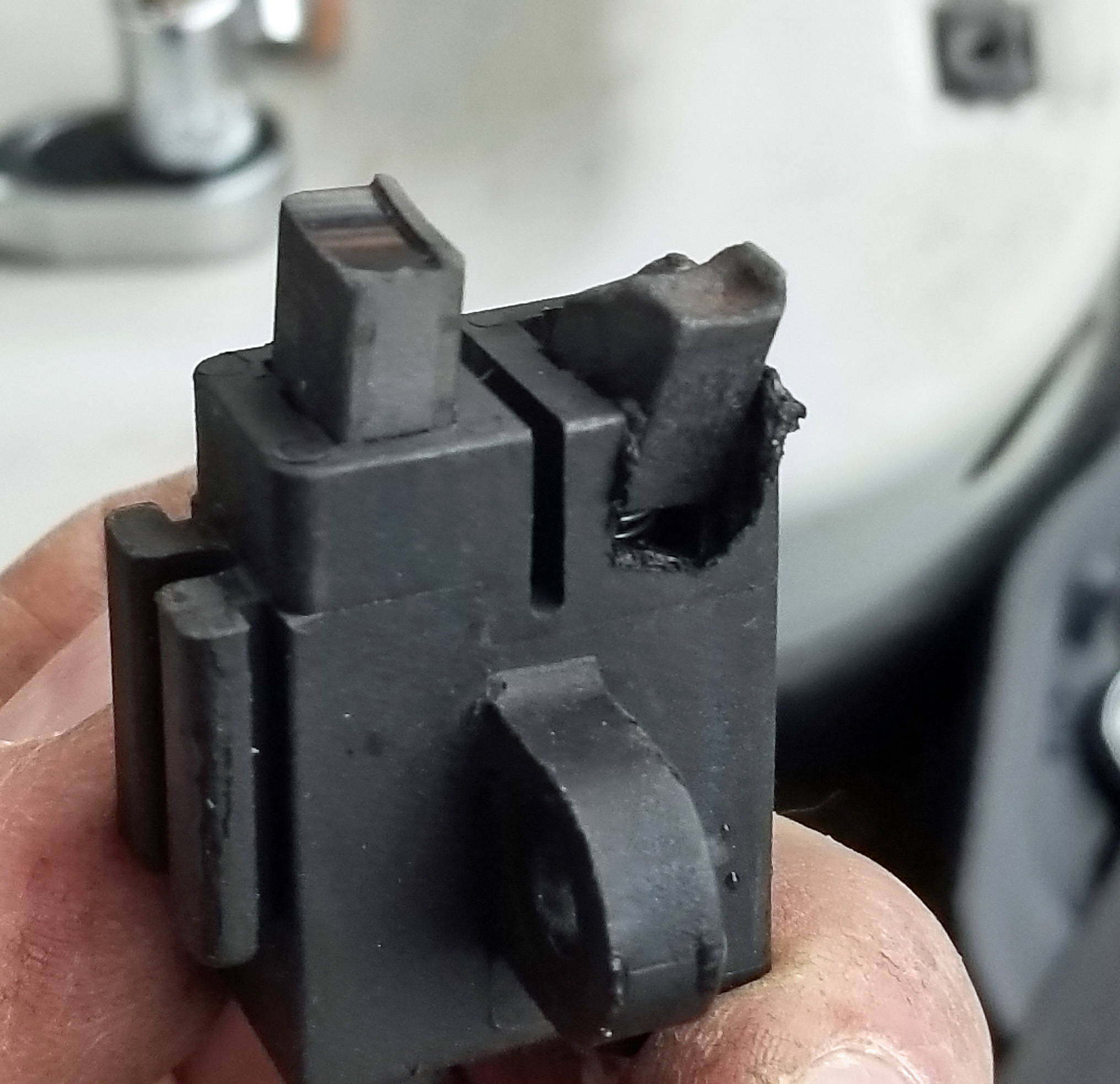

had a customer call me to tell me his generator wasnt sounding right...not starting correctly. im actually surprised it was running at all. take a look at the brushes. 20201030_105750.jpg i truly hate replacing brushes though. and of course it was raining and windy too boot. on the standby units it takes about 90 minutes to disassemble the side of the generator and remove the bearing carrier to access the slip rings. at least it happened now and not when its -10F outside and blowing snow.

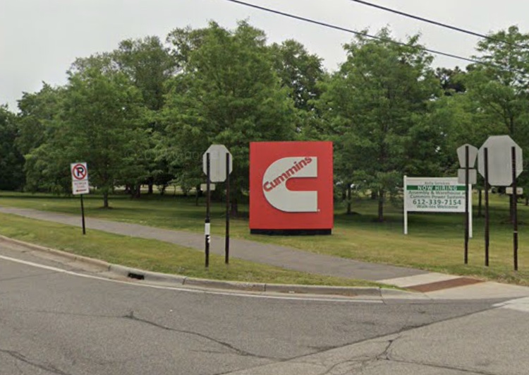

Cummins has been trying for 20 years to get rid of the Onan green. They got rid of the Onan logo for almost everything in the early
2000s but still had “Home of Onan Products” on the sign at the plant for many years. Now that’s gone too:

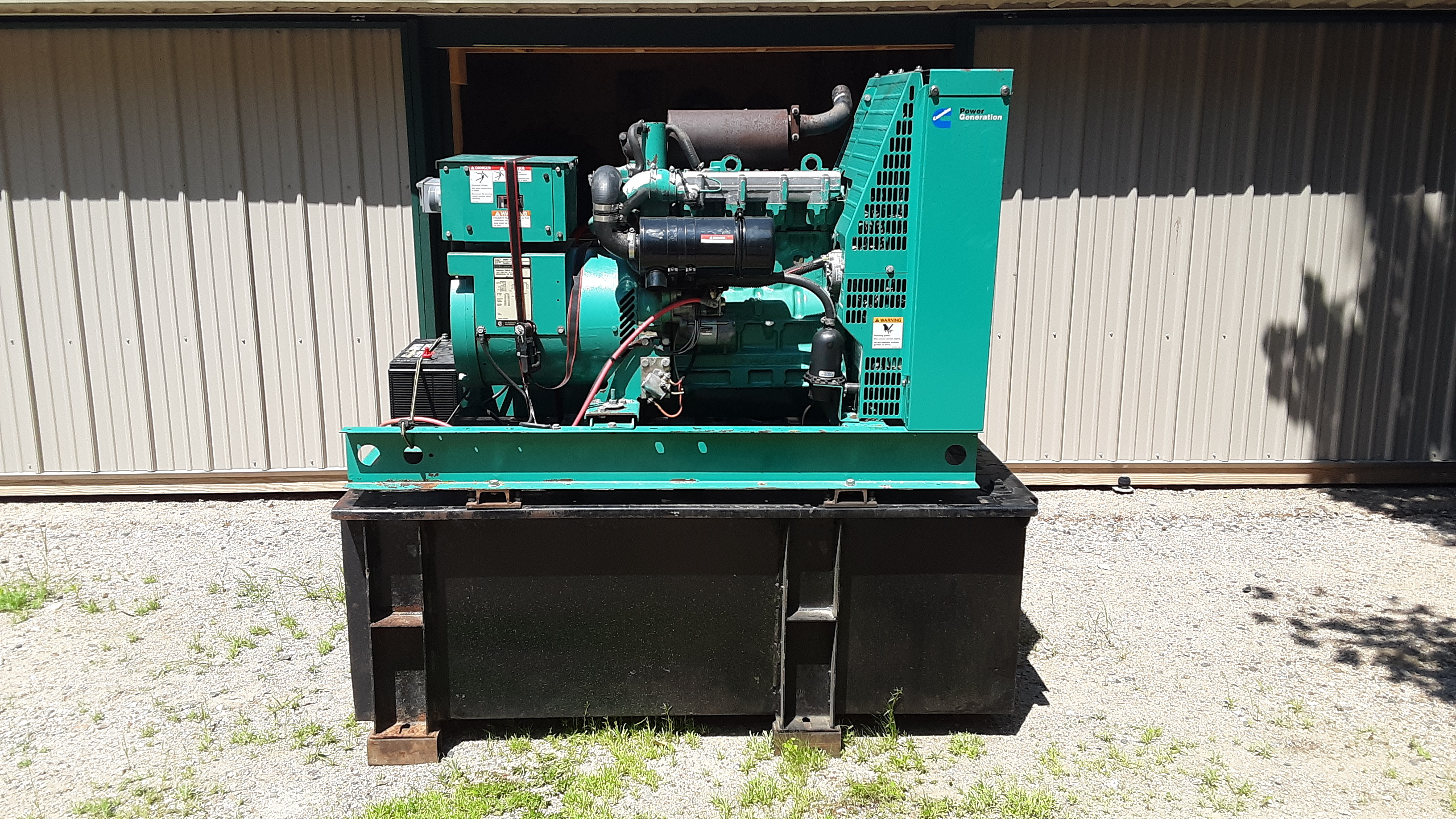

It sure has a motor in it that I don't recognize as a Cummins. It is a small 4cyl that's turbocharged. From my experience that means that they've max'ed out the motor that is used in several models "below" in power. In tractors I like to have the smallest in the series thinking of it possibly having better longevity. I don't imagine that I'll put but 100 hours a year on this one, unless we get another killer 9 day outage ice storm.
   / Your last generator Maintenance Run #4,468
What's the rating?
The 1995 Cummins I maintain have all been real workhorses... unfortunately they are also on the Air District's radar as they are pre tier 4 final.
   / Your last generator Maintenance Run #4,469
Looks like a Lister Petter powered unit from around 2000. We only saw the Nat gas and propane powered ones around here. They were bad for collecting moisture in the oil if they weren’t run at high load levels.
After they stopped making the Cummins A model and Onan DJ model diesels, around here we only saw Kubota from 2cyl 5kw up to 25kw which was the 5cyl. 35kw had the B3.9 until the B3.3 came along and a turbocharged 3.9 eventually went to 60kw.
