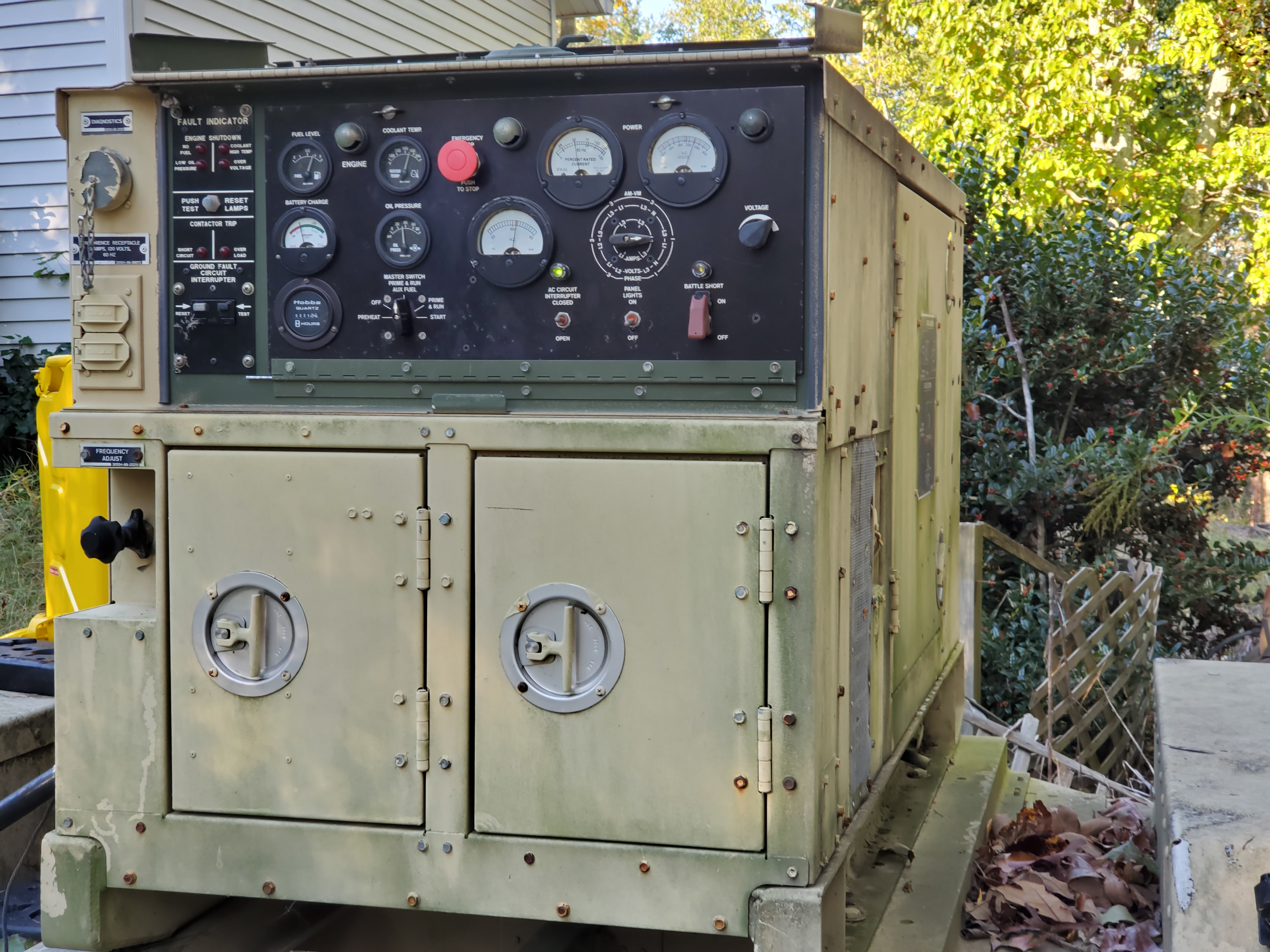

20201031_093705.jpgBeen running 3 days continuous now. Power is estimated to be restored in another 36 hours, we'll see! Good thing I have plenty of diesel in a xfer tank. Zeta knocked out power all across N. GA. I was hunting in the Dakotas when it happened but the wife is an experienced operator by now. It seems I'm always gone when we lose power so I'm glad she's self-sufficient.

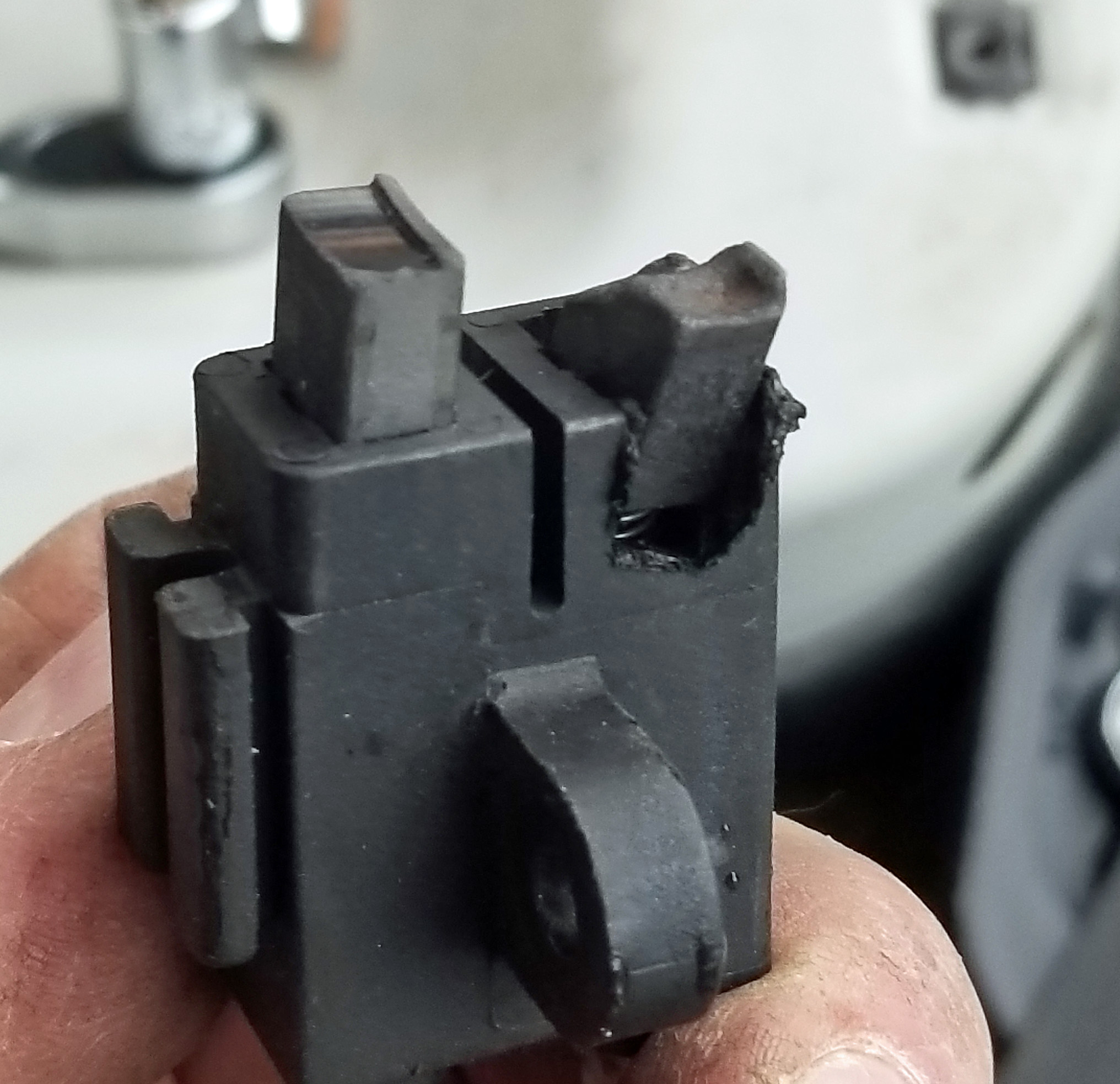

had a customer call me to tell me his generator wasnt sounding right...not starting correctly. im actually surprised it was running at all. take a look at the brushes. View attachment 674968 i truly hate replacing brushes though. and of course it was raining and windy too boot. on the standby units it takes about 90 minutes to disassemble the side of the generator and remove the bearing carrier to access the slip rings. at least it happened now and not when its -10F outside and blowing snow.
What kind of hours would have been on that g ?

View attachment 675027Been running 3 days continuous now. Power is estimated to be restored in another 36 hours, we'll see! Good thing I have plenty of diesel in a xfer tank. Zeta knocked out power all across N. GA. I was hunting in the Dakotas when it happened but the wife is an experienced operator by now. It seems I'm always gone when we lose power so I'm glad she's self-sufficient.
Welcome to the thread..... and a great entrance BTW ! Looks like you'll be keeping the raptors off the electric fence no problem with that !
Tip of the hat to you (and esp. the wife) for staring down Murphy successfully.
Rgds, D.
actually only about 330 hours. You can see by the ridges that it wasny riding properly on the slip rings. The old Nexus series generacs are known for this to happen. Not every one, but enough. Replacing brushes with an added spacer solves the issue. Newer ... after 2013.. dont have this issue.
Rgds, D.
Thanks Dave! I figured if someone was looking at gensets they might appreciate an alternative to the retail options. I'm sure Uncle Sam spent a lot of my tax dollars to buy this one, but I was able to buy it 'again', including trailer, with my after tax dollars for $4k and it only had about 90 hours on it when I got it. Runs a 4 ton heat pump, electric dryer, and well pump simultaneously (along with all the other smaller electrical appliances in the house). Rated at 10kw but it's probably equal to a 18kw+ residential unit, and much more durable with it's 1800 rpm, 4 pole alternator, and emissions exempt. About 1/2 gal of diesel per hour at 50% load.
