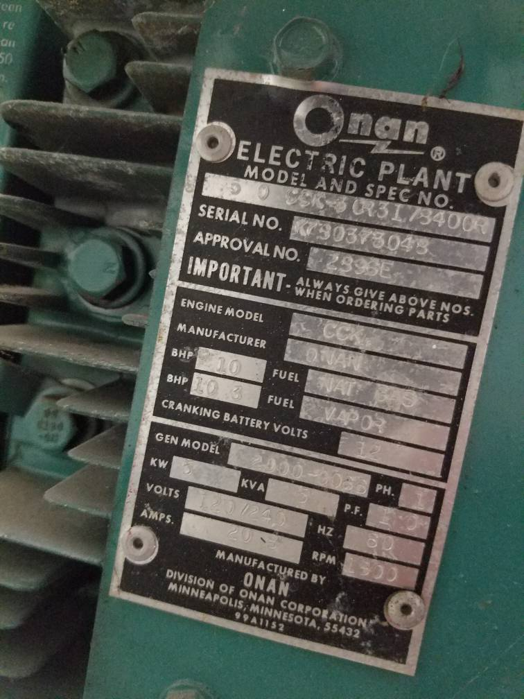

If you don't have a Manual for that gen, post the model # if you can still see it, somebody may come up with a schematic....
Rgds, D.
   / Your last generator Maintenance Run #5,289
Very difficult to read I know... Can't seem to locate my manual at this time. Any help greatly appreciated...
