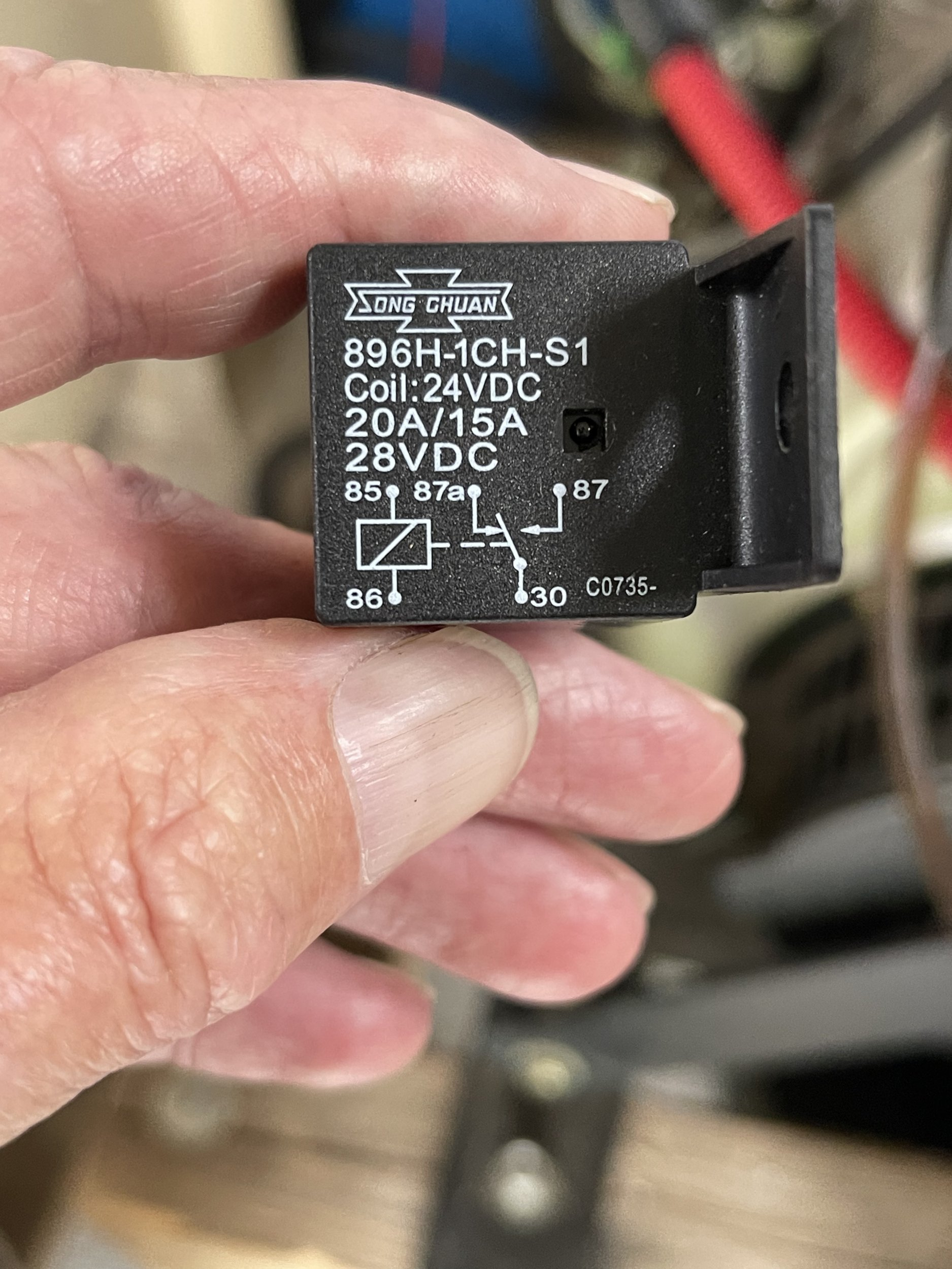

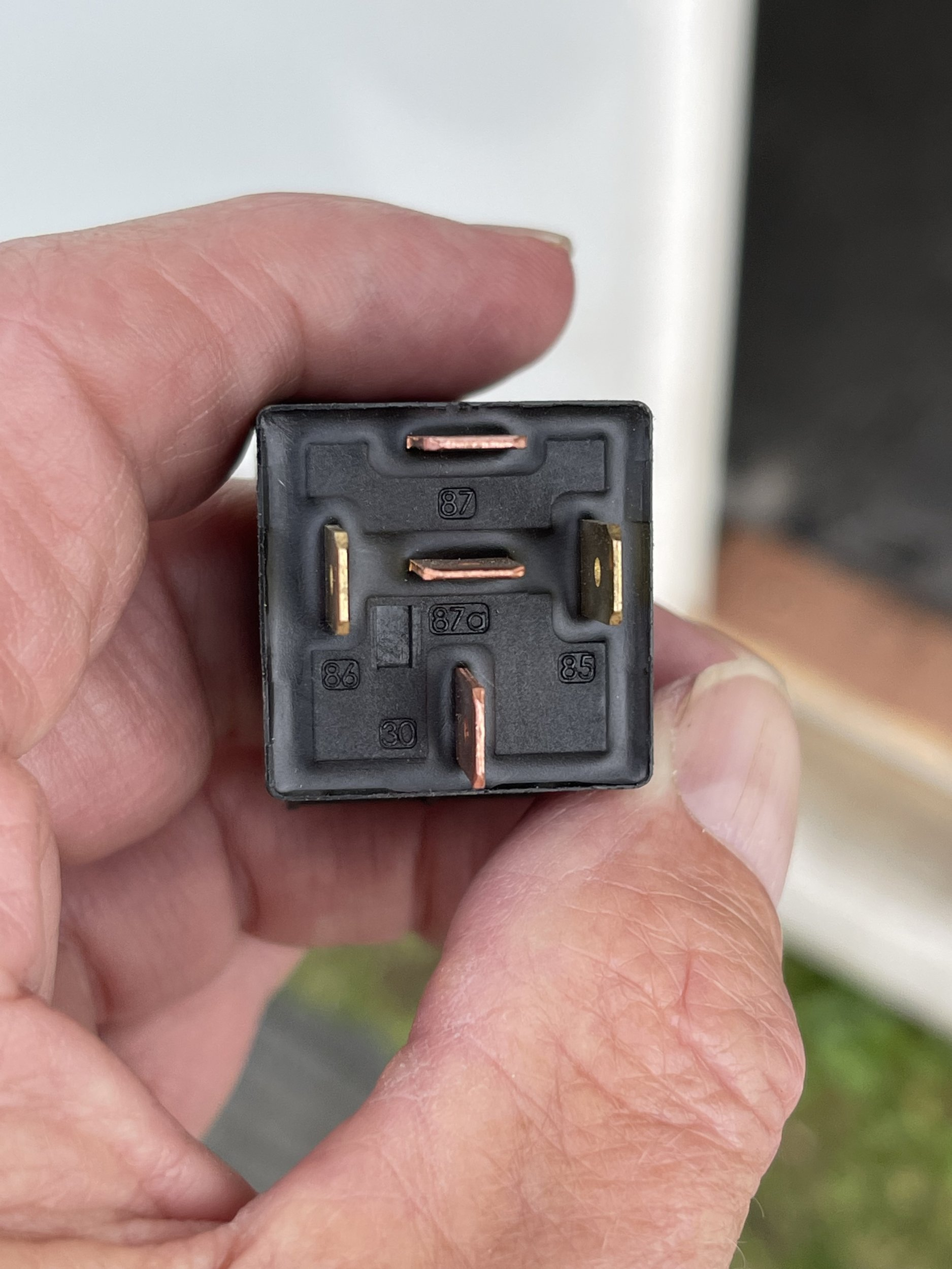

While waiting for a revised wiring schematic I wired in a 12v relay using the oil pressure switch in the circuit, it was not happy kept showing a fault.
So just experimenting I connected the relay as follows
black #86 to ground
White #85 to fuel
Yellow #87 to run sense #12
Blue #30 to fuel
I don’t know why but I works as it should. Started & stopped it several times worked perfect.
I manually started it with the key and the SCP controller detected it was started with the switch.
Thoughts!!

Note; red wire was not used.
90cummins
   / Your last generator Maintenance Run #5,668
although I have no idea how "fuel" is wired, you pretty much bypassed the generator running check. its simply basing the signal on the fuel pump control, not whether the generator is running or not.
your also confusing by saying 12v relay? do you mean 24?

   / Your last generator Maintenance Run #5,670
The fuel solenoid is 12v so I needed to use a 12v relay for the run signal. You are correct the controls do not know if the engine is running that is something we need to pursue fortunately the Yanmar starts like a first gen Cummins 1 turn & it’s running when it’s warm out. The oil pressure switch will be added later.
At least I have a system that works!
