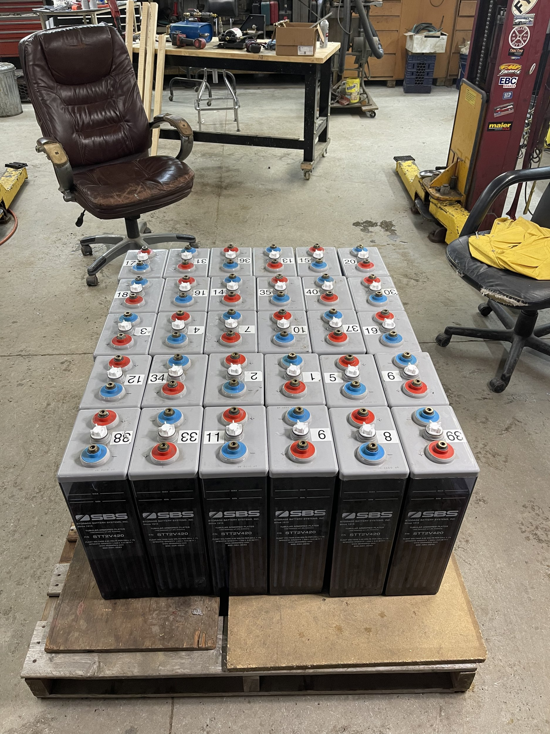

Hope to pick them up this week, unfortunately there are no buss connectors for the batteries.
I have heavy copper buss bars which I can make temporary connections with but I’d like to find the proper connectors, with the current these batteries can supply improvising long term may not be in my best interest.
Not sure if they use a standard buss connection of one of their own design.
90cummins
Do they come with 1/2 of that connection on them ?
If so, post up a pic, somebody may be familiar with them.....

Here the are not sure how many I’ll keep. They just have posts.
According to code on top they were made in 2009.

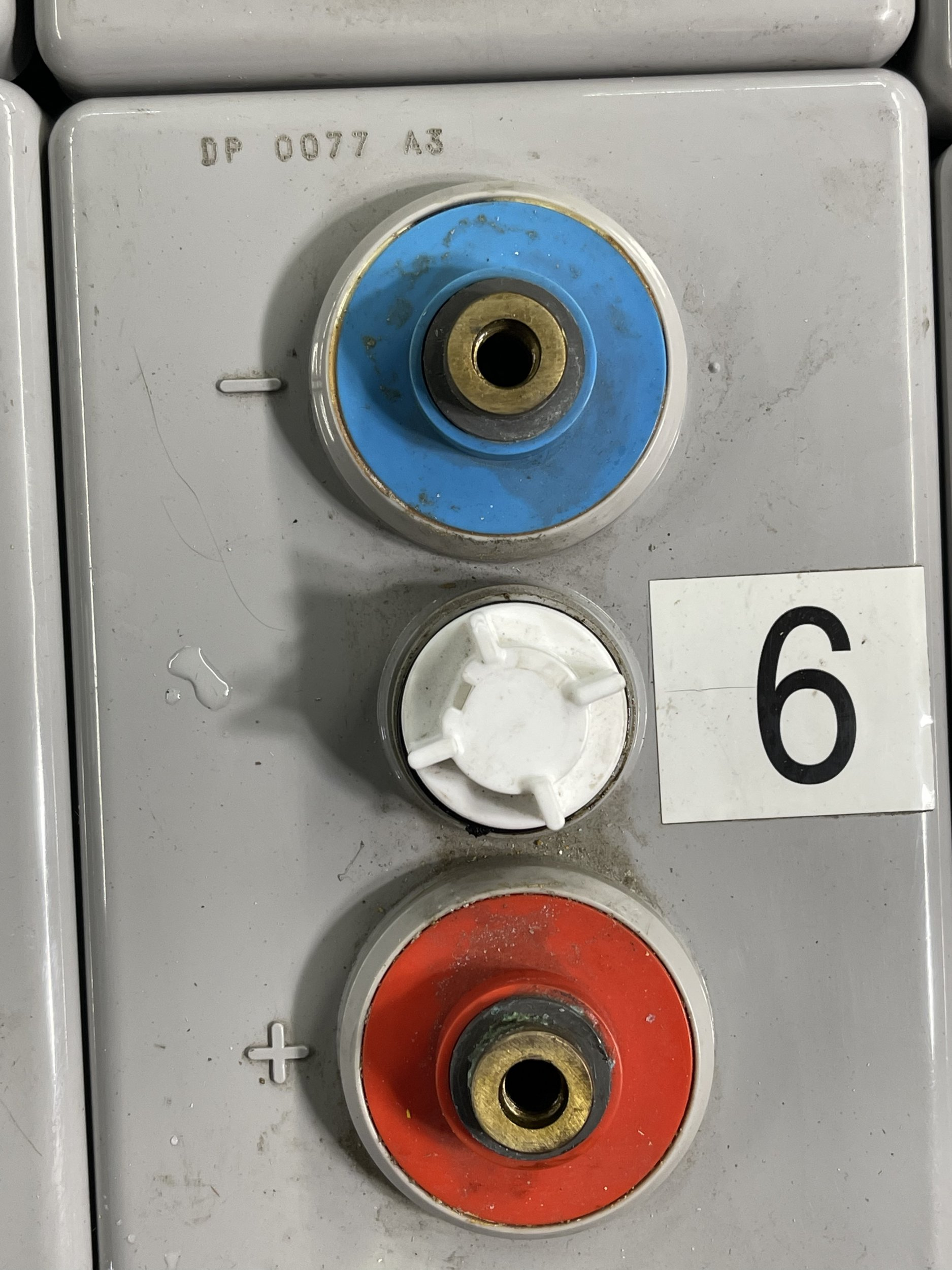

Can't quite tell - do those posts have internal threads 90 ?

Living in the shaky isles (Seeing the ground rolling like the ocean is quite something) I like to use flexible conductor jumpers with crimped and heat shrunk lugs. This allows for more ground rock n roll without damage. Lug in direct contact with the post, flat and a spring washer on top. From what I read in the data sheet the posts are M10 internal thread.

In a past-life, i spent a lot of time reading datasheets.... you'd think I could have read that one that was up here :).
Couldn't quite tell (old eyes I'll blame) from the pics, but internal threads was the only thing that made sense.....
