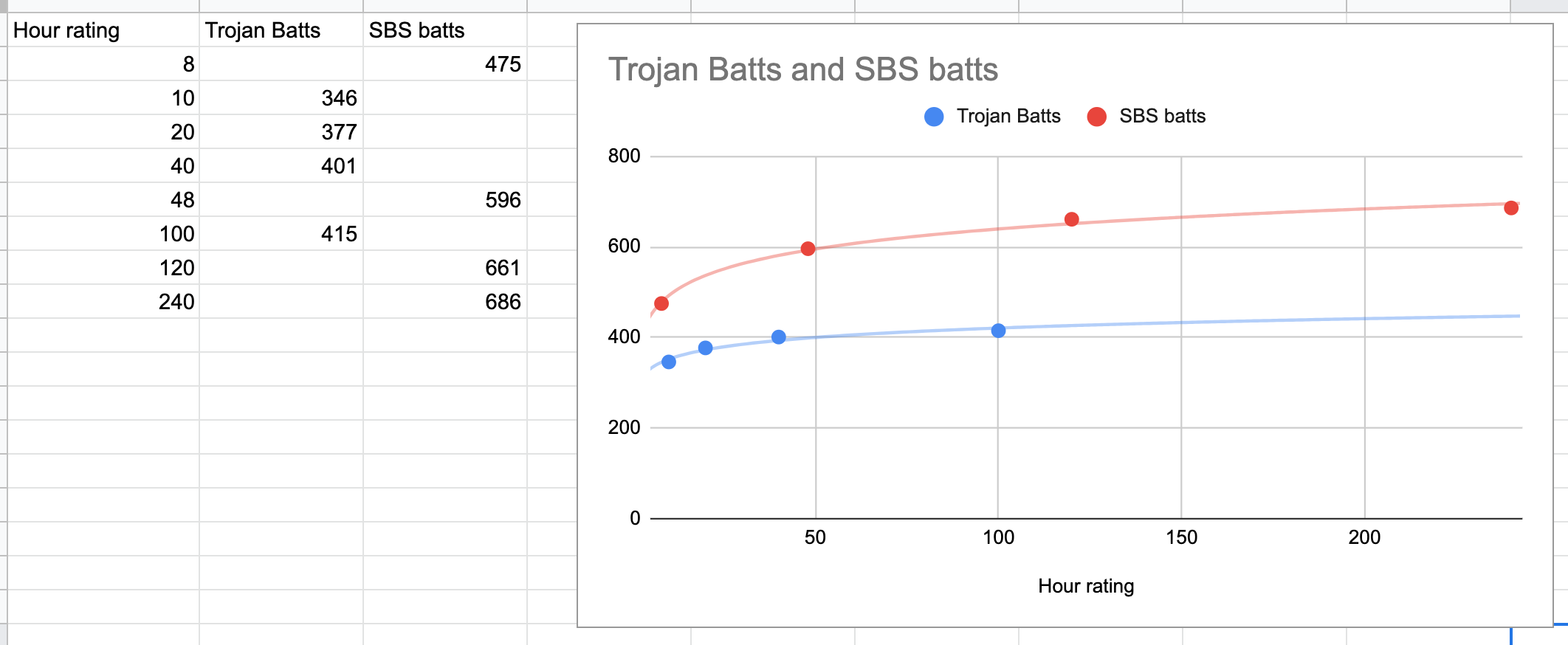

Help needed comparing battery capacity.
I’m planning to replace my Trojan L16’s with industrial SBS STT2V420 two volt batteries.
The SBS batteries have the following AH ratings.
8 hr rating of 475 AH’s.
48 hr rating of 596 AH’s.
120 hr rating of 661 AH’s.
240 hr rating of 686 AH’s.
Trojan renamed the L16’s and are now SPRE 06 415 with the following ratings.
10 hr rating of 346 AH’s
20 hr rating of 377 AH ‘s
40 hr rate of 401 AH’s
100 hr rate of 415 AH ‘s
I attempted to use Trojans on line battery sizing guide to compare performance but I’m having trouble making sense of it because they use different hour ratings.
Looking at the numbers it’s apparent the SBS batteries crush the Trojans in performance but how much better are they?
Can someone tell me how L16’s in a 24 volt system would compare to 12 of the above mentioned 2v batteries assuming both were new.
I would like a comparison of them with a 24 hour average load of 300 to 600 watts.
Thanks
90cummins

The discharge curves look pretty similar to me, looks as though you can just compare amp hours to amp hours there. That is 600Ah of Trojan is going to perform more or less the same as 600Ah of SBS.
Peukert's law is pretty universal across all lead chemistries: Peukert's law - Wikipedia

The charge characteristics of tubular positive plates with the lead selenium - antimony alloy in the SST2V420 battery leads to a battery that needs to be fully charge to 100% SOC (state of charge) and placed in float and mantained in float after each discharge cycle or battery life will be shortened.
The Trojan only needs to be brought minimum 70% SOC threshhold to not shorten the battery life. So is much better suited to partial state of charge in my opinion.
SST2V has a 30% of the Ah capacity as a max. charge rate.
The trojan has a 13% of the Ah capacity as a max charge rate.
I am not as well versed on the subject as @Patrick Herd, but I did have experience maintaining Industrial traction batteries during my carreer.
See attached doc's with added notes.
Dean
Edit: With the attached documents you can compare the 20 hour discharge rate given for both batteries. Hope this helps.
