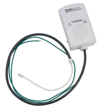

Still need to figure a way to alert me when power back on rather than spying on the neighbors. Easier to do in the dark but daylight hours aren't as easy. Hey I know... A good use for my drone with camera on board, except it can't overpower this much wind. Oh well.
I had the same problem during daylight hours. I installed a Reliance Electric Power Back alarm. It runs from a 9V battery and has a lead which senses the presence of power and then sounds an alarm that sounds like a smoke detector. It works like a champ!
You can get the alarm from a variety of on-line vendors, including Home Depot.
While I do like Industrial's roll-your-own approach, this looks like a consumer friendly setup, that should be relatively low cost.
If you've been running one for a while J, is the battery life good ?
Rgds, D.
Rgds, D.
The same battery has been in the unit since it was first installed a few years ago and it still works fine... note to self: I really should proactively install a new battery.
   / Your last generator Maintenance Run #616
Low cost is right - $35
